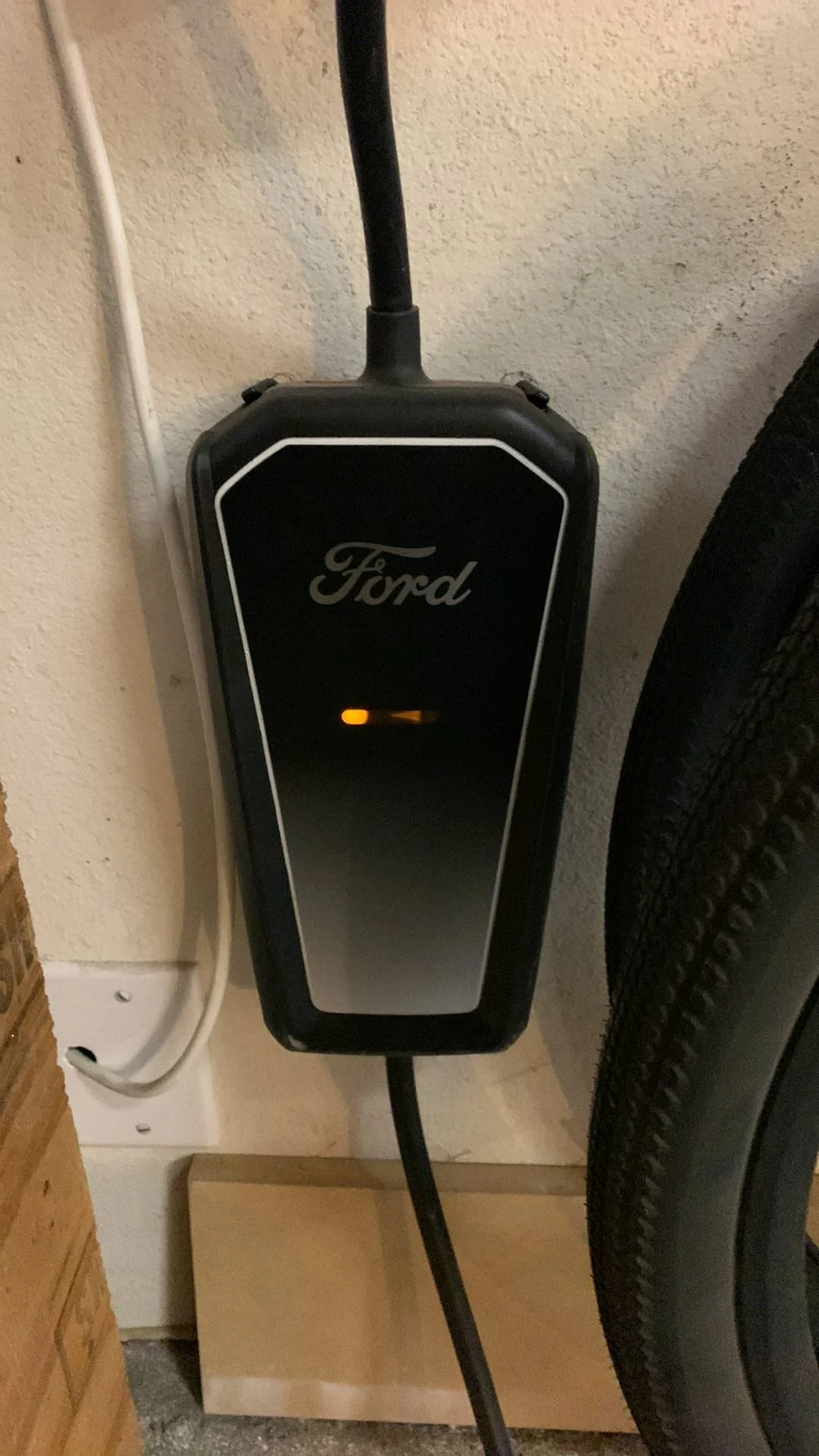

I charge at home plugged into a 240V plug. In recent weeks, the charge says its 90% ( where I set it) but the GOS says 160ish miles but sometimes as low as 135 which is very low. The dealership said they charged it to 200+ at 100%. Now, it wont charge at all at home. I noticed the light on the Charging Cable box is yellow and broken. I think the Charging Cable Box has failed. I'm going to the dealership today to see what they say. Less than a year's use doesn't sound very good. Any comments?

This has happened a couple of times with me. I just turn off the circuit and turn it back on and this corrects the problem with the charger - it turns from yellow back to blue and works fine. Good luck!

GOM is irrelevant and has nothing to do with the charger, and everything to do with colder temps when they exist.
Unplug from the wall.
Disconnect the two parts of the cord, replug it in, and make sure you hear it click.
Try again.

Thanks. Unplugging and replugging worked.
