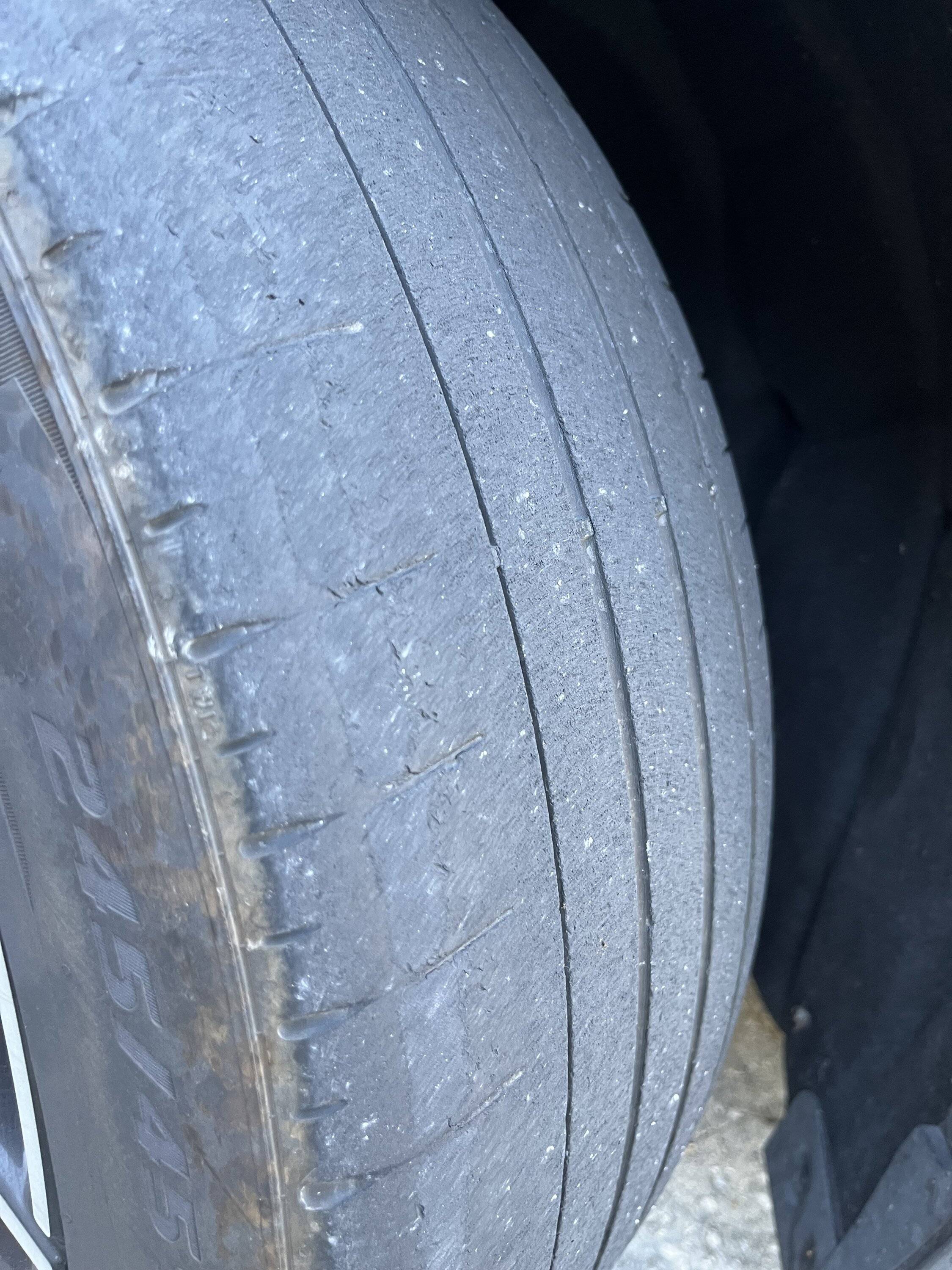

EV tires definitely wear out faster.
Here are my GTPE tires at 9,000 miles. I rotated and did an alignment at 6k (alignment was fine unfortunately as I was hoping that was the issue).
Ford Mustang Mach-E Jump starting sales IMG_9746
I usually get 16,000 miles out of summer performance tires in my cars (all city). This is by far the worst tire wear I’ve ever seen.
Hell, I got 9,000 miles out of my nitro drag radials on my modified 2002 Trans Am!

The curved patterns would seem to indicate you have a lot of scrubbing wear (turning the wheel while the vehicle is stopped). Try to roll slowly as you're turning the wheel to reduce wear.

I have a literal 1 mile commute to work. Half my time is spent in a parking lot.
I’m betting a lot of that is from either the parking lot or backing out of my garage then going out of my driveway.
