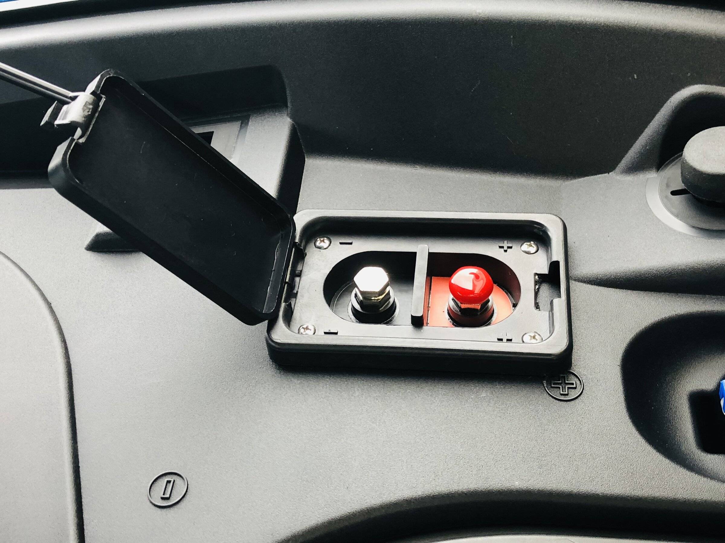

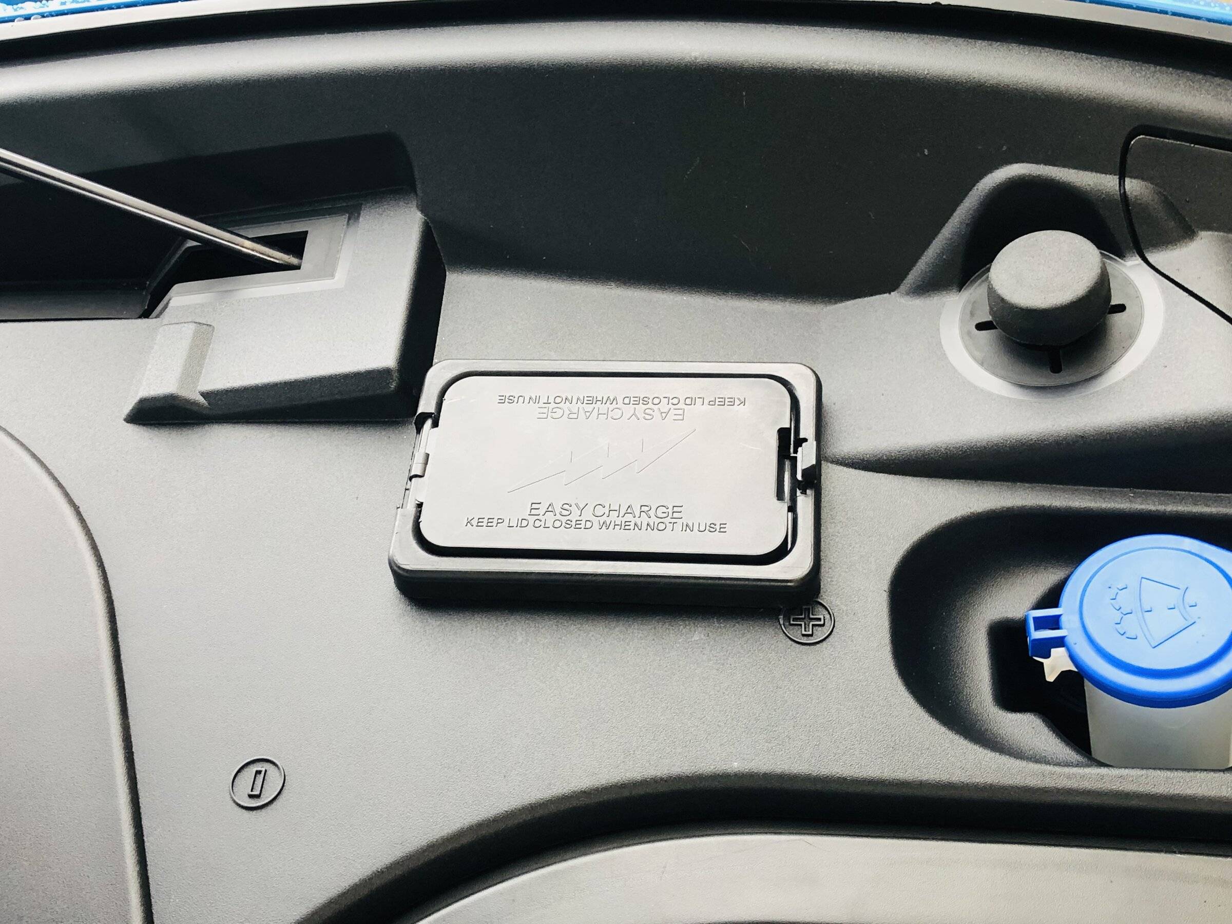

I have never had a car or truck that didn’t need to be jump started at some point! Should have come from the factory with those holes already in place!
88
12,927
17,370
My Wife just said, “ You’re NOT drilling any holes in my car!!! “ lol
Holes needed to be drilled, but looks almost like the factory intended this. ??
Is this something you installed? Or did you have it done somewhere?
