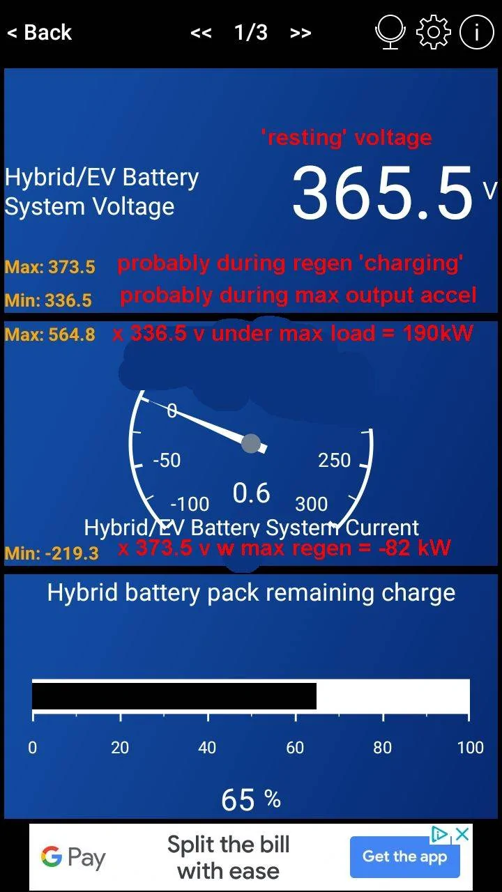

I'm curious about the output you saw from CarScanner. Did it confirm that OPD offers the same level of regeneration as L or more regeneration than L? I ask because the statement that OPD overrides L is correct in either case.
I only tested while in 1-p unbridled.... L didn't give any additional regen. The carScanner app can capture max current, and voltages, but doesn't do the math on the streaming data for actual kW.
this is what I was able to configure and capture:
Ford Mustang Mach-E L button on shifter CS use 04 showing max kW
