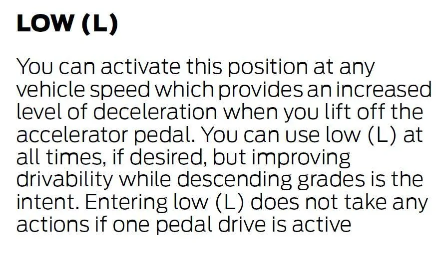

Not sure that is so. I think they are repurposing an existing part to do something other EVs accomplish using paddles or twist stalks or buttons.
The L button toggles in and out of a mid-level of regeneration. Less than is applied in 1PD (that varies in the regen applied based on Drive Mode) but more than the base level of regen when 1PD is not active (which also varies with drive mode).
Yes, it increases lift-off regen, and Ford says you can use it all the time if you want. So you aren't doing anything wrong if you choose to do that, but its intended use is for going down long hills. Just don't expect your brake lights to illuminate if L is the only thing you're using to slow down.
