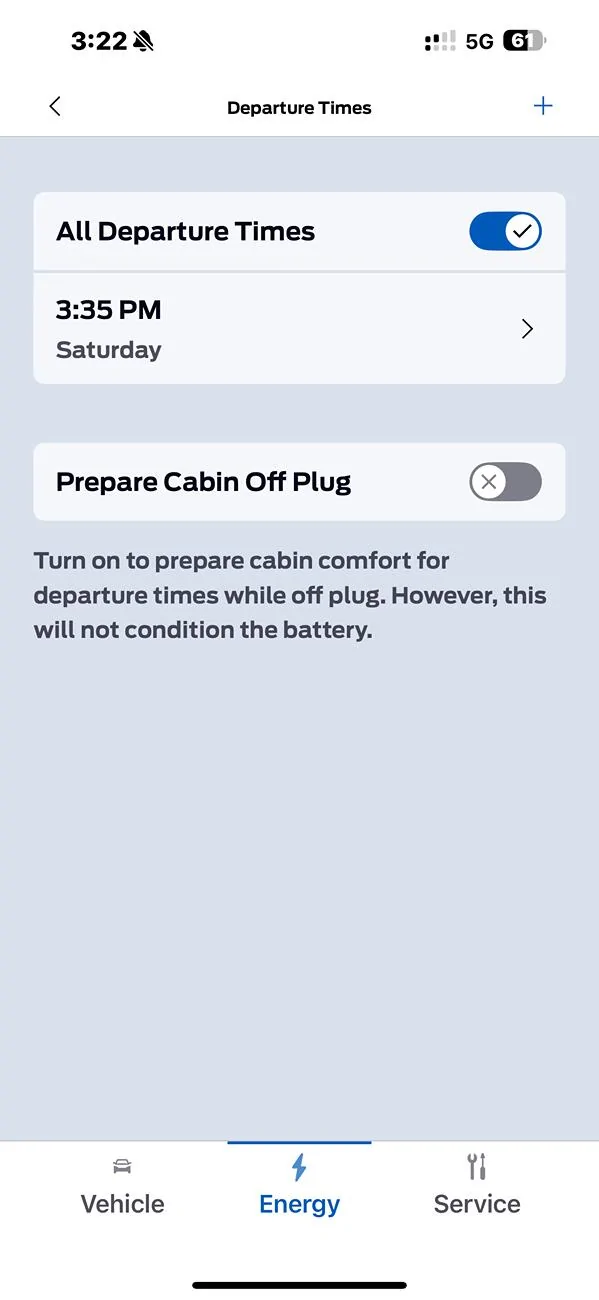

I’ve searched and unable to find exactly what I am looking for.
I have access to a level 2 for a few days and want to make sure I’m preconditioning correctly.
Ford App > energy > schedule departure time > all departure times > ready by > date and cabin comfort?
Reason I’m asking I’m at a hotel offering L2 but outside and having chilly AM.
Cabin comfort? Off?
Thank you!

When you set a Departure Time the car warms the battery, and optionally the cabin, to prepare it for driving. If its cold, its best to warm the cabin to preserve your range, otherwise you will consume battery power to get the cabin up to temperature. I wouldn't consider this "pre-conditioning". Pre-conditioning the battery gets the battery to optimal temperature for DC fast charging. To pre-condition you use the car's navigation system to go to a fast charging station. The car will then get the battery ready for your arrival at the charging station.

You mean I’ve had it all wrong all this time? I thought that was also precondition the battery in the AMs. Okay so just warming up the car to avoid less battery usage

Departure time preconditions the battery for driving. Whether this is useful or not depends on a variety of things. I'm not an expert on this but from what I've gathered it's good to do if temperatures are low (below 40ish) and you're driving more than about 20mi. More important the colder it is. Less than that and you might be spending more electricity warming the battery than you gain through efficiency.
Also helpful to warm the cabin on wall power so you don't burn through battery charge initially warming it up.
If you're not paying for electricity, definitely do it. If you're paying for electricity and it's not crazy cold and you're just driving a few miles, just warm the cabin. Longer trip? Precondition.

I get it now. Yea the hotel I’m at has free level 2. So I’ll warm up on their dime! Thank you!!
