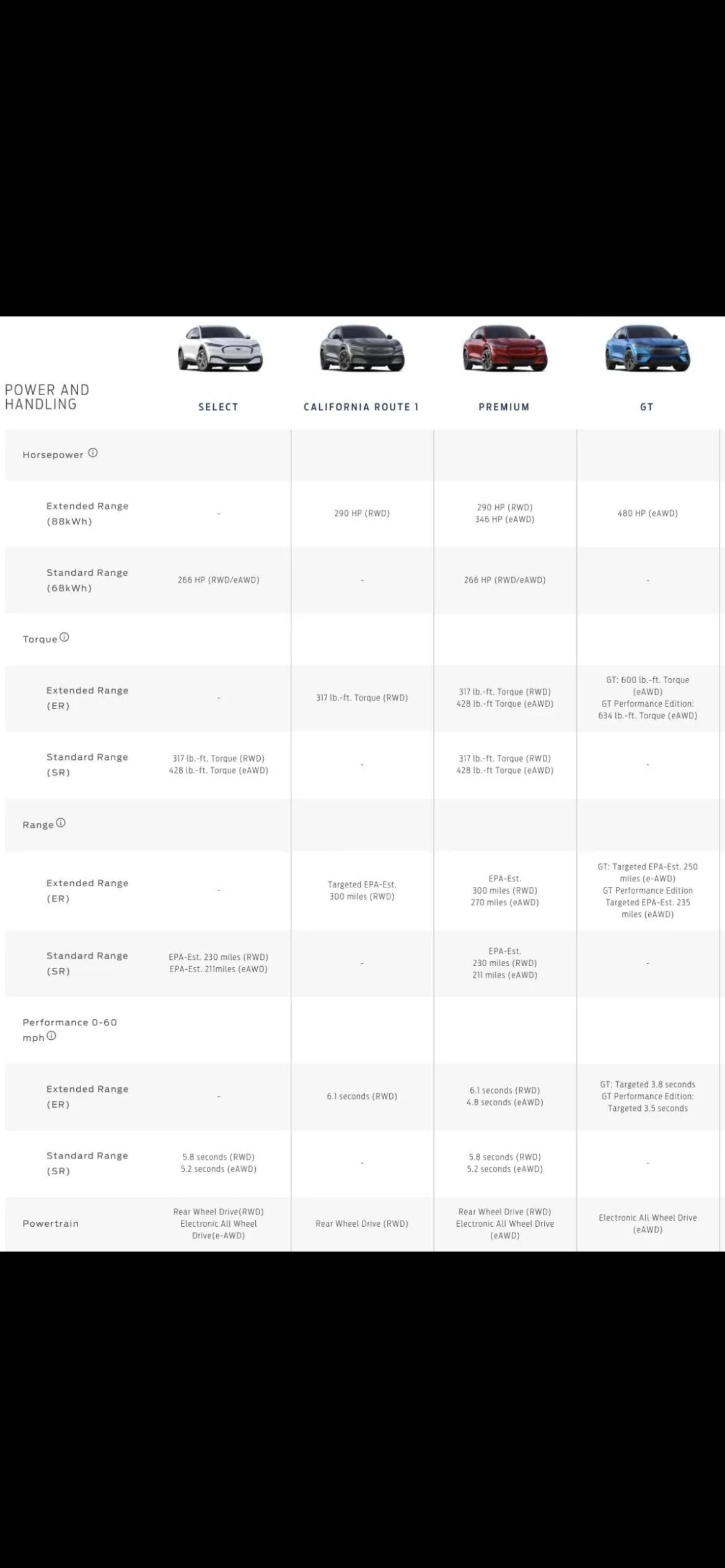

Does the ER battery give you more acceleration?
Yes.
You get more horsepower and better acceleration.
Standard range 266 hp rwd
Standard range 266 hp AWD (but more tq)
Ext range 290 hp rwd
Ext range 346 hp AWD
Also the new standard range battery is heavier and slower than the old one.
Here is an old chart because it’s confusing-

AWD gives you more acceleration. But if you couple AWD with standard pack, you're gonna have the shortest range of any configuration.
SR AWD is slower than ER AWD and has less horsepower. See above.
