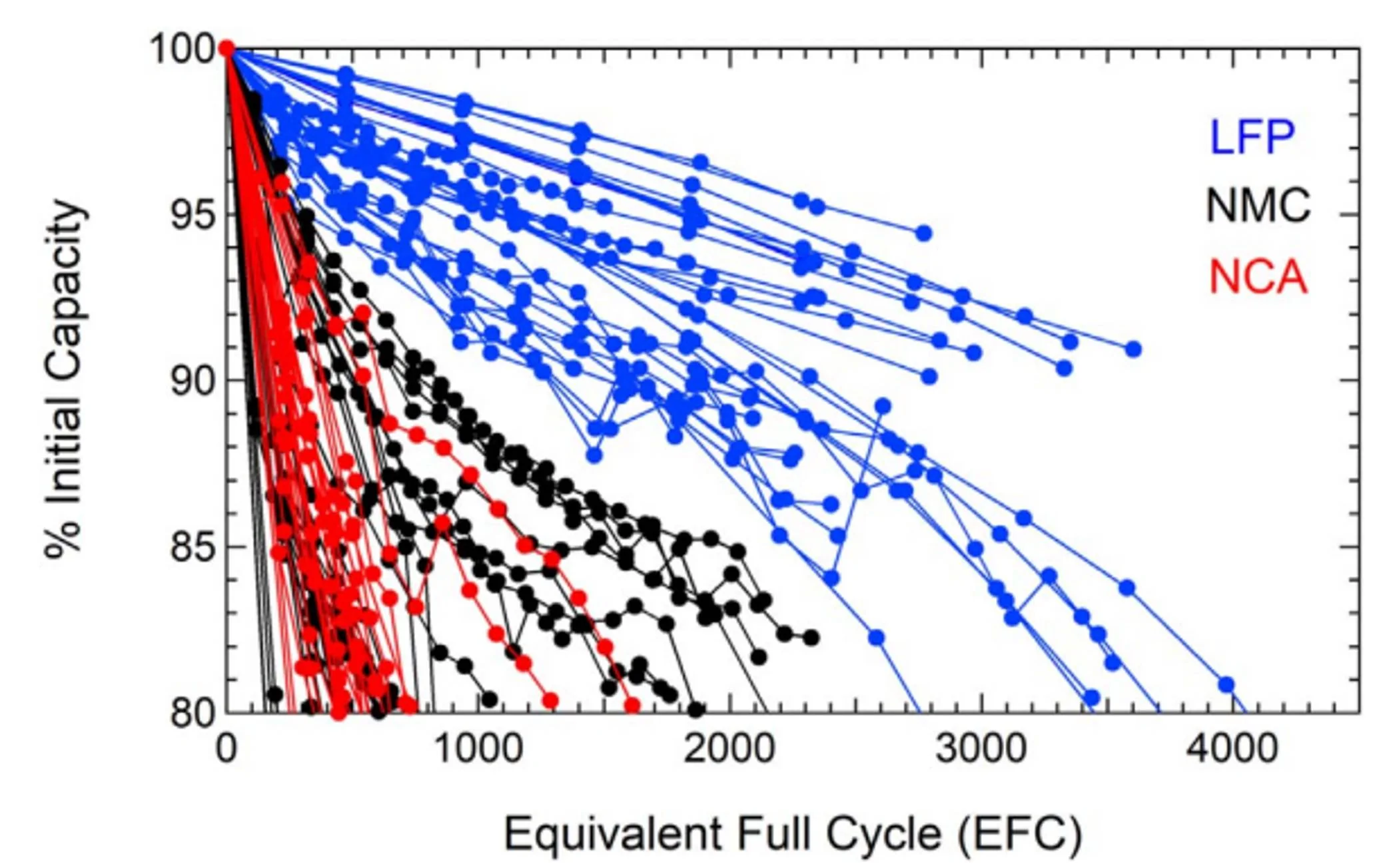

I mean 1000 EFC gets you your range times 1000 in total miles, so it doesn't seem like much to be concerned about before you're at 80% initial capacity.

I was referring to the conversation about battery degradation. The chart showed that NMC batteries might expect 1000 EFC (equivalent full charges, so 2000 charged from 30-80% or 10,000 charges from 80-90% for example). 1000 EFCs is 1000 times your range, which is quite a lot of miles for a car to last. If your real world range averages 250 miles, then you can expect around 250,000 miles of life before your battery only has 80% of its initial capacity available.
Edit: The chart you commented on is not a charge curve.
Not only that, if that’s the test that’s been floating around for a while, they fully charge and discharge from 0% to 100% and repeat. It’s also not a full size temperature controlled Bev battery, it’s a small battery they’re testing.
Nobody drives their car like that, and even if you did, you’re talking a 20% loss in 300,000 miles.
Not why you would buy a battery that starts with 20% less range in the hopes that the gap would shrink to 15% less in 300,000 miles.
Yeah, it'll vary depending on how gentle someone is with their battery, but for folks that are careful the degradation will be negligible until they're getting upward of 100k miles. At that point, you've got a median of maybe 20 miles of range loss in NCM, while the LFP might only be 5 miles of range loss. So, a 45 mile difference in range rather than 60 when new.

2) They are rated for a cycle life of 4000 cycles while retaining 80% of their original capacity, and this is rated with 100% charging. It can last much much longer if you dont charge to 100%. This is DOUBLE the cycle life of NMC chemistry which is rated for approximately 2000 cycles while charging to 80%.

Is #2 actually a benefit that will benefit anyone?
Its starting EPA range is 250 miles.
4000 cycles is 1 million miles.
So after 1 million miles the range will be 200 miles.
Compare to an ER vehicle-
312 miles starting range
2000 cycles 624,000 miles
After 624k miles range will be 250 miles….
Still more range than a SR vehicle would have even after 624,000 miles. And like you said this is more worst case if you always charge to 100%.
So I don’t think this will have any real world benefit to anyone.
