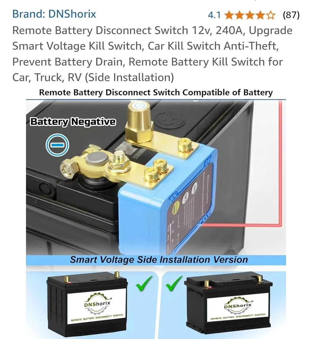

I posted this in another thread, but I will as k here as well. Is there an easy way to pit in a 12v disconnect to reset the car without disassembling the frunk.
There's a couple of members who have mentioned installing wireless battery disconnect switch.
I'm considering one myself, but am looking for the most robust example that I can find.
Similar to this:
Ford Mustang Mach-E Liftgate not opening Screenshot_20241229_233132_Amazon Shopping
