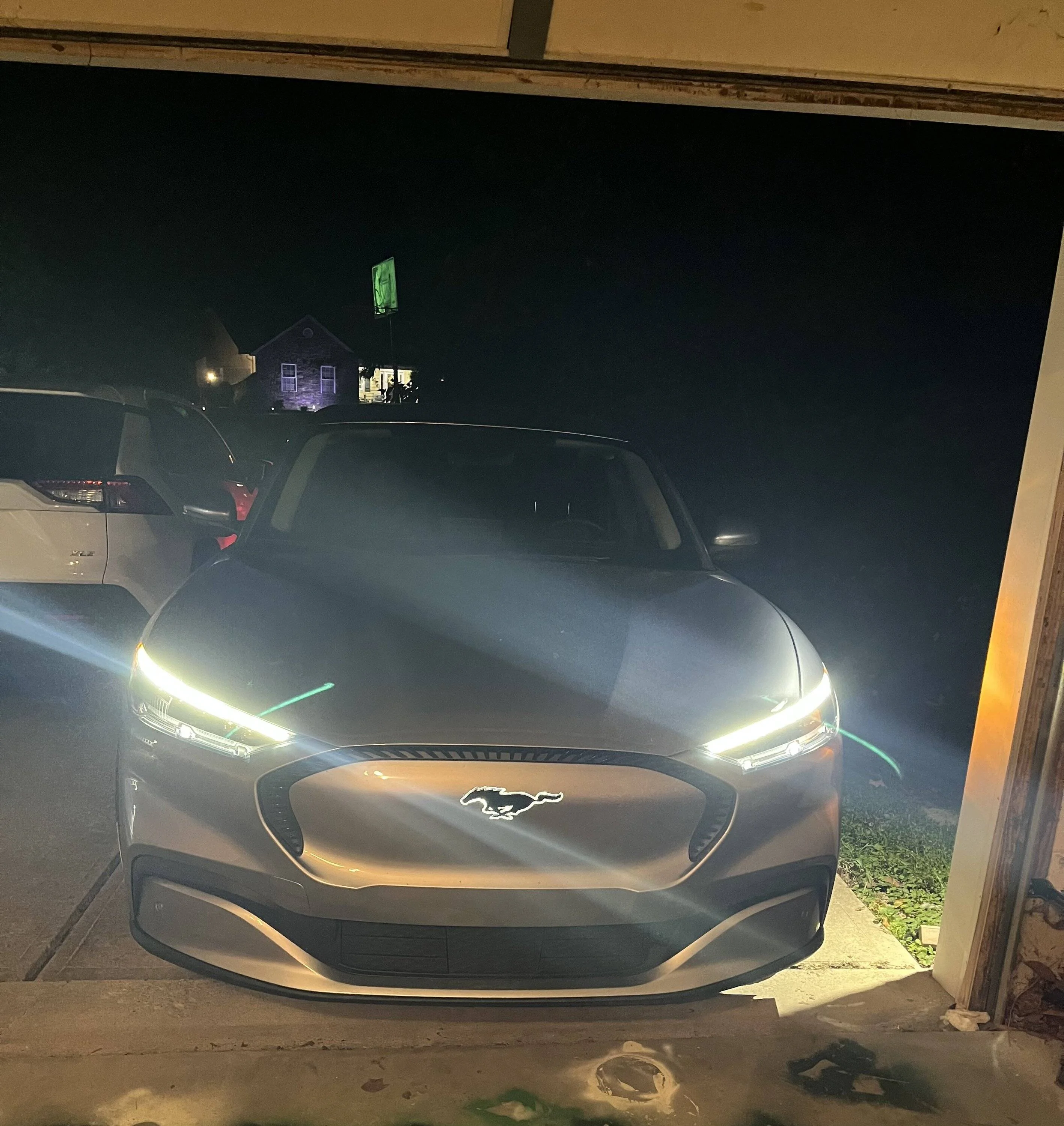

My 12 year old boy and me put this on tonight. It might have taken closer to 2 hours but I took my time.
That really does look incredible! For vanity reasons I probably would have taken an option to get a lighted logo; avoided the GT model because I didn't need the added performance, wanted a light-colored interior, and didn't like the black front fascia (a month into ownership and I still do double-takes on the front of my car because it looks amazing as all one color).
I'm intimidated by the prospect of the install but I'll be watching this project.
