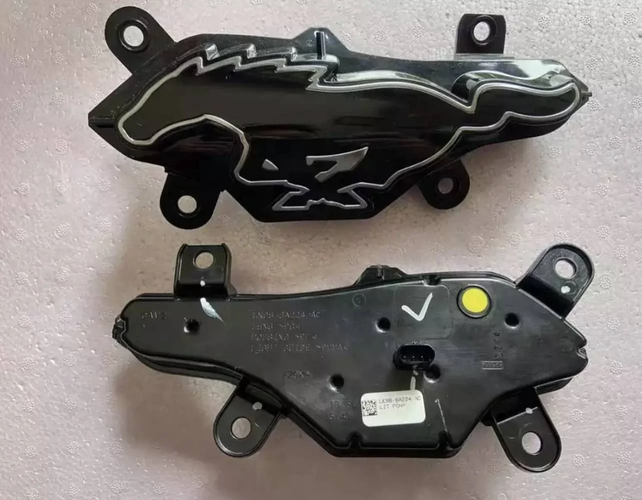

Good morning everyone!
A few weeks ago I ordered the front and rear lighted pony from AliExpress to test them against Johns' offerings. I have a few updates to the current situation.
1. I was pretty disappointed in the light dispersion with the kickstarter product. I don't want to rehash all that but I did want to try a little something to see if I could help spread the light output across the pony a little better. I basically taped off the front, top, side edge and the mounting posts of the pony and found a matte clear finish spray paint to "frost" the edges you cannot see from the front of the pony. The result is, much better. The matte spray on the back edge seems to diffuse the light output just enough where it's harder to see the individual LED hotspots. The top of my pony still has significantly less light output than the bottom, but you don't get the "litebrite" effect from the front of the mustang.
2. I haven't gotten to install the rear light up pony from China because apparently, the freight forwarder decided to open the package and take the pony itself. I got the harness for the pony, just no pony. Efforting that now.
3. I can confirm that the front light up Pony for sale on AliExpress does NOT exist. What they send you is a harness that ties into the vehicle wiring to light up an emblem that cannot light up. It looks like the MME in China has a completely different front emblem that maybe lights up or perhaps can have lights shoved into them. Such an absolute goat rodeo. Bottom line, do not buy the front logo because it doesn't exist but you will get a useless wiring harness.
China emblem.
Ford Mustang Mach-E Lighted Pony Project (back it!) IMG_6123
I hope all that makes sense, it you have any questions, hit me up.
