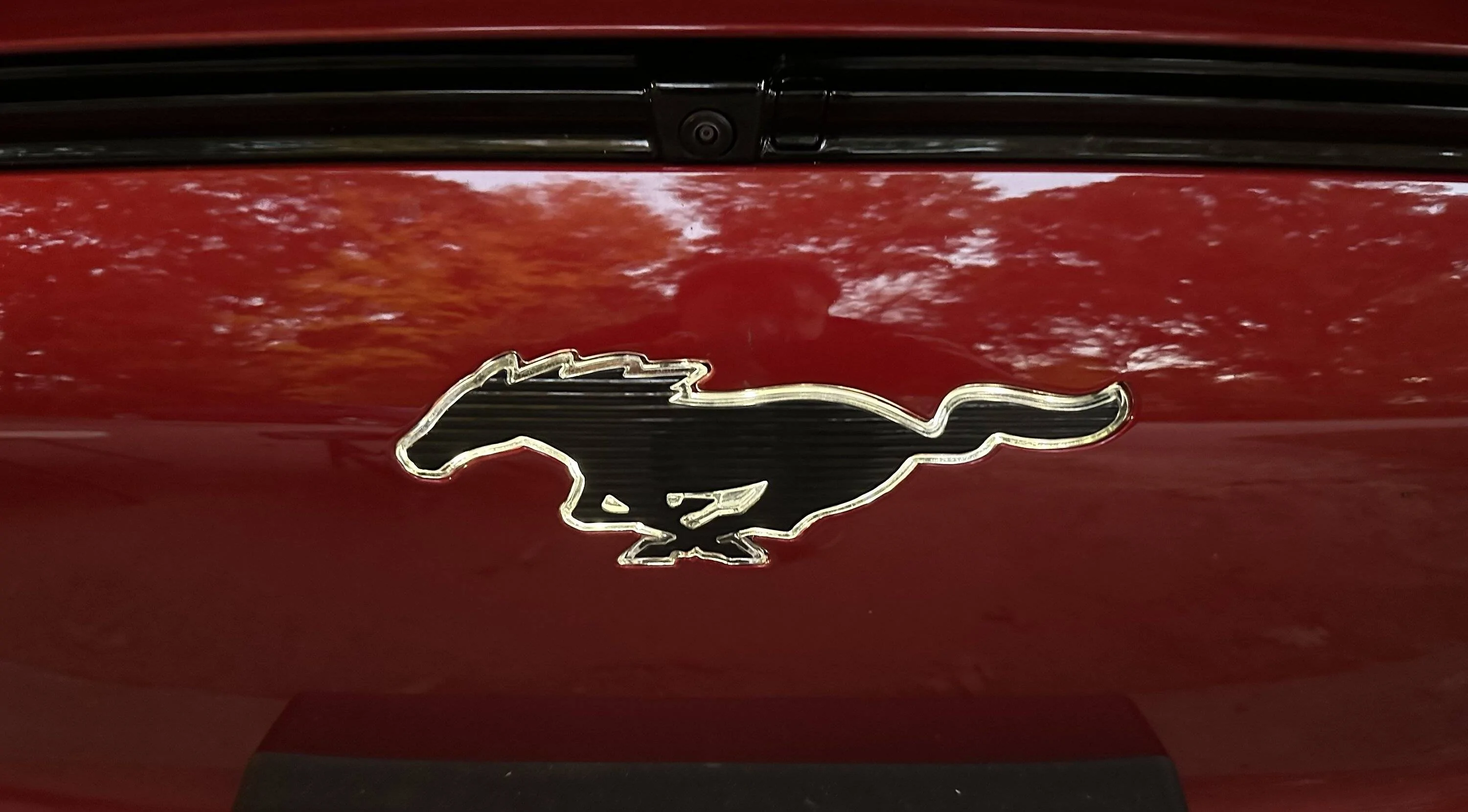

Though now I see @AOSK has a lighted rear pony available for pre-order in their Black Friday sale post. I like all the other stuff I've ordered from AOSK, so maybe this is a good option.
https://ev-vida.store/products/mustang-mach-e-rear-pony-emblem-brake-led
Not sure if this is the same as the one John is developing, or something different. The installation video shows the lighted rear pony is smooth, without the horizontal stripes on the original pony. But the pictures in the ad show the lighted rear pony has the vertical stripes. So, unclear.
That last sentence should have been ... the lighted rear pony has the horizontal stripes. Derp.
The description for V2 says “aka John Kennedy’s version” while this is V1 without the walk up animation.
OK. Thanks. I didn't see there were two versions.
this light up rear pony is EV-Vida's product. its actually not ours. EV-Vida is our official selling partner.
but this product is legit.
