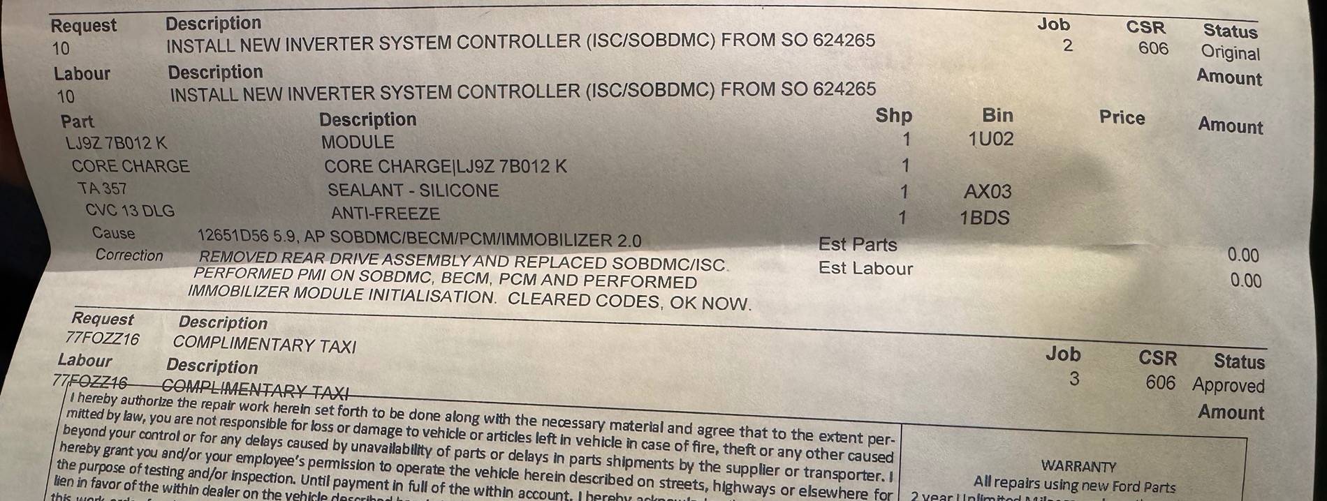

Ford is replacing my car inverter for that exact same issue. I’m not sure if it’s the caused but that’s what I’m being communicated with.
The replacement is taking a day and and I will update once I have my car back.
Well that's interesting since in my case and others I've seen there are zero DTCs in the system on cars this is happening to. Nothing in the system to indicate anything has happened at all. Meaning even the car doesn't even think anything's wrong when it does this. So I'm wondering how they arrived at that conclusion without any DTCs to diagnose and pinpoint one of the inverters (front or rear?).
I have had some indications from at least one person on this forum (you know who you are) that this phenomenon is well known, and the cause is understood. So why this is still happening after at least two years (that I'm aware of) is unclear.
This is what on my service order. I’m not sure how they came to that conclusion but I know they had to get special authorization from Ford because it’s an expensive item. I just got my car back for a few days and the issue haven’t come back…yet. I will keep an eye out.
Well good...I'm hopeful that this is the correction. There's a lot of folks who (as you have read here) are experiencing this issue.
