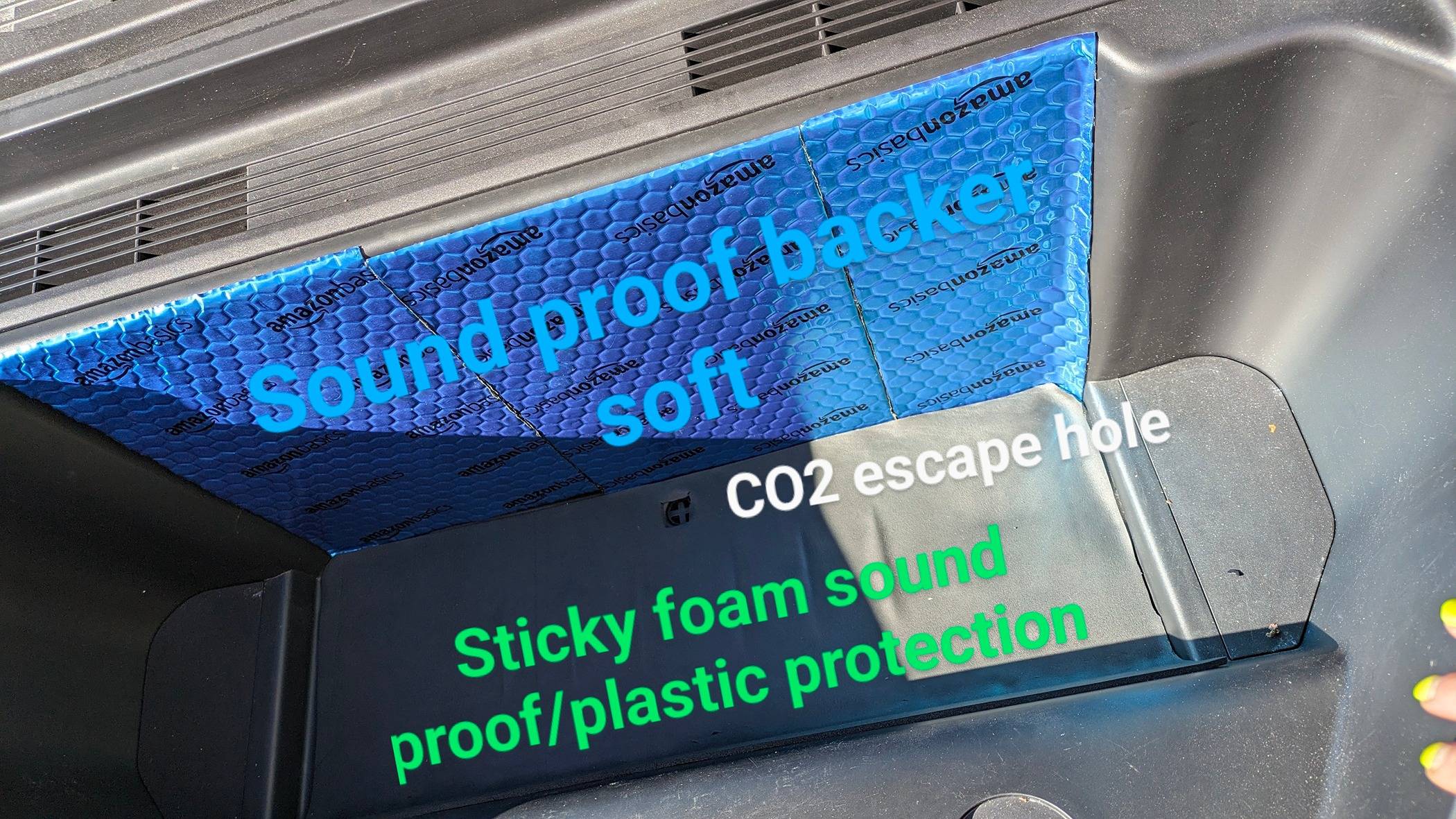

Right behind the front section is a radiator and fan (aka heat source if it's hot out). The drains should handle the overpressure if you haven't sealed them closed. I'd insulate the entire thing where any solid CO2 can touch it as -100 degrees is pretty damn cold for plastic, even if it's fiber reinforced.
I didn't realize it can get that cold. Thanks for that. ??
Realistically I want to keep the Frunk cold for a week camping. Traditional Ice only seems to last a few days.

Note that the frunk vents are really not all that far from the HVAC air intake. My canine schnozz can detect the aromas of food placed in the frunk coming in through the A/C system. Not a good idea to have CO2 escaping the frunk and putrefying the air coming into the cabin. ??

Dry ice is about -110f or -78c. You're better off with a cooler than the frunk. The frunk, especially if the vehicle is in use is just a poor choice. Otherwise you need to just insulate the hell out of it. A cooler in a cooler is a better choice, kept in the shade.

Oh good. You weren't seriously thinking of using dry ice, aka solid CO2, relatively directly in your frunk. I recommend you get a proper high quality cooler if you want to keep your ice for a week, because the frunk isn't insulated to act as a cooler.

Does the soundproofing work there? There is so much space between that backing and the firewall.
