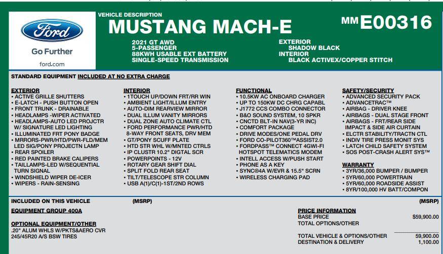

It says functional co-pilot 360 on the window sticker. :( Are you saying I wont be blue cruising?

Yep, no bluecruise on that one. That sir is a base model GT.
why does it show co-pilot360 assist 2.0 on the window sticker? i had to select that to get BC on the GT.
what does that car have?
i may have figured it out, "assist" vs "active".
12,977
17,451
You win a kewpie doll! Ford really messed up in naming that stuff. Co-Pilot 360/Active 2.0 is the hardware package that is a prerequisite for BlueCruise.
