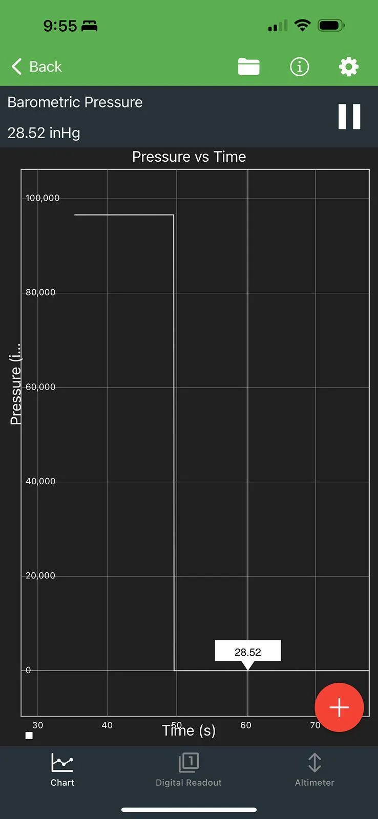

Oh and I just found a tool. If you have a smart phone you could use the app Physics toolbox. There’s a barometer in there. I set to inHg and my bedroom yields 28.52 at about 2000ft above sea level. Weather app shows 29.7, so it’s off a bit. Higher the number the lower the pressure. You could set that on and change the time scale to the clock, recording a drive. Making note of when it got annoying and check the chart. It’d be very interesting to see if there’s a lack of pressure after a while. I’m driving into work tomorrow so I’ll give it a go as well for fun.
Oh wow that is incredibly helpful. I will definitely try that. Thank you!!!
Sorry, minor correction: all units of pressure are direct scales. In other words, the higher the pressure increment, the higher the pressure.
You may be thrown by the fact that atmospheric pressure is inversely related to altitude. The higher the altitude, the lower the pressure (and, therefore, a lower number of inHg/pascals).
Got it. Thank you!
I felt my buddies eyes roll from my mistake all the way from the Adelaide BOM station lol.

Just a quick update. On my last visit to the service center I asked them to disconnect the amp to see if that’s what it was and I noticed a sizeable difference so I brought it back this week and while they had it I asked them to check the rear vents which they did and found no issues. I ran the physics toolbox and there didn’t appear to be a change in pressure that strayed far from the outside pressure. However, when it came to both the amp and the subwoofer, which they said they tested they couldn’t find an issue and unless I paid for a new amp or sub there was nothing they could do which I refused since the car is 2 months old and it’s a lease, so I’ll try to figure something else out cause I’m pretty sure that is the issue. I do seem to be one of those people that has a high sensitivity to low frequencies I was just never in any car that ever bothered me before nor did I imagine that this was some sort of possible issue- that a car would randomly emit a low frequency. But we’ll see.
