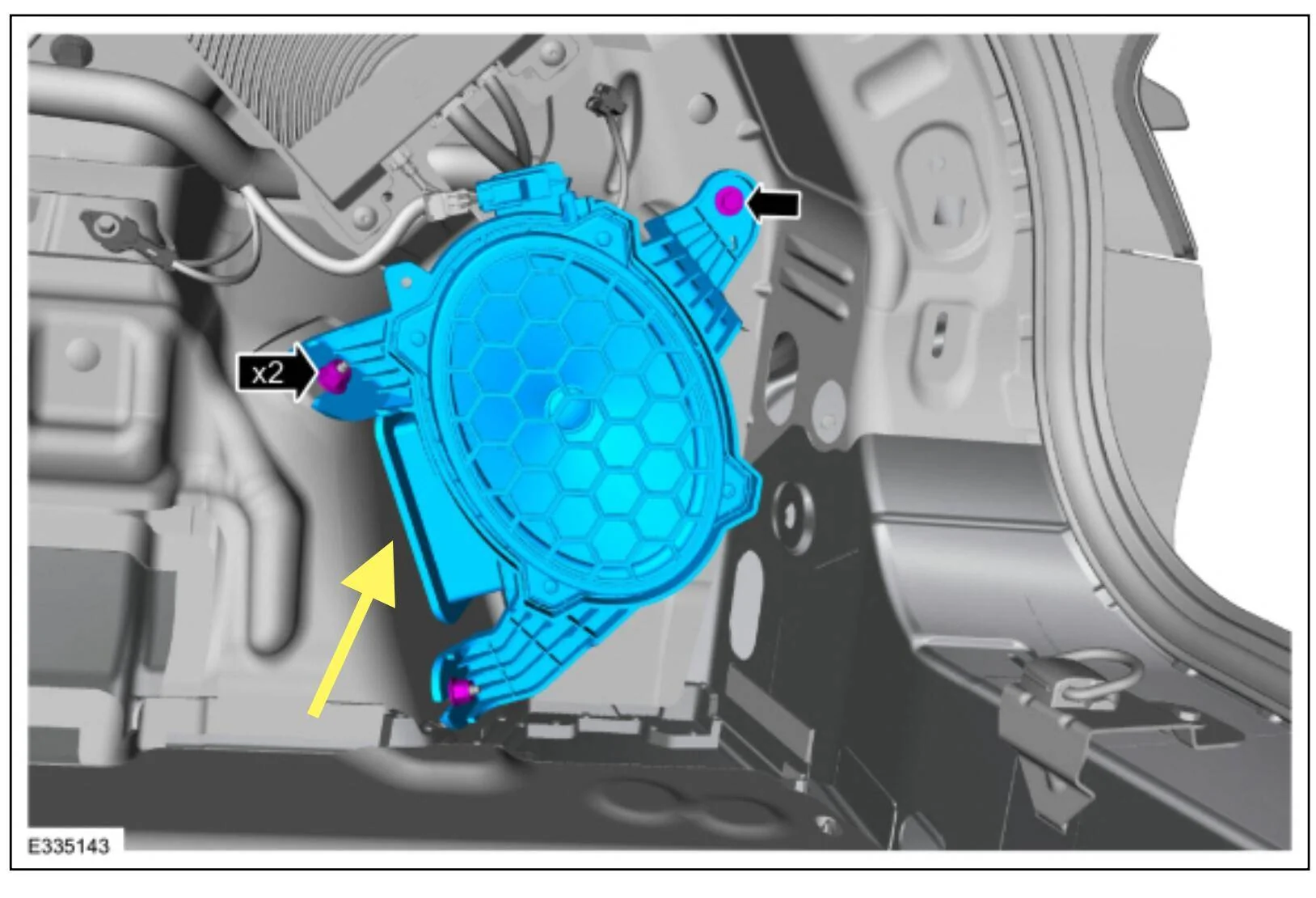

Yes it can be done. You’d need to get access to the sub, which is loosening that panel. You don’t have to remove the panel as it’s a pain, but once you remove the sub, you could apply Dynamat to ‘plug’ the hole.
The yellow arrow points to where the backside of the woofer vents to the wheel well,
Ford Mustang Mach-E Mach e hurts my ears Screenshot 2024-05-11 at 3.50.08 PM
that's what you would want to seal off if you wanted to try to keep the speaker. Even plugged the woofer will still function, just not as low of tones. I haven't foundry other 'vents' in my poking around that could cause what you are dealing with. BTW have you tried running the fan on 1 not on recirc?

Yes it can be done. You’d need to get access to the sub, which is loosening that panel. You don’t have to remove the panel as it’s a pain, but once you remove the sub, you could apply Dynamat to ‘plug’ the hole. Let me get you a screen shot.
Thank you so much azerik!!!
