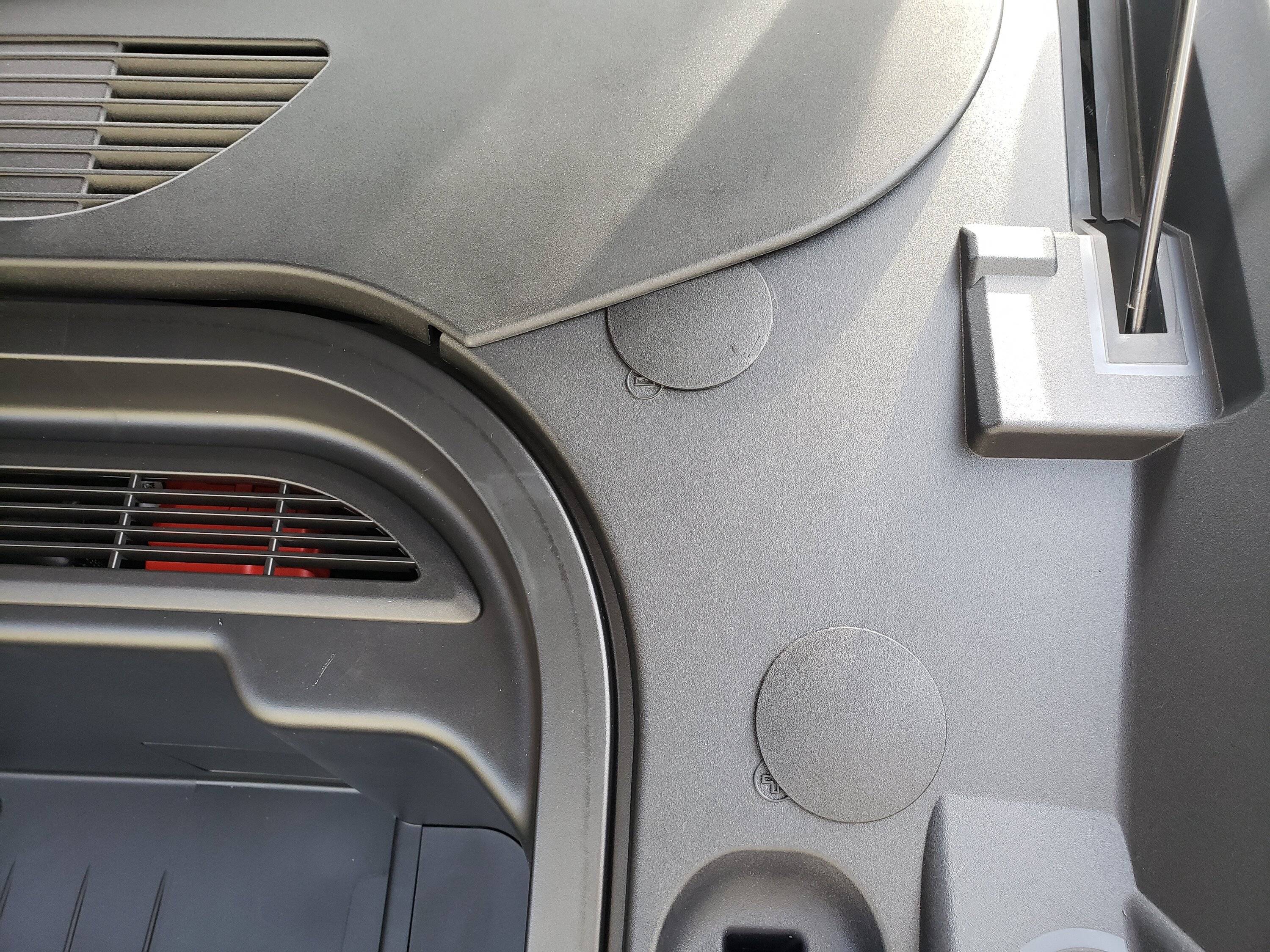

While you are doing this, I highly recommend cutting holes in the trim panels over the LVB connection points. It was one of the first things I did to my MME. Then you don't have to remove the panel and risk losing a clip or two.
