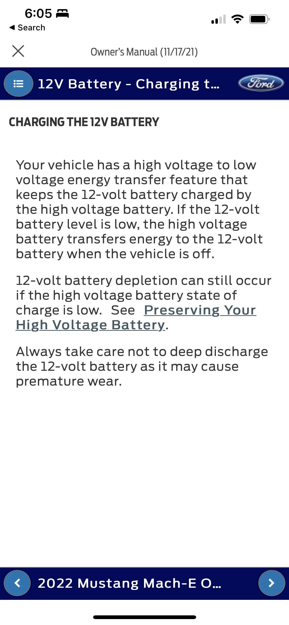

I found this in the owners manual:
CHARGING THE 12V BATTERY
Your vehicle has a high voltage to low voltage energy transfer feature that keeps the 12-volt battery charged by the high voltage battery. If the 12-volt battery level is low, the high voltage battery transfers energy to the 12-volt battery when the vehicle is off.
12-volt battery depletion can still occur if the high voltage battery state of charge is low. See Preserving Your High Voltage Battery

That is great information. Thanks! So we don’t nEed to worry about a battery trender.
mkhuffman
Nov 19, 2020
6,880
9,518
Except I don't think we can assume the LVB is maintained when the car goes into deep sleep. Ford recommends disconnecting the LVB when storing the car for a reason. A battery tender is easier than disconncting the LVB, IMO. If I ever store my car, I will attach a battery maintainer.
