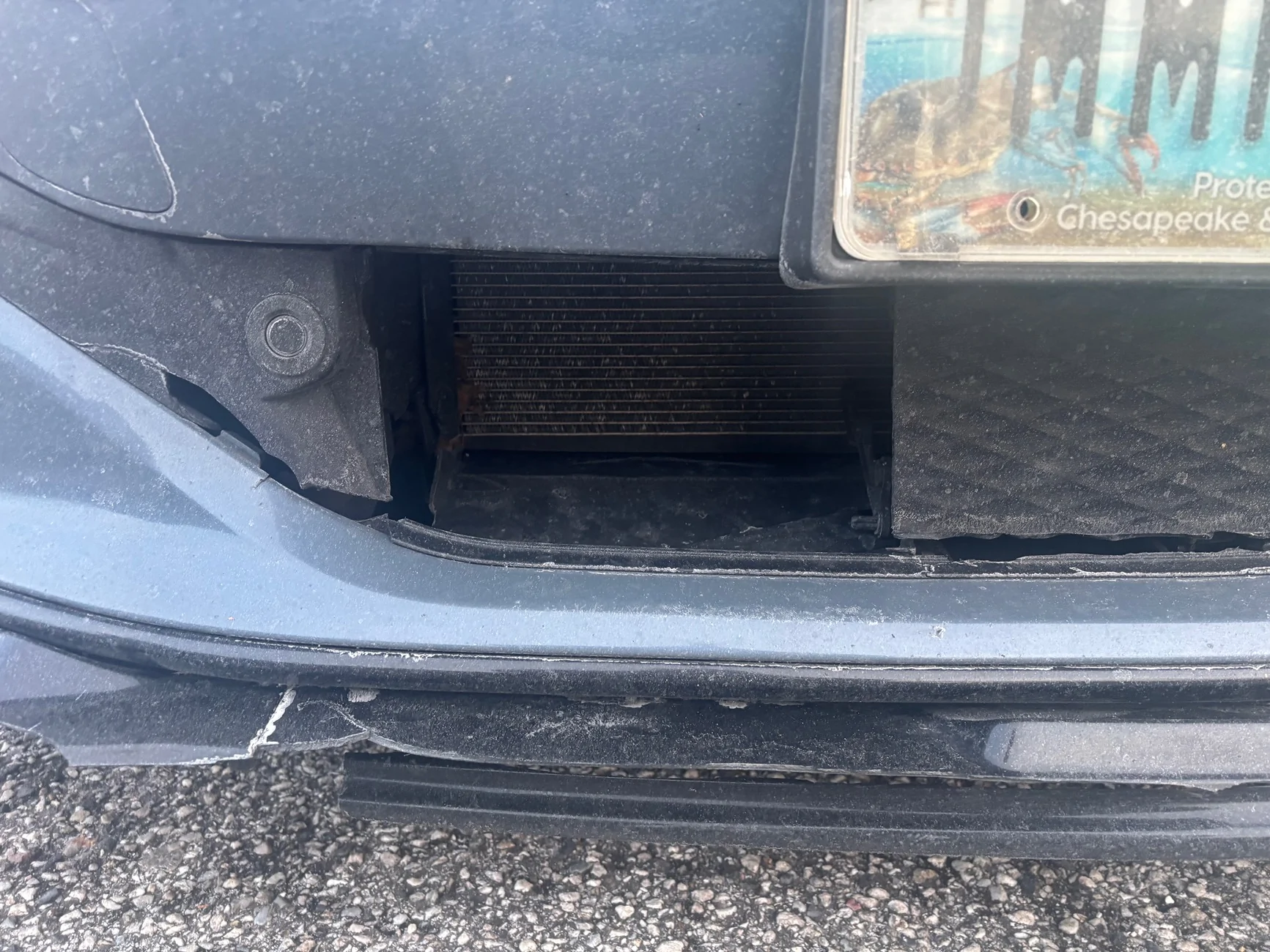

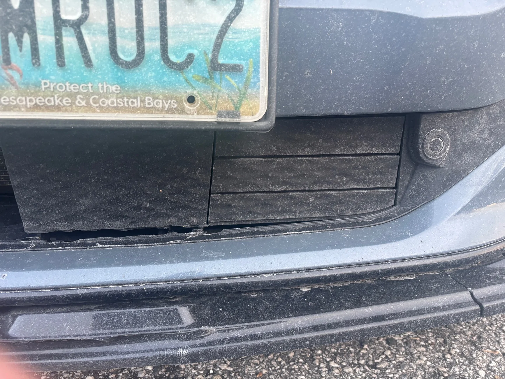

I wanted to know if anyone has replaced the lower grille without taking off the entire front bumper.

I made a valiant effort to replace that part without removing the front bumper, and failed entirely. The front bumper does need to come off.

based on the parts diagram, I thought it would be possible. Thanks

Yeah, it really seems possible, but it is just impossible to get a tool onto the necessary tabs with the bumper in place.

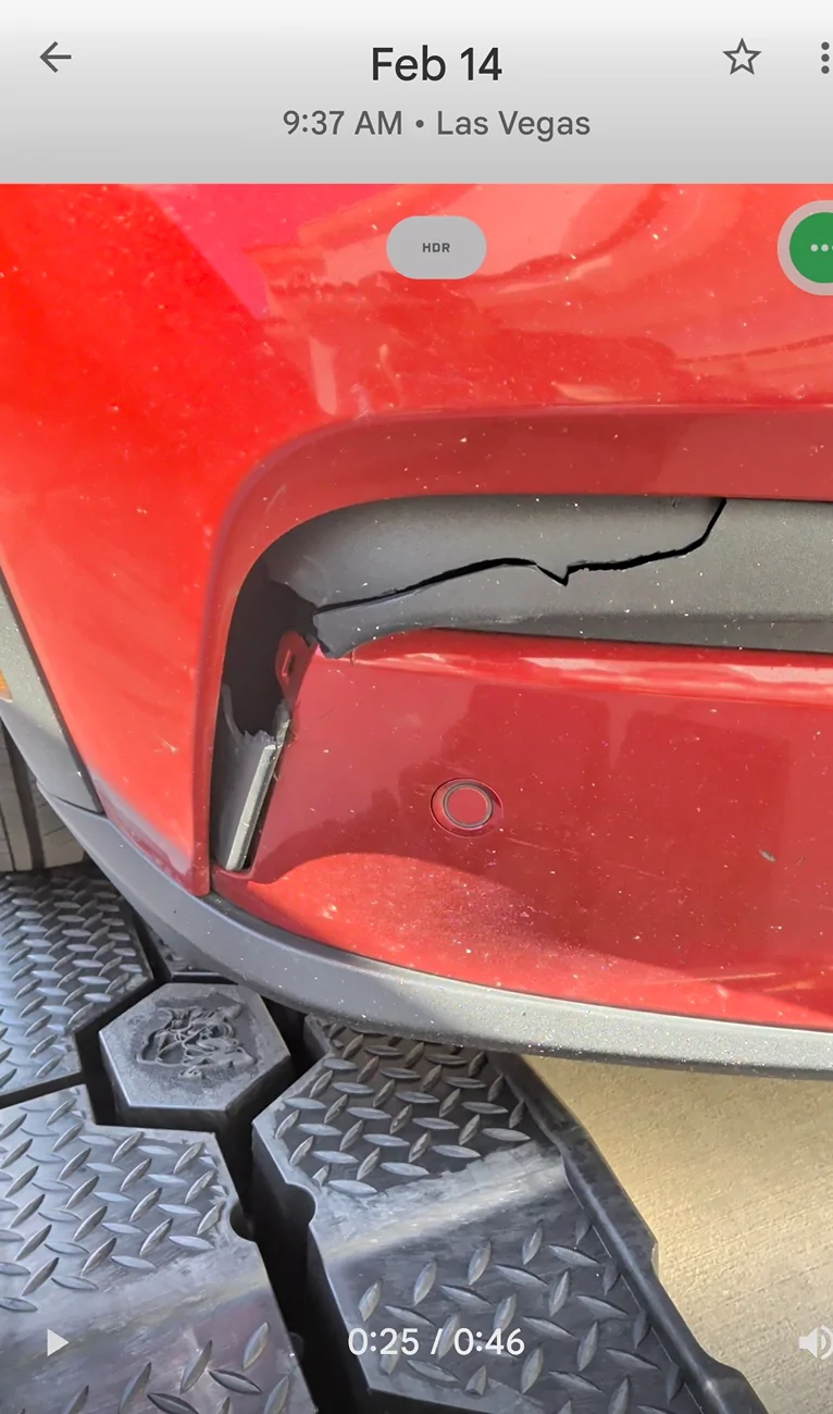

Yes you absolutely can do this without taking off the entire front bumper. My son and I were able to this in about 4 hours (that includes cleanup). The black lower shutter grill assembly was purchased through Parts Geek (2022 Ford Mustang Mach-E Radiator Shutter Assembly) sku 601-563. There were a lot of clips, and we had the car up on a ramp but Ford was going to charge $$$$ to do this work. The part was $367 and our labor.
Ford Mustang Mach-E Mach E Lower Grille replacement Mach E - Cracked Lower Shutter Assembly

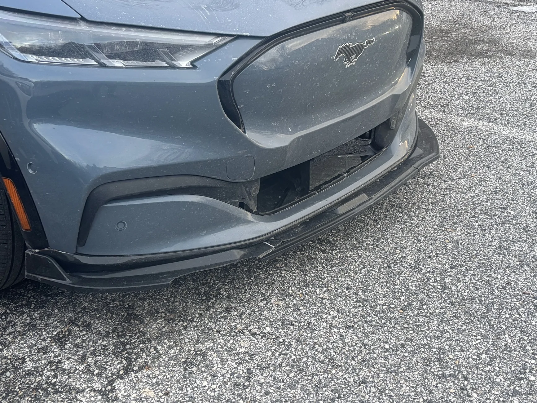

I had the same happen to me on the last storm. My car skidded and plowed into ice and the lower grill + the radar got damaged, and the left side fender got a small scratch. The body shop charged $4.500+ for the repair.

Greetings, I don't know the answer ....but I have a "toothless" MME as a rock took out one of the louvres. When you do get it repaired I'd be interested in the middle drivers side louvre if it's salvageable. I'm hoping to just bend a replacement back into the old one's location. Thanks much. Taylor

Yes I have lost a couple of the louvers too, in fact when we took the grill assembly apart one of the louvers was stuck at the bottom. My son 3D printed 10 of these for me to use, plus I got a ton from the replacement part.

(I haven't gotten underneath to check access yet but I have to believe I might even be able to bend it in from the front if needed. It's the drivers side middle one. (looks like it's missing a tooth)
