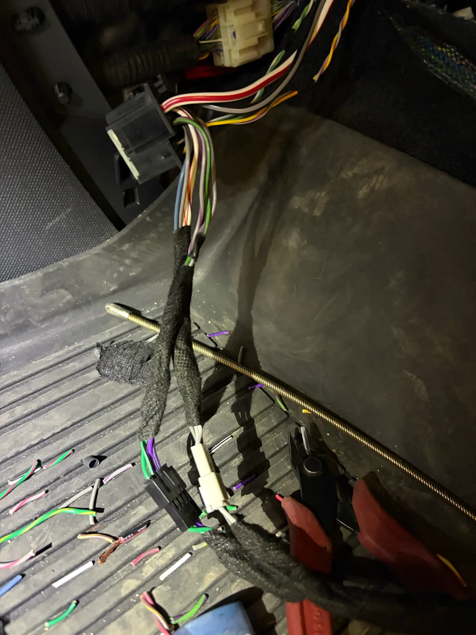

🛑 THE CRITICAL TRAP: Base System Warning Chimes
⚠ READ THIS BEFORE BUYING PARTS
If you have the Base Audio System (Non-B&O) and do not want to use FORScan to reprogram your vehicle's chimes, YOU CANNOT use just a simple Left and Right signal for your LOC or processor (like a FiX 82).
If you only tap a single pair, your vehicle’s critical safety sensors, radar tones, and warning chimes will route to a single secondary speaker rather than staying properly categorized. To preserve factory chime routing without computer programming, you must sum the appropriate channels.

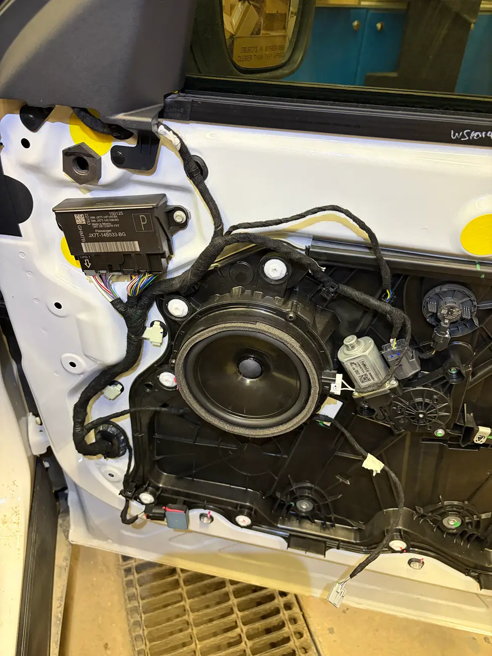

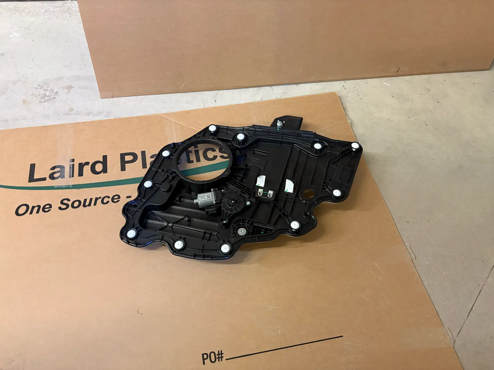

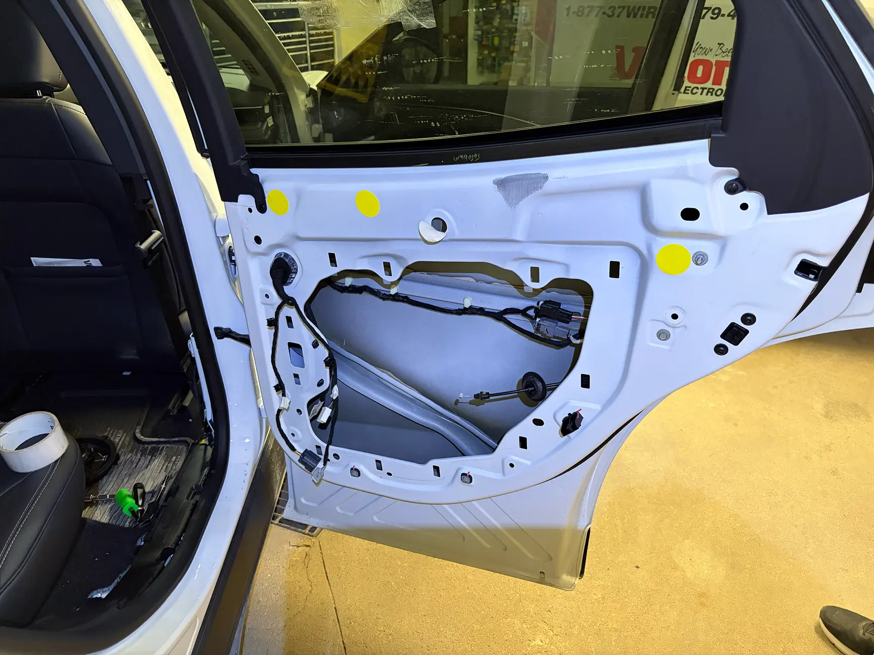

Step 1: Rear Stage & Lighting
The build began at the back of the cabin to keep the car functional for daily driving while work progressed:

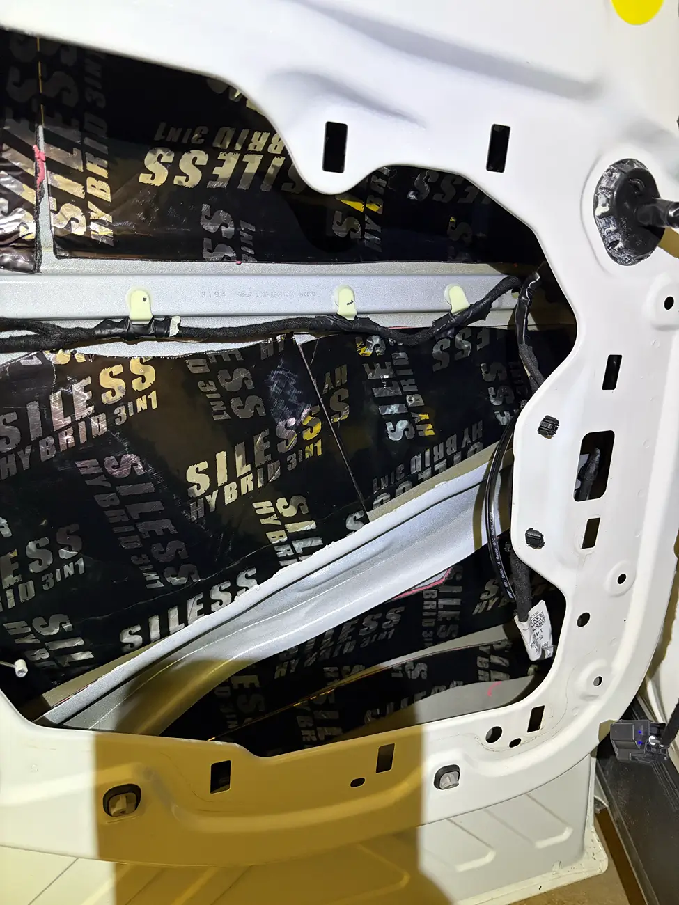

  • Acoustics: Fully sound-damped the inner and outer rear door skins and replaced the factory drivers.
  • Harnessing: I did NOT reuse any factory speaker wiring. Completely new, high-quality speaker wires were run directly into the doors.

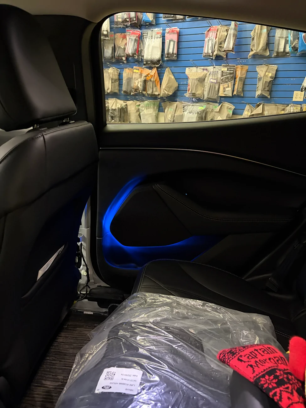

  • Ambient Lighting: Integrated custom Ice Blue LED strips into the door panels to perfectly match the factory interior cabin lighting accent color.

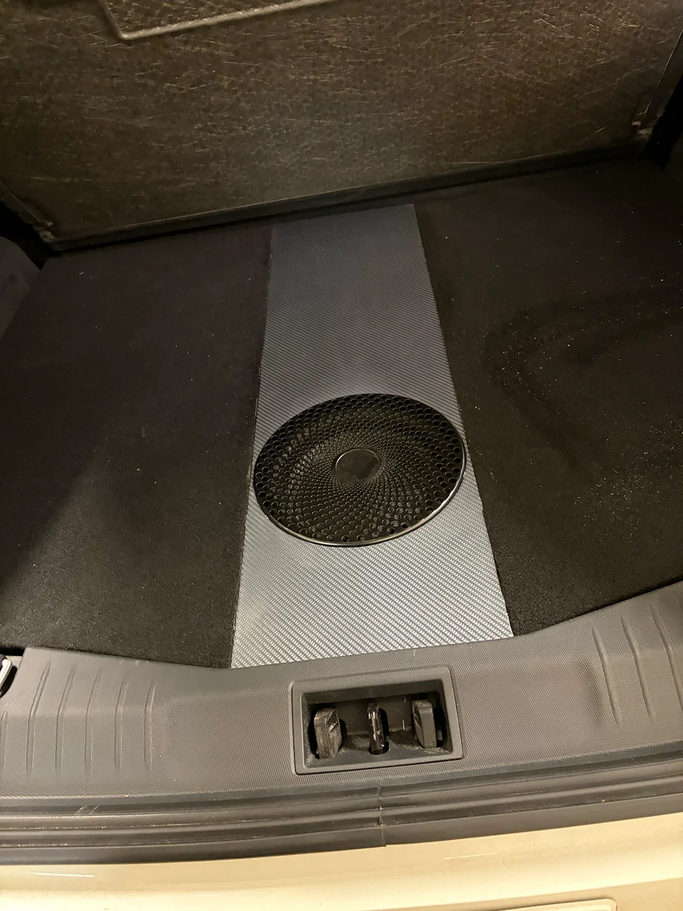

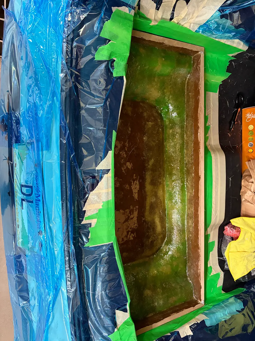

Step 2: The Custom Subwoofer Enclosure
For the low-end, I wanted a single, high-output 10-inch subwoofer rather than a shallow-mount option. Because this is a shared family vehicle, preserving cargo space was non-negotiable.
  • Fabrication Process: I built the enclosure directly into the spare tire well recess without strict pre-measurements, letting the vehicle's shape dictate the box. I used heavy MDF for the main flat panels to give the enclosure structural rigidity, utilizing fiberglass exclusively to mold into the tight, curved corners of the well. Bondo was applied at the end to smooth out structural imperfections before wrapping it in automotive carpet.

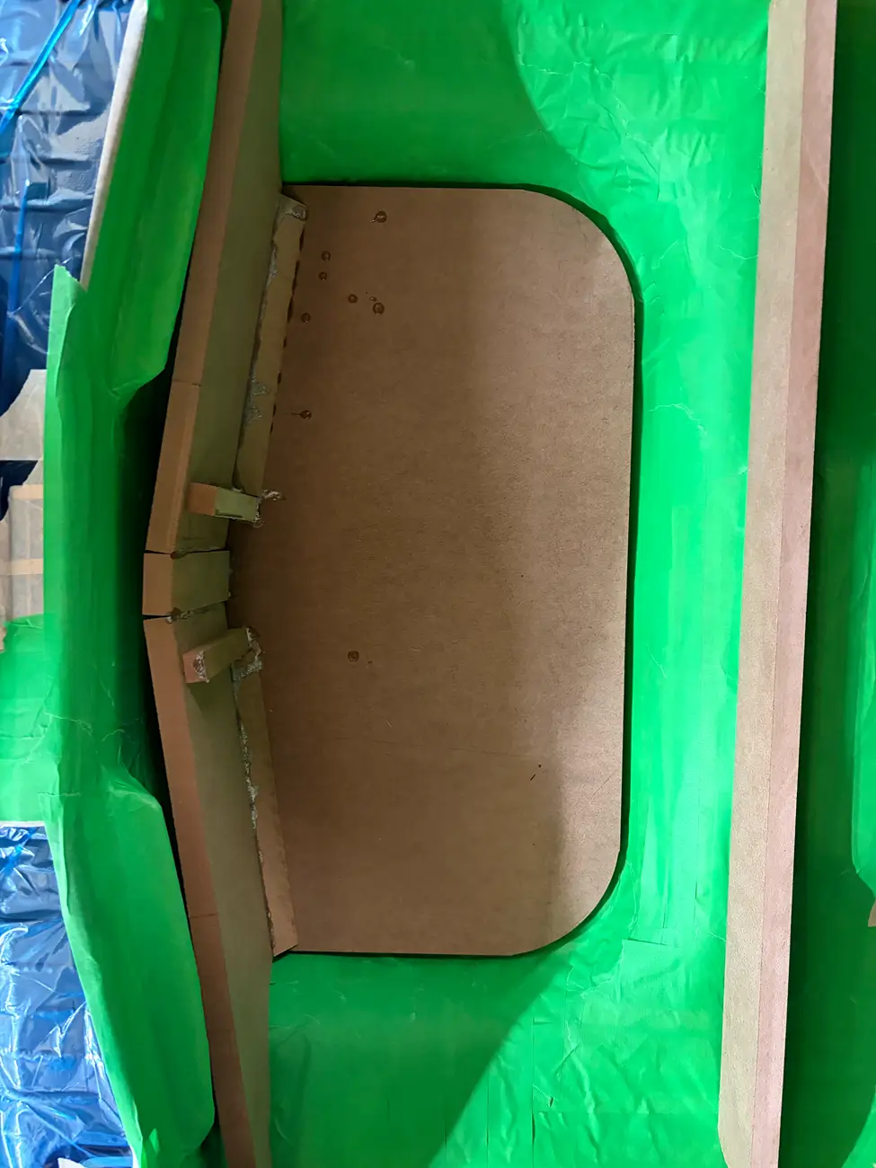

  • The Floor Clearance Challenge: Once the box was carpeted and installed, I realized the factory cargo floor rested directly on top of the subwoofer surround.
  • The Solution: I used the factory floor panel as a stencil to create a completely custom, elevated cargo floor raised 1.5 inches higher than stock.
  • Cosmetic Finish: To protect the cone while allowing maximum air movement, I integrated a heavy-duty Recoil 10-inch steel mesh grille. The new floor was finished with a premium vinyl accent strip down the middle, flanked by matching automotive carpet on the sides.

  • The "Why" Behind the Chimes: Explicitly detailed why a 2-channel LOC fails on the base system (safety tones getting forced to a single speaker). This makes your technical advice bulletproof.

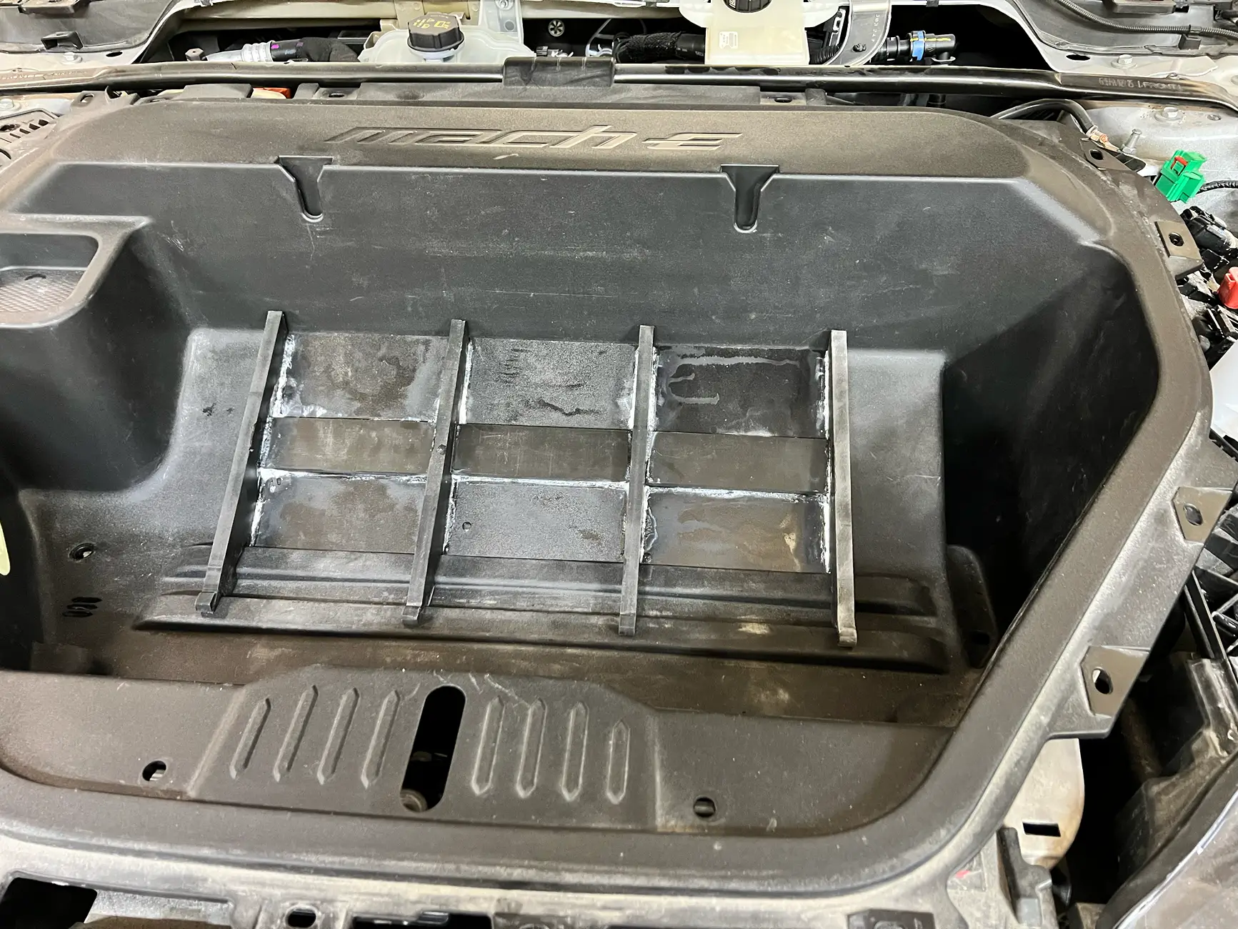

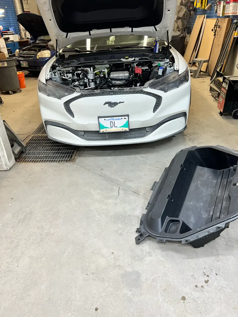

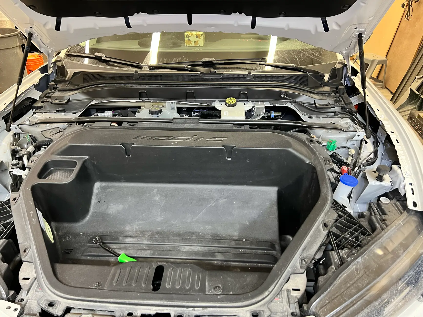

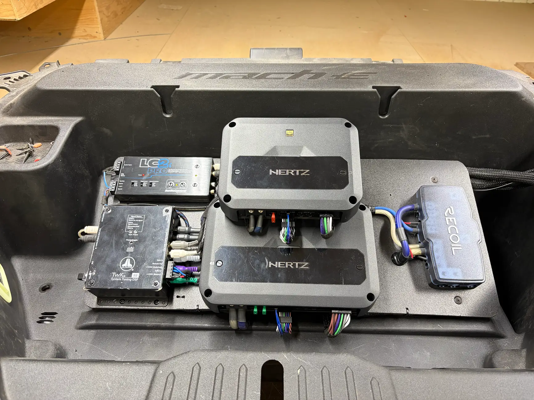

AMP RACK (I wish I had 2024 Frunk)
The factory floor of the frunk has complex, irregular curves that make mounting components difficult. To create a perfectly flat mounting surface, I first created a template using cardboard stencils. Once the fitment was dialed in, the shape was transferred and cut out of 1/2-inch Sintra (expanded PVC). The main base of the amplifier rack was constructed out of this same durable, weatherproof material.

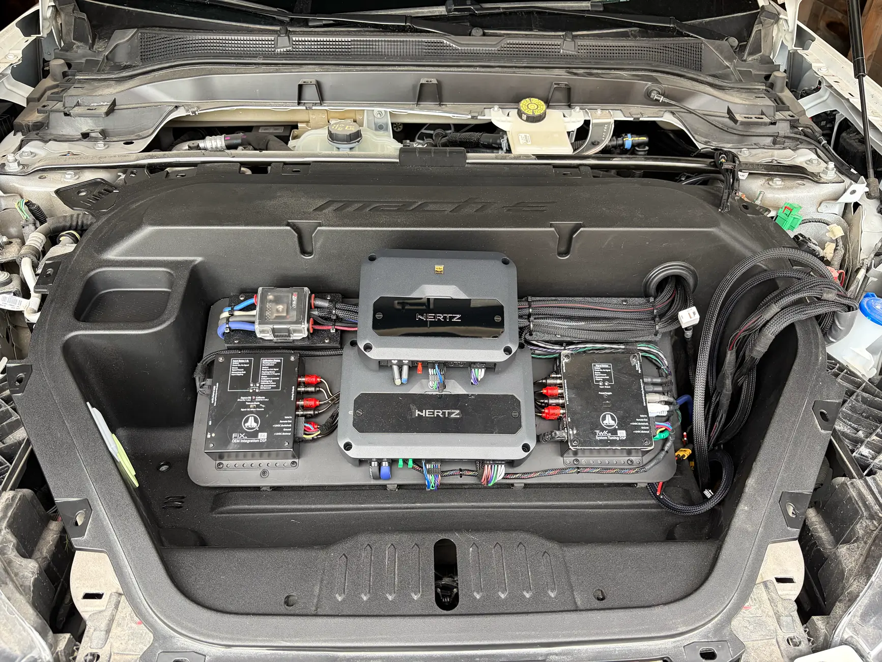

Rack Architecture & Wire Management
Space constraints required a compact, efficient layout for the electronics:

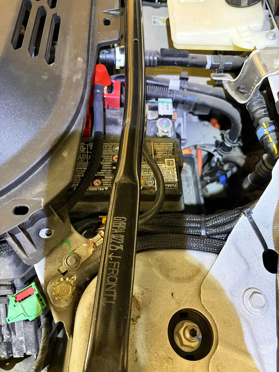

  • Waterfall Design: The amplifiers were mounted using a stepped "waterfall" layout to maximize every millimeter of available footprint.
  • Elevated Wire Bridges: Custom bridges were fabricated to allow clean wire routing directly underneath the components. This allowed for maximum physical separation between power/ground cables and signal/speaker wires to prevent any introduced system noise.
  • Grommet Pass-Through: A 2-inch hole was drilled into the frunk floor to accommodate wiring pass-throughs and provide expansion flexibility for future upgrades.
Connections & Serviceability
To make the entire rack easily removable for maintenance, quick-disconnects were integrated throughout the harness:
  • Speaker Outputs: Heavy-duty XT60 connectors were soldered onto all speaker lines.
  • Signal Inputs: A heavy-duty, multi-conductor 9-pin connector was repurposed to consolidate the factory speaker input lines running to the JL Audio FiX 86.

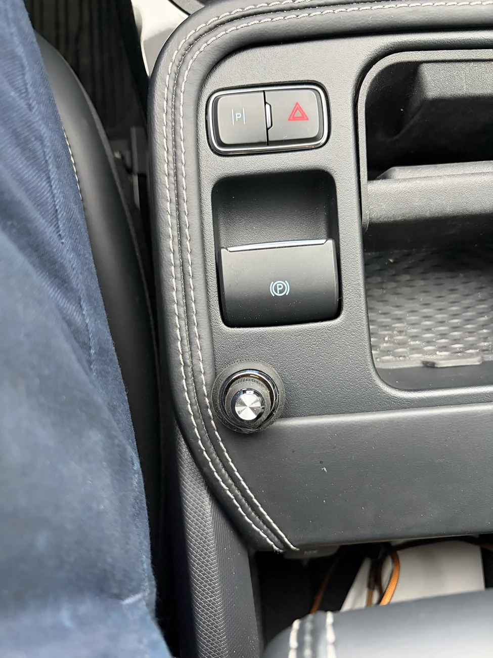

  • Bass Knob Integration: A dedicated coupler was used to route the JL Audio TwK 88 remote tuning knob extension cable into the cabin.

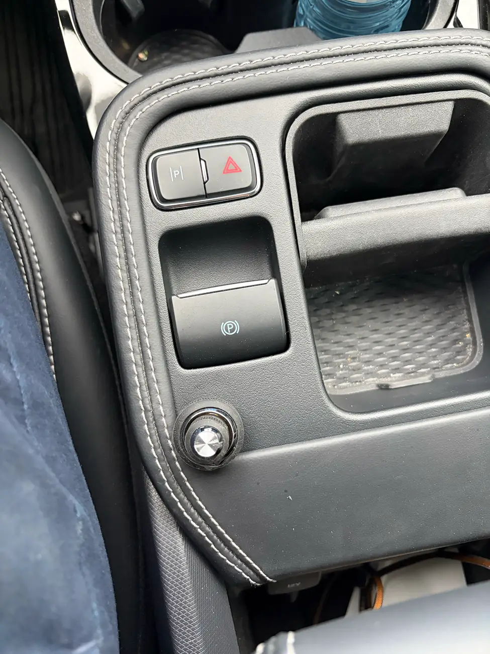

Bass Knob Controller Placement
💡 Installation Note: To mount the JL Audio TwK controller knob, the center console around the electronic parking brake area was dismantled. This location offers a clean, factory-integrated look that is easy to reach while driving. However, this placement is entirely optional—feel free to choose whichever mounting location feels most comfortable for your driving position.

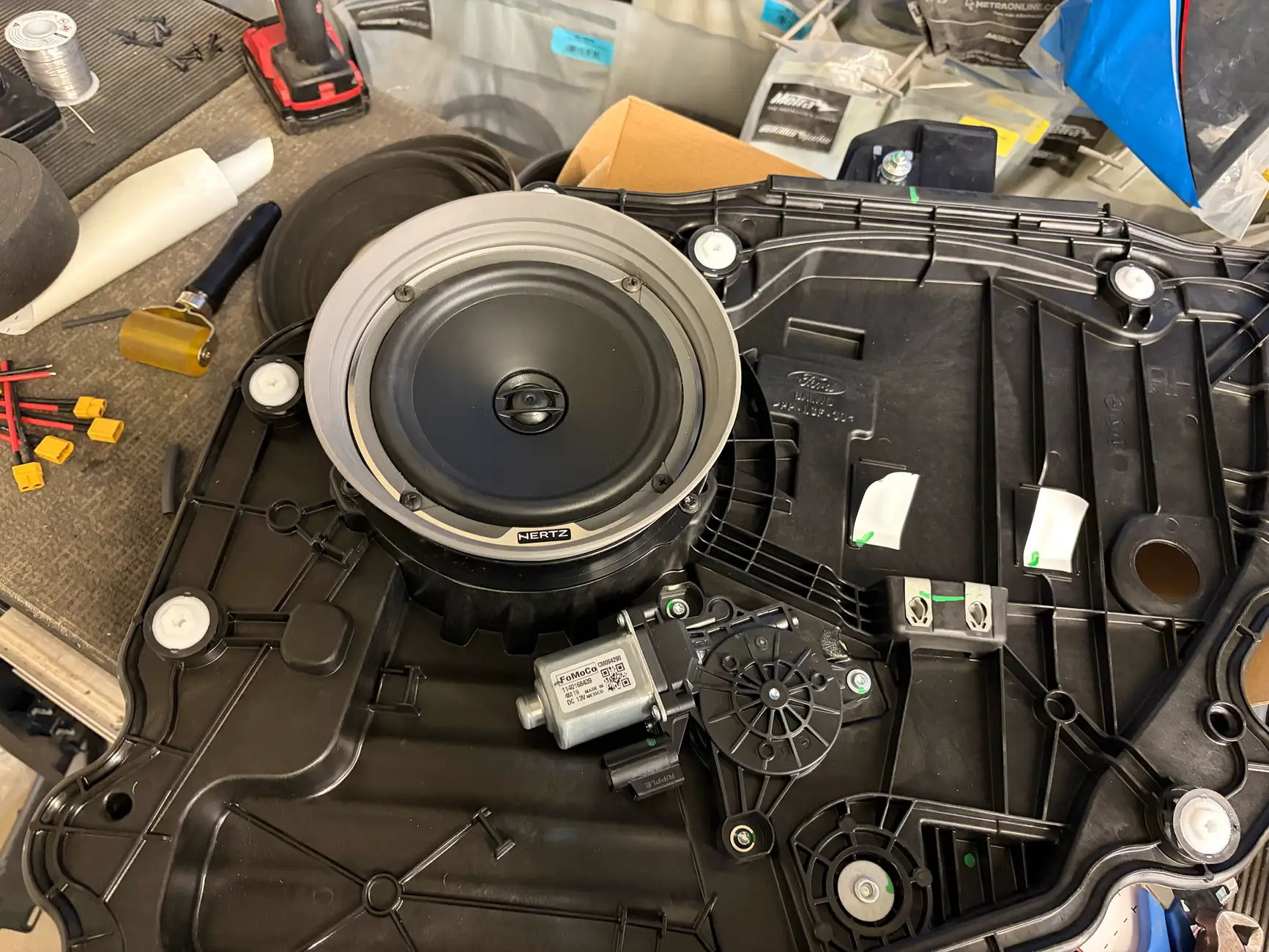

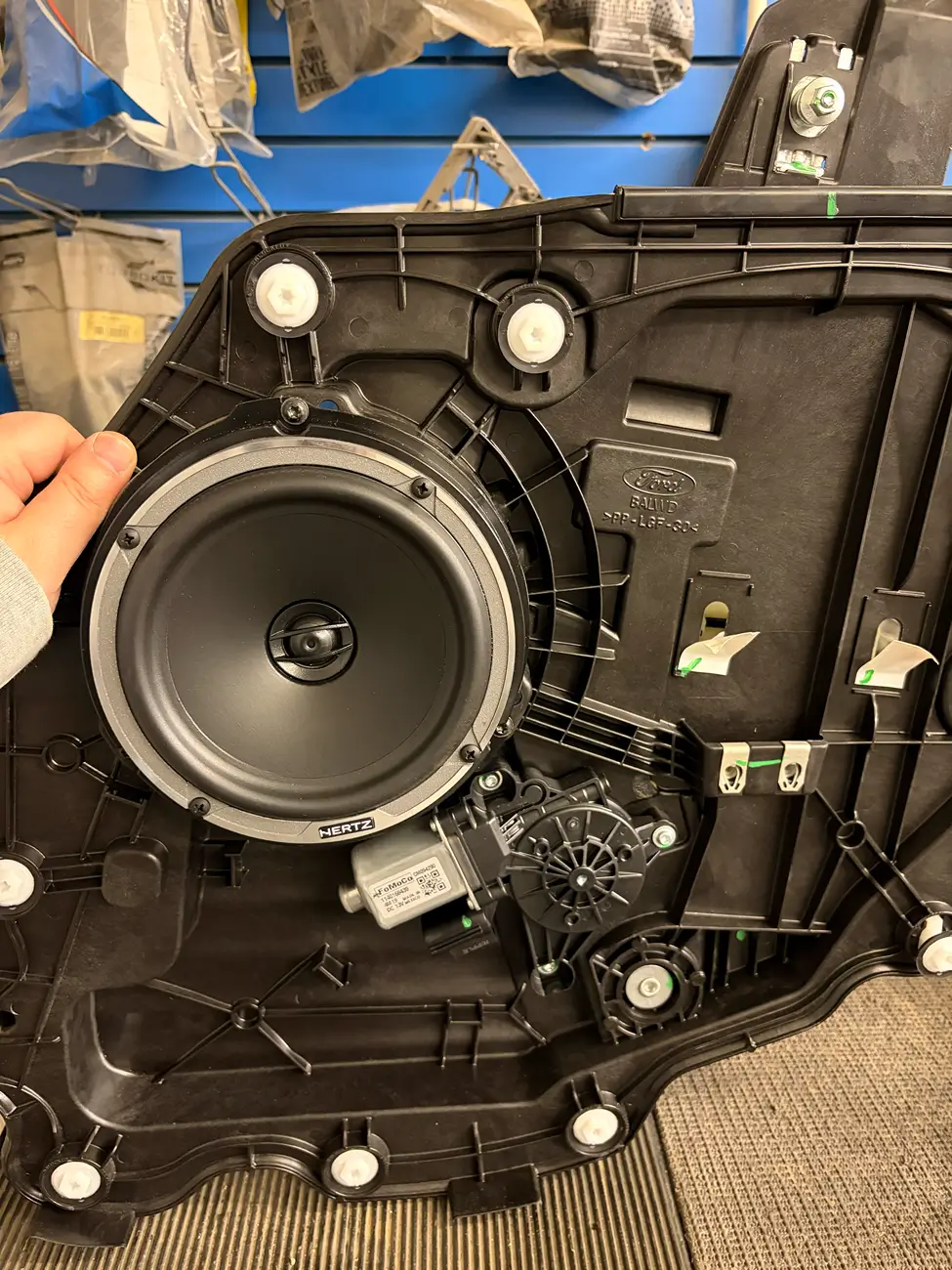

FRONT SPEAKERS AND TWEETER

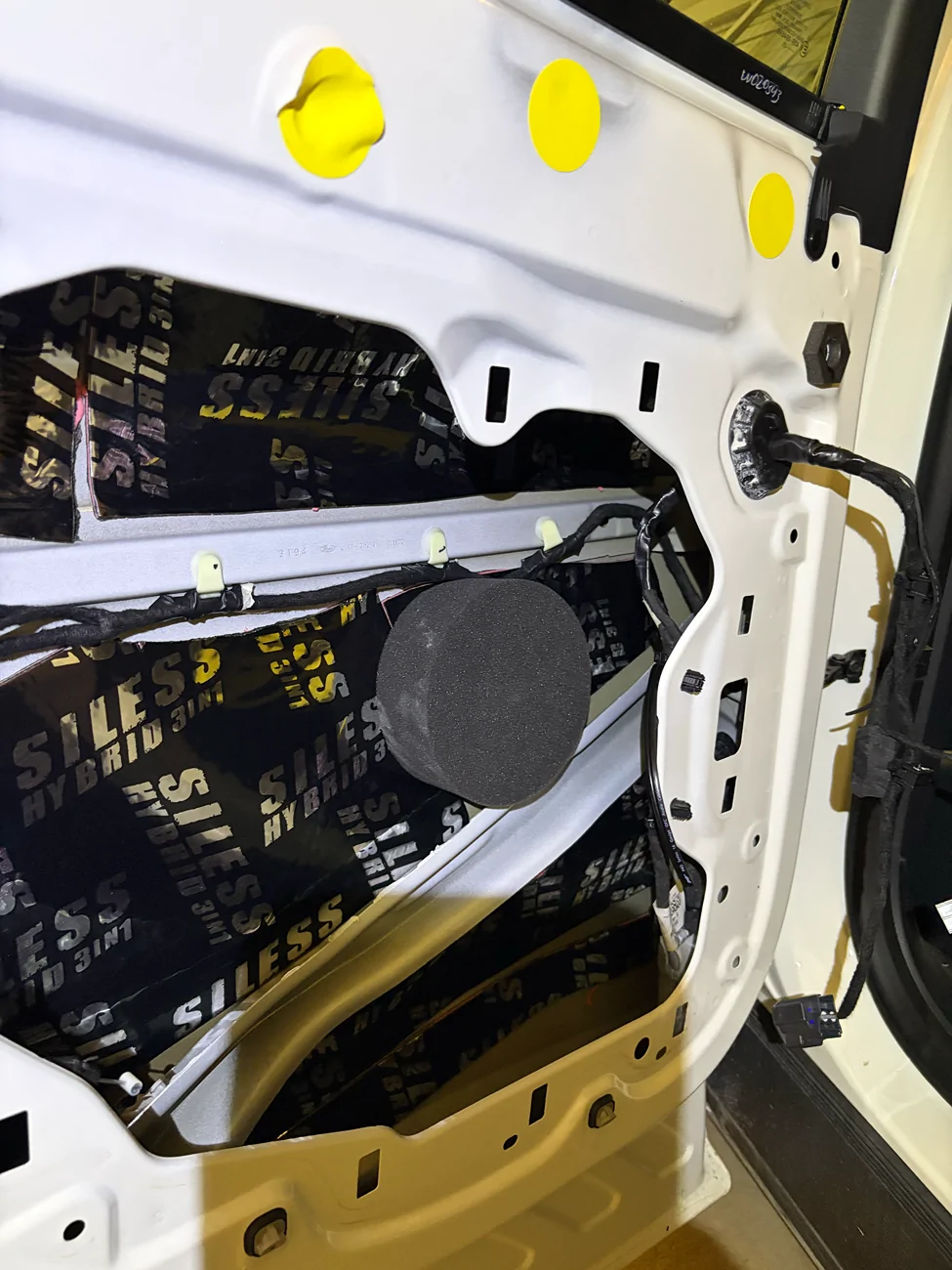

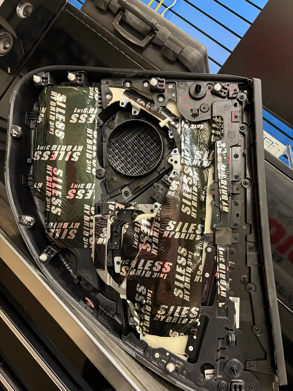

The front door speakers received the exact same treatment as the rears. This included full sound-damping coverage, custom LED strip integration, and completely fresh wiring run for the entire setup.

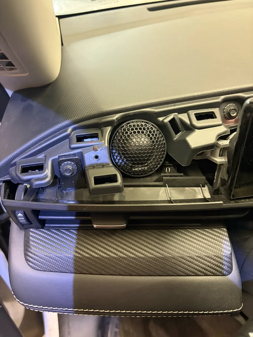

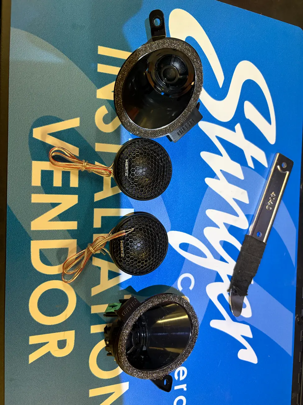

Custom Tweeter Retrofitting
Upgrading the factory tweeters presented a unique fabrication challenge. The new aftermarket units measure 1.38 inches, making them too large to fit inside the factory housing locations.
  • The Solution: The factory inner structures were removed to clear out room.
  • The Mounting Trick: Wrap Tesa tape tightly around the body of the new tweeter. This creates a textured surface that easily bonds with drops of CA glue, allowing you to securely lock them into place without needing bulky mounting hardware.
  • Acoustic Alignment: For proper sound staging, the passenger-side tweeter was intentionally angled to face directly toward the driver's seat.

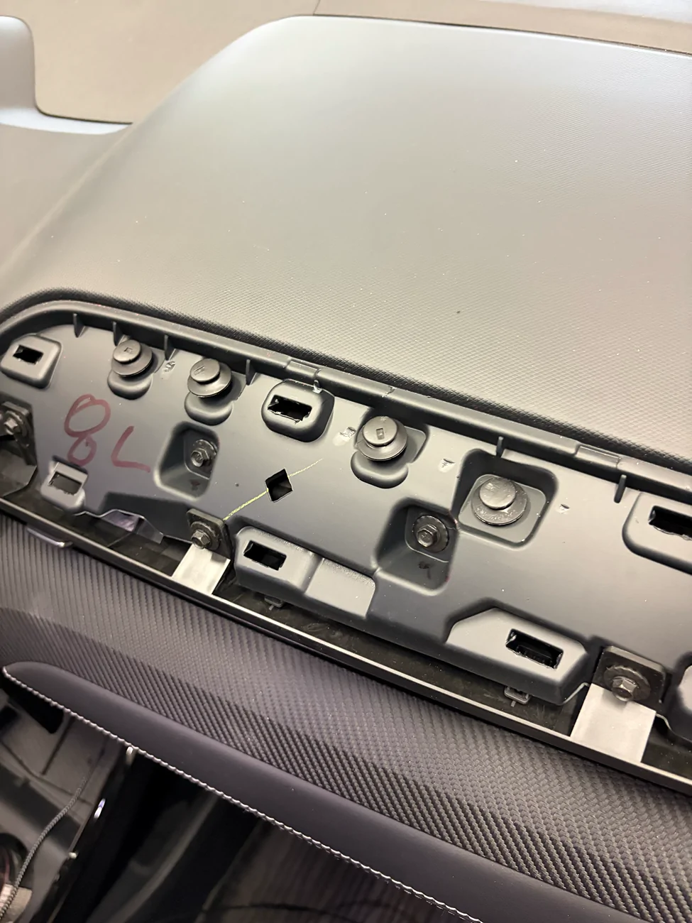

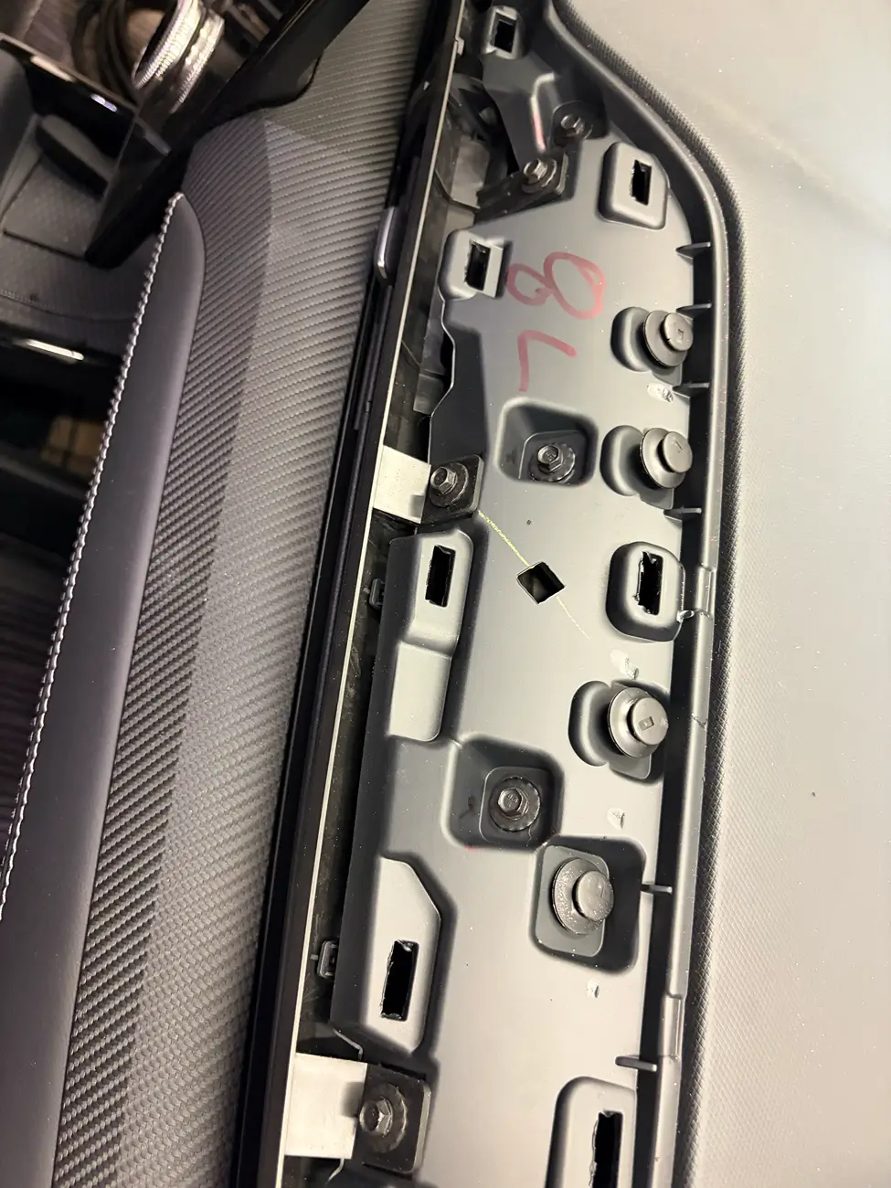

🛑 IMPORTANT: CRITICAL REMOVAL WARNING Please exercise extreme care when dismantling the factory tweeter/A-pillar area. The trim panels on both the driver and passenger sides are held in by fragile plastic retention clips that will snap if pried incorrectly.
Do not force the panel. Use a plastic trim tool and refer to the reference photos below for the exact locations of these clips before applying pressure.

Very nice work, love the way the frunk looks. Almost like the smaller frunk forces that "waterfall" looking design and it works :)
Frustrating that the TwK doesn't have high level inputs...that's a really crummy choice for any DSP. That's an incredibly expensive setup to need the LCI and the FiX -I'm assuming that the TwK doesn't have a lot of input signal correction which required the FiX?
I'm a bit confused on chimes...I did not have the same issue on my 23 and in fact had to reprogram using Forscan to move them to that hidden speaker as the chimes tone included an obnoxious amount of 15-50hz noise. Are you saying that in your car the speaker signal properly routed when using the front left/right, but the chime signal didn't?
PS - for anyone reading this in the future - the JL Audio FiX is a piece of equipment that takes the factory audio tune and reverts it to a flat signal. It's kind of like a preprocessor for the DSP...Meaning that you get a nice flat signal without time alignment out of the FiX and then can tune that using a DSP after it like the TwK. There's 2 points I want to make here -
  • The FiX is $449. You can get a Forscan subscription and dongle for <$100...You can then reprogram the audio signal to flat within the headunit (only on the base model, the B+O will never output a flat signal). Then you don't need the FiX and can use any LOC like the LCI. You also avoid the head unit modifying the signal, the FiX unmodifying the signal, and then the DSP modifying it again...just a bunch of unnecessary steps and opportunities for noise.
  • If you get a DSP that has high level inputs (honestly most of them these days, JL is really riding on name recognition from the 90's/early 2000's and hasn't put out a lot of actually new products in the last 10 years) then you don't need an LOC. A FiX is $449 and a TwK is $579...You can get Helix or Arc DSPs with high level inputs for similar or less than that.

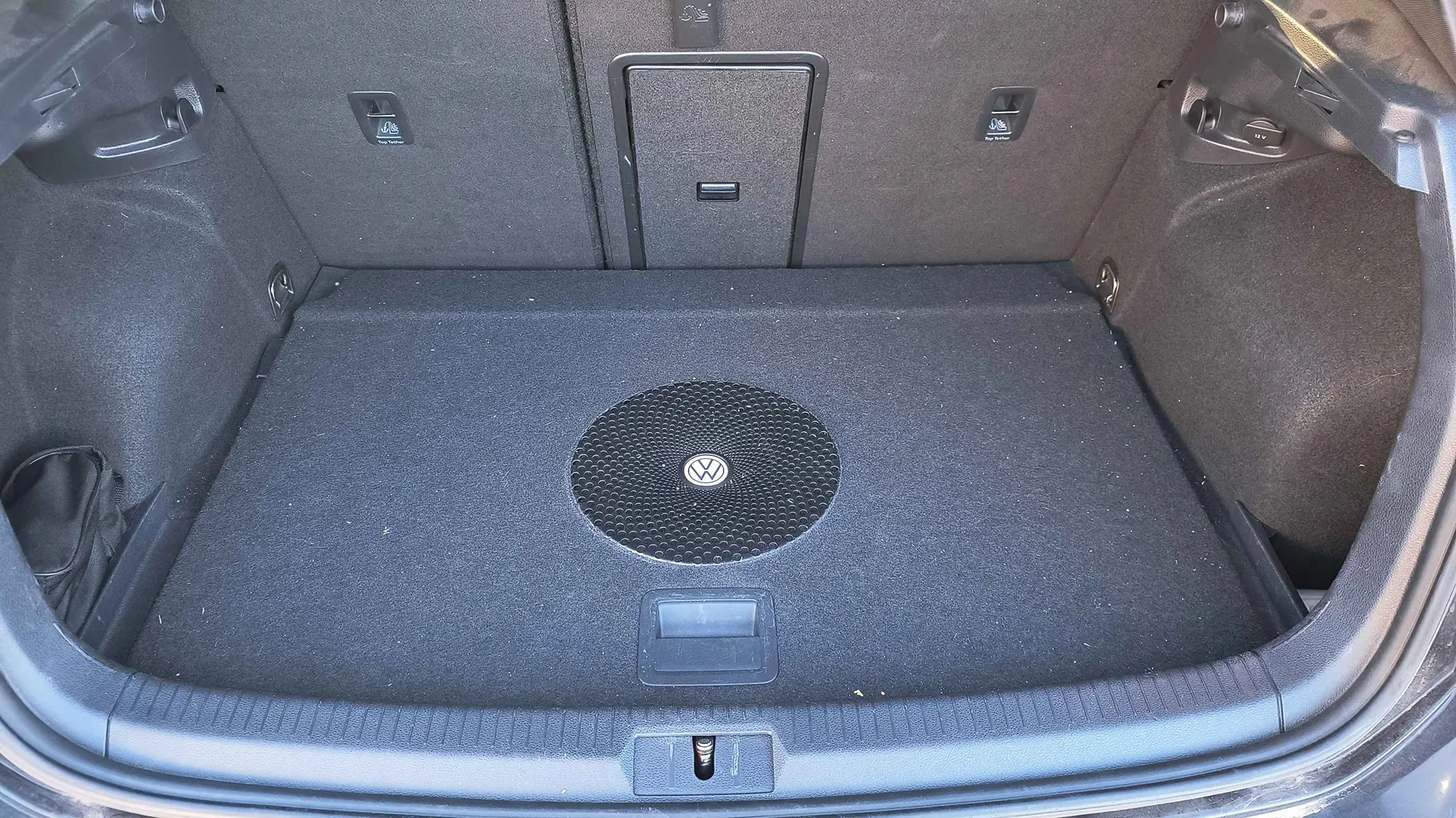

PPS - A friend has a nearly identical setup in their Golf for the sub with grille. You should get a pony sticker made and place it where they placed the VW sticker :) They used stickylife to make the sticker -
Hi,
I will definitely get a sticker.
Thanks for the link.
Also, sorry for confusion, so what happen w
Hey,
Thanks for the sticker website.
Sorry for confusion, for FIX86 I used front/back and left/right.
So I don't like that hidden speaker chimes(I did not have anything plug into the rear speaker for a while, so system automatically switched to back up speaker as it was not able to see any load on the speaker lines), so I wanted the way it is from factory. My Chimes are normal like factory but YES they we annoying before tuning the system, after that everything is still like factory but with way better ride to work with my music.
I had FIX86 lying around from my previous install and TWK88 I bought it at a below retail prices as I had connections with JL Audio Rep in Winnipeg.
I thought about doing the whole system with OPTIM8 Alpine, but at the end I most used stuff which I had already.

Ah that's interesting, so if the rears are unplugged entirely the chimes default to that hidden speaker, but the front signal for music is still there.
I think the equipment is good to great, especially if you already have it handy or are buying used...I've just spent a lot on this hobby and would tell folks to avoid this path for new equipment.
And really - if it makes you happy then that's all that matters in the end. I do really love the look and the equipment is a big part of that...but so is the designer - again great work dude!
