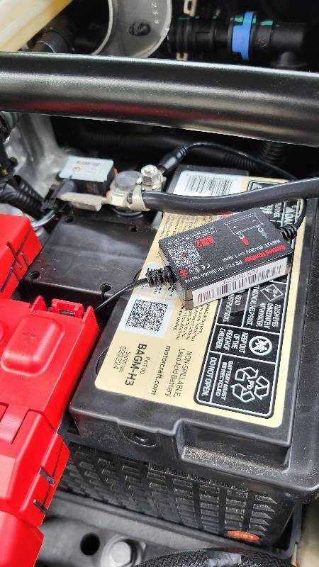

It's difficult to get static voltage readings on these modern vehicles because just approaching them wakes them up and you then get a false reading.

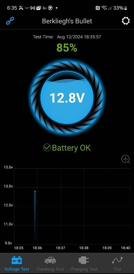

I installed a Bluetooth voltmeter on the AGM and I can get a reading without waking the vehicle.
Here is what I got just a few seconds before typing. I'm in the RV, the Mach-E is outside.
Ford Mustang Mach-E Measurement point(s) for 12V? Screenshot_20240812_183557_Battery Monitor
It also logs the voltage 24/7/365.

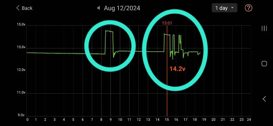

Here is today and you can clearly see my trips (circled) to the office this morning and the trip back home. (along with a couple of errands)
Ford Mustang Mach-E Measurement point(s) for 12V? Screenshot_20240812_183719_Battery Monitor
The voltmeter is about $25 and is perfect for these crazy vehicles.

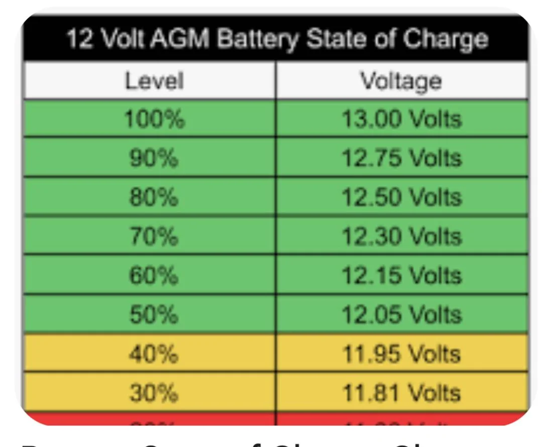

Attached chart shows a guide to battery charge percentages.
The Mach-e is supposed to start charging the 12V irrespective of whether turned on or off, plugged in charging or not so long as HV batt is over 15% SoC within 48hrs of 12V batt reaching 40% charge or immediately if 12V batt Voltage drops to 30%.
I’d have the 12V battery & charging system checked out by dealer unless you’re proficient at removing batt, charging and testing after full charge.

Care to share the identity of volt meter you purchased and how it is installed?
