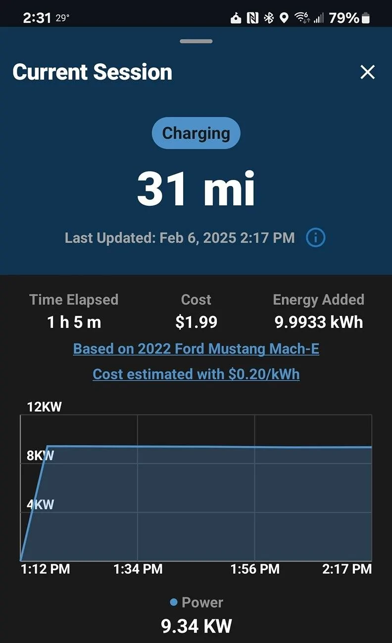

Ha. Mine too. I never thought to check here because I can still charge and seem to be able to see the status in the app. I've also be able to manually reconnect. Scooted from work early due to snow (side not MME Prem AWD with Micheline CC2 on an unplowed highway = weeeeeee) and my LED was actually green for once.
Maybe a fix has been pushed out?
Ford Mustang Mach-E Charge Point, white led 1000006289
