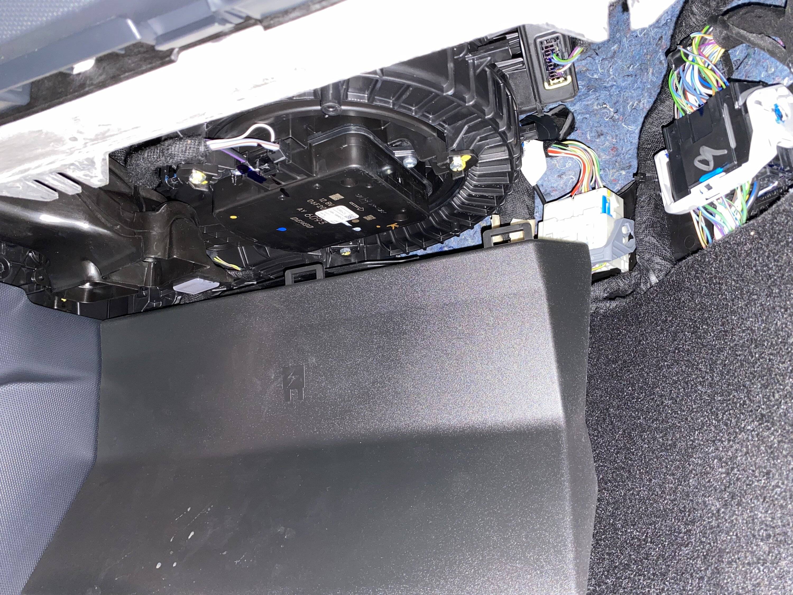

I can’t believe this is normal - see photo. Please tell me I’m missing a panel ? There are tabs in the front and back that are aching to have a panel attached to them. I’m a week into ownership. Of course I can bring it in but thought I’d check here first.
Update -
Talked to Ford customer service today and based on my conversation this is a optional component. (Part number - LJ8Z58046A25AA ) They said if it was not on the order, it will not be installed. I am dumbfounded myself since no one orders every single nut and bolt on a car, but looks like Ford expects customers to do so. This does point me in direction of thinking this was a cost cutting measure, since there is no Engine looks like Engineers at Ford believe that this component is optional.

That is disappointing. Not to mention, I don't remember this panel (or any other interior trim) appearing as an option when placing my order.

Correct, if you want one you'll have to buy it yourself, don't expect the dealer to pay for it. If the factory omits them you can't automatically assume it's a misbuild. Sounds like dealer did right and checked the bill of materials and determined it wasn't supposed to be part of your build. It is not something you can option when ordering the vehicle, probably a running change made at the factory.

My experience was totally different, part was ordered on Monday and it arrived yesterday. Picked it up and installed it right in the service lane. No charge, no complaints. Al Packer Ford in Royal Palm Beach. They had also said they had a GT on the lot with no panel, but didn't dispute that it should be there. The part number is LJ8Z-58046A25-AA, called 'INSULATOR - DASH PANEL'.
That said, I really wouldn't be too worried about this panel, it doesn't appear to perform any critical function.

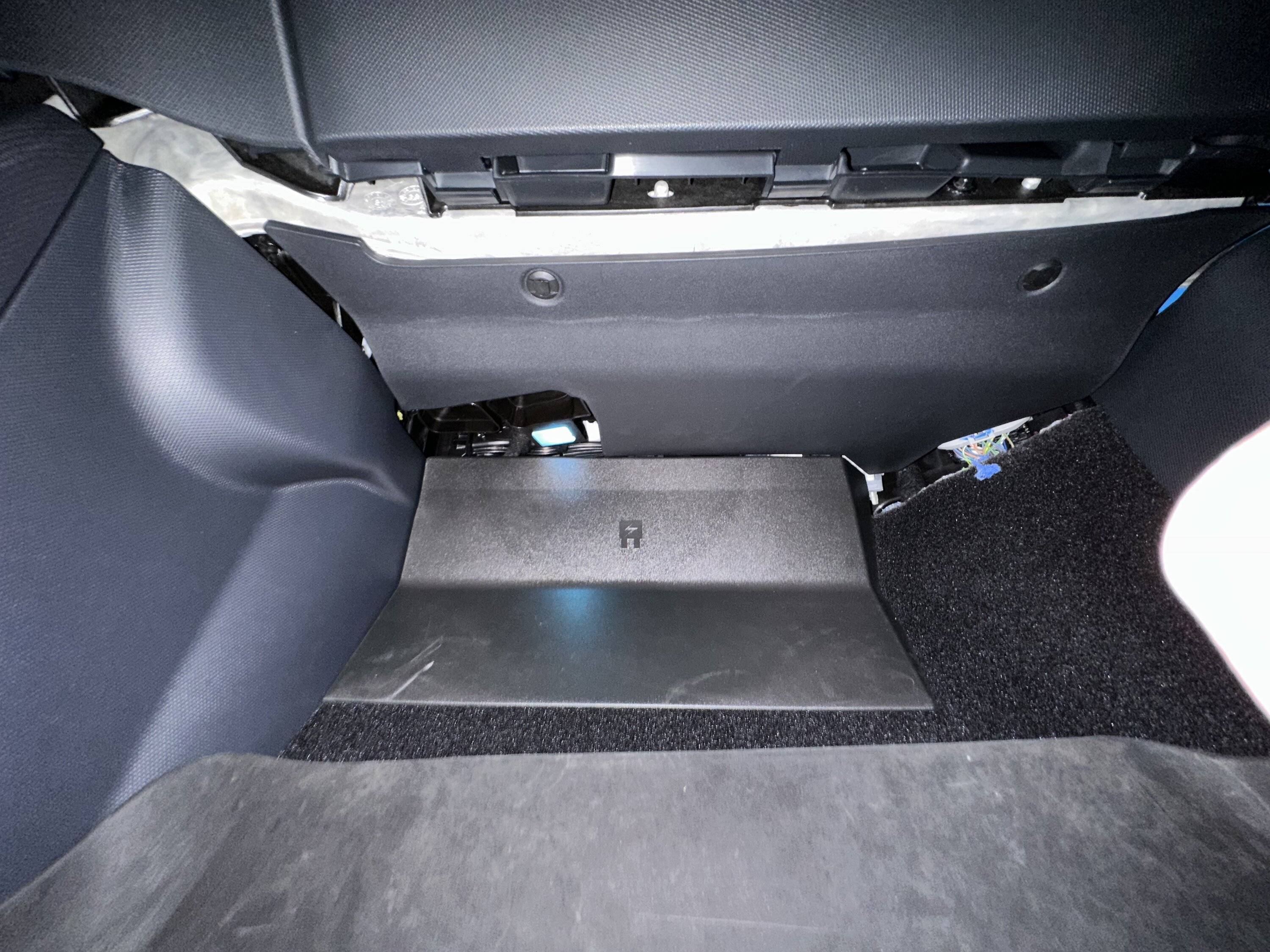

I got the replacement panel today and put it in. The dealer ordered the part from Ford and it was drip shipped to me. Took 24 hours from order to deliver and install.
Really easy to put in if the dealer doesn’t do it for you. There’s 2 tabs that slide in the back, then some posts that match up with holes at the front. The tabs in the back have some foam on them, presumably to eliminate any rattling. I had to push back towards the front of the car a little to get the posts to line up with the holes. Then I pushed the posts in and the clips (which came with the panel) popped in to lock it. The right one wasn’t locking at first, but it was because I hadn’t pushed the posts all the way in the holes first. Once I did it popped in no problem.
Here is a video of the install and an after photo.
