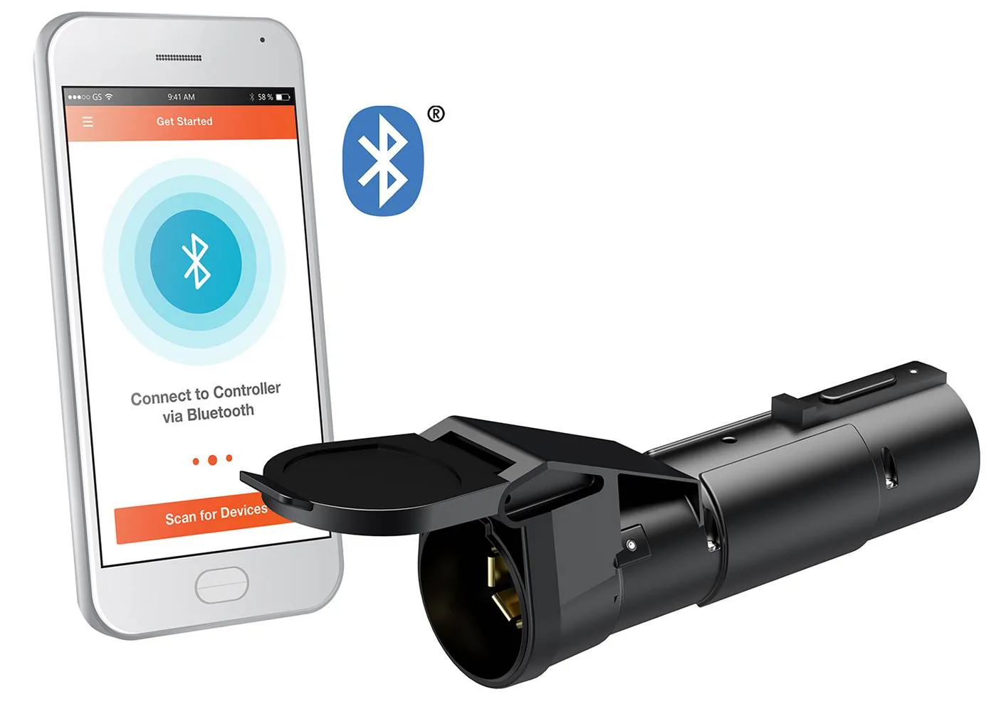

Since the Model 3 is not rated for towing, the Curt wireless controller was "likely" utilized as it is by several Mach E owners.
I use it... it is a surprisingly good piece of gear. However, the optional brake circuit to the 7-way connector's brake pin must still be present in the car.
