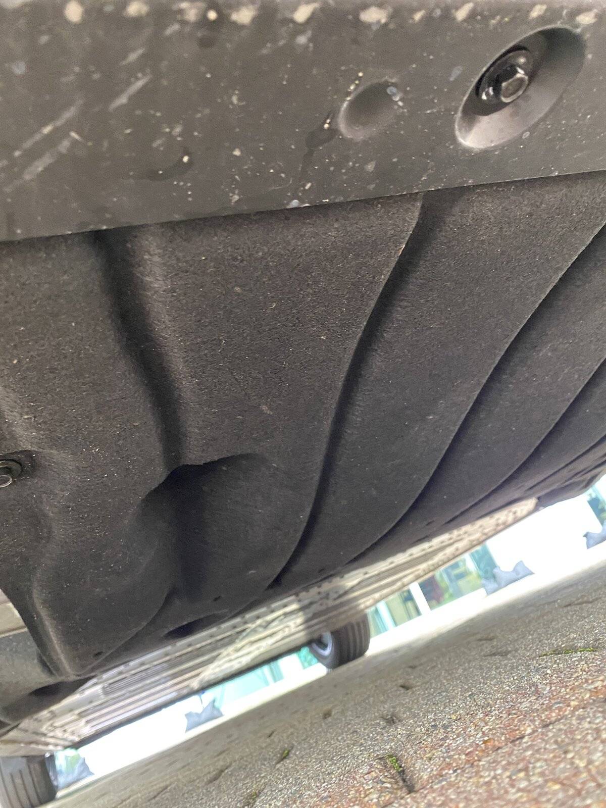

@guyofthesky i put an aftermarket hitch on my current SUV. But there were mounting points. I had to cut a small corner of plastic covering, but overall it was a simple job (with a couple tools bought or borrowed from friends).
My concern with the MME is that the bottom is all flush and covered.
I'd be curious if we can order the European hitch. Or even see what the European Hutch's installation instructions look like.
Here's the underside from the back:
