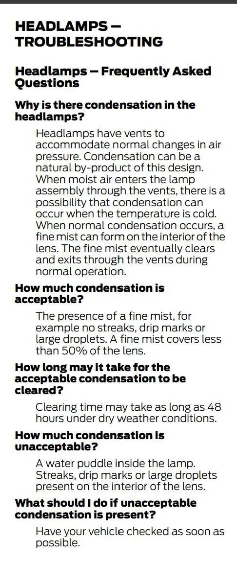

Just came back from dealer who got their dealer showroom Mach e . They are able to give test drive for 4 months and then they can sell. It has been rainy in Tampa for two days . I loved everything about the car but I noticed moisture build in the front headlamps. Disappointed. Anyone else noticed or anything can be done if your build moisture ?

nothing to be done. it's in the manual and is 100% by design in modern headlamps.
Ford Mustang Mach-E Moisture in headlights 1613779078924
