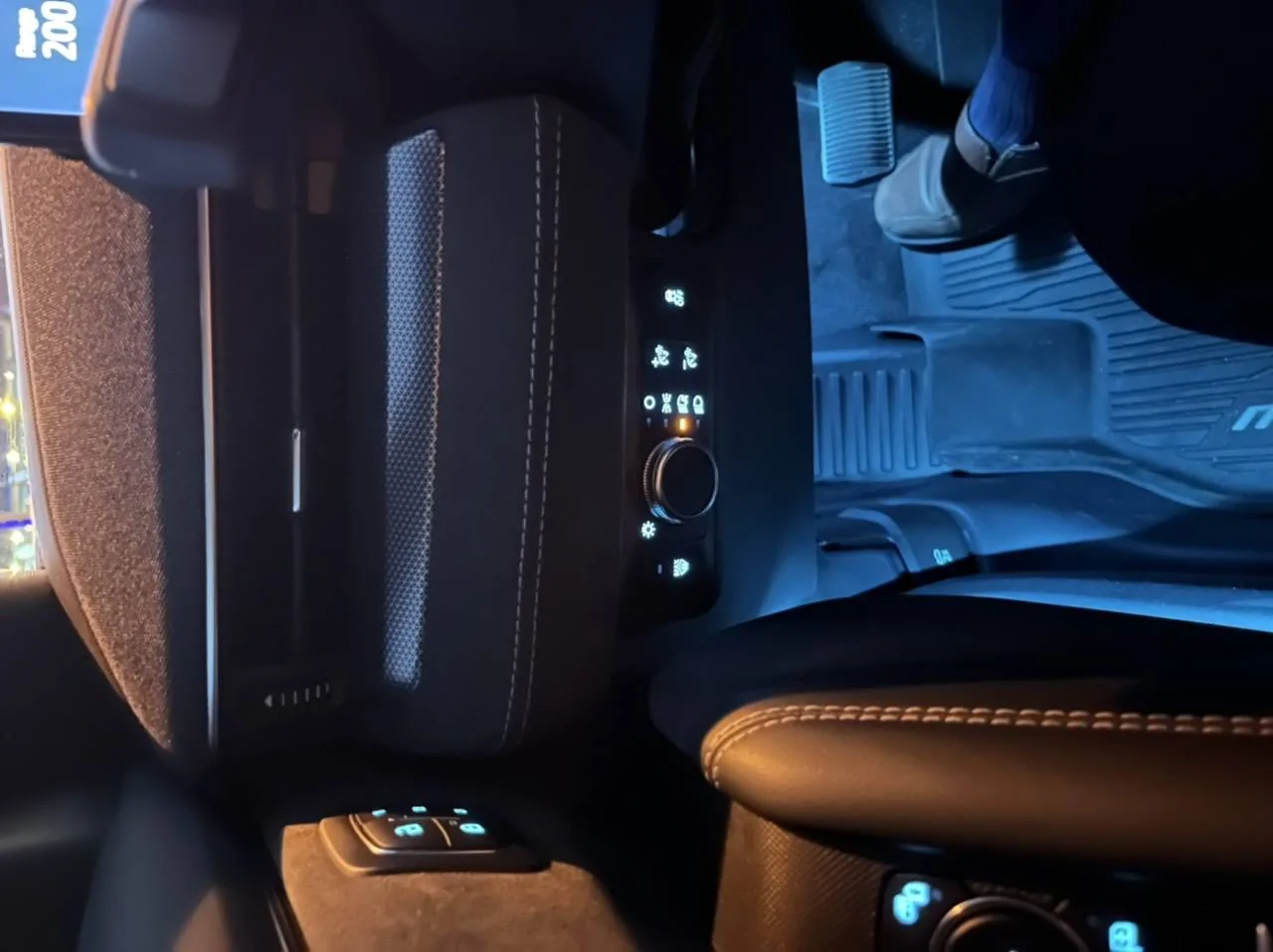

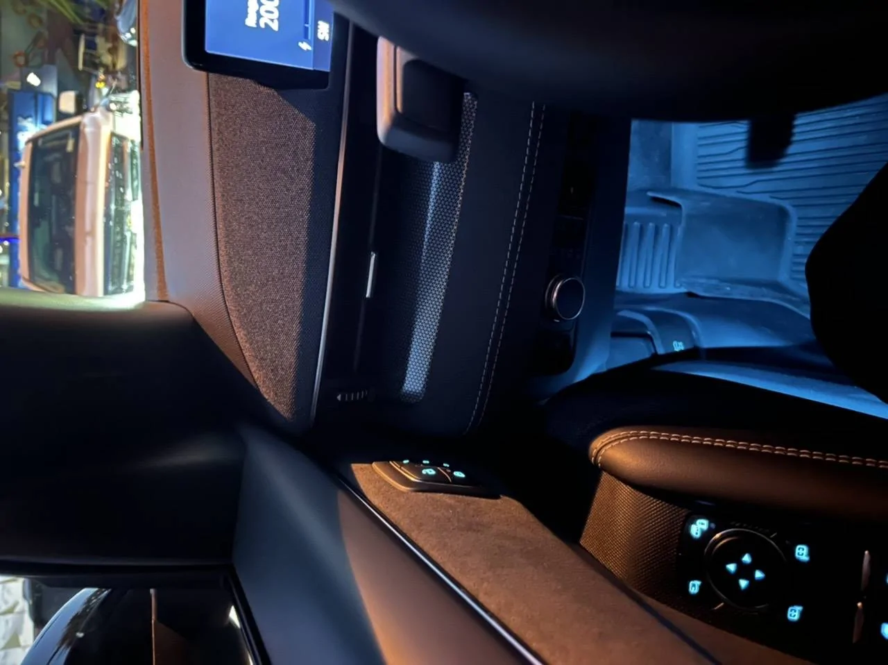

They can try the light switch, but supposedly there isn’t a fix yet.
FYI, it’s more than the switch though. When it’s doing it (lights staying on), NONE of the lights are lit up on the panel near the switch.
Looks like this:
Ford Mustang Mach-E Headlights stay on F0FA272D-4FF7-4355-8B05-8601DBE1F11E
Then when you set the switch back to auto, looks like this:
Ford Mustang Mach-E Headlights stay on 36E352AE-FEA4-4CFC-AE34-2C1C853E0969
