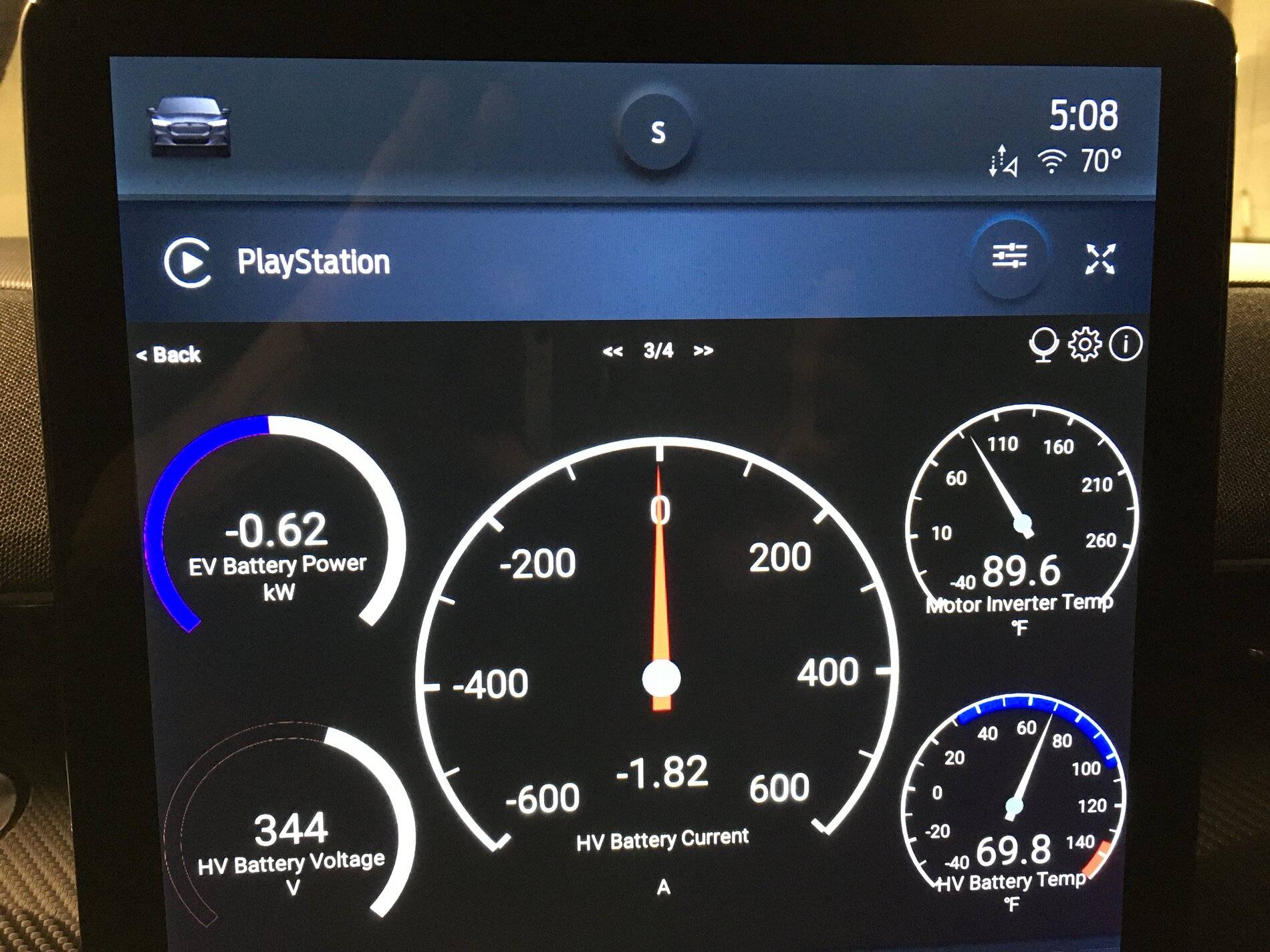

2) Does this show live when you use regen braking does it show on the app? Similar to like an RPM gauge?
the data ( HV volts/current ) is there, but requires just simple multiplication and display of resultant kW on instrument panel to be useful and interesting to drivers. Voltage changes a bit under load, so what we (drivers) really want to see is actual kW in and out of the HV battery and the interactive SOC in percent or even better in actual kWhr so we can make our own guess-on-range depending on what we are doing or maybe have been doing for the most recent 50 miles.
Just read about a workaround for multiplication of sensors in Car Scanner (voltage * current = battery power output kW). As I am on holidays now, not sure if it works at all:
in Settings *Sensors (Profile)
HV battery voltage / Role override: assign role EV_BatteryVoltage
HV Battery Current / Role override: assign role EV_BatteryCurrent
Then connect to the car, All Sensors should now include Hybrid/EV Battery Power kW sensor.

I got confirmation from another forum member that Car Scanner indeed shows Hybrid/EV Battery Power (kW), when you add "Role override" for existing sensors: HV battery voltage and HV battery current.
oohhhhhh, I'll have to give this a try!
Is the 'role override' set in CarScanner app, or on the MME console?
The next step is to cast display from phone to console. I have not tried to figure out Android Auto or what it takes to display any phone apps to the center console. If anybody can explain that step by step I sure would be interested....
I sure would like to see actual kW displayed on the actual instrument panel in a future update!

In Car Scanner app settings, the Sensors menu.
interesting indeed.... simply changing the labels enables access to the data... can't wait to try this

Hybrid/EV Battery Power (kW) upper left (car was "trickle charging" at 120v)...
super!
I will give it a go as soon as I have time....
would you consider documenting the steps required to get this to display on center console ? I am not familiar with Playstion at all or how to send any app display from phone to PlayStation in the car.
Just start with the first post on this thread to see what "PlayStation" is all about.

went back and read it.... not sure I can use playstation as I do not have hotspot for car or active sirius subscription.
I DO have hotspot on my phone. Can I configure car to use my phone hotspot? I just don't know anything about Playstation or how to display anything on the center console.
Playstation is the name the A.I. Box I plugged into the MME usb port calls itself. I don't know how to display Car Scanner on the MME without the box. You can, of course, see the info directly on your your phone or tablet with Car Scanner and a scan tool plugged-in to the OBDII port.
