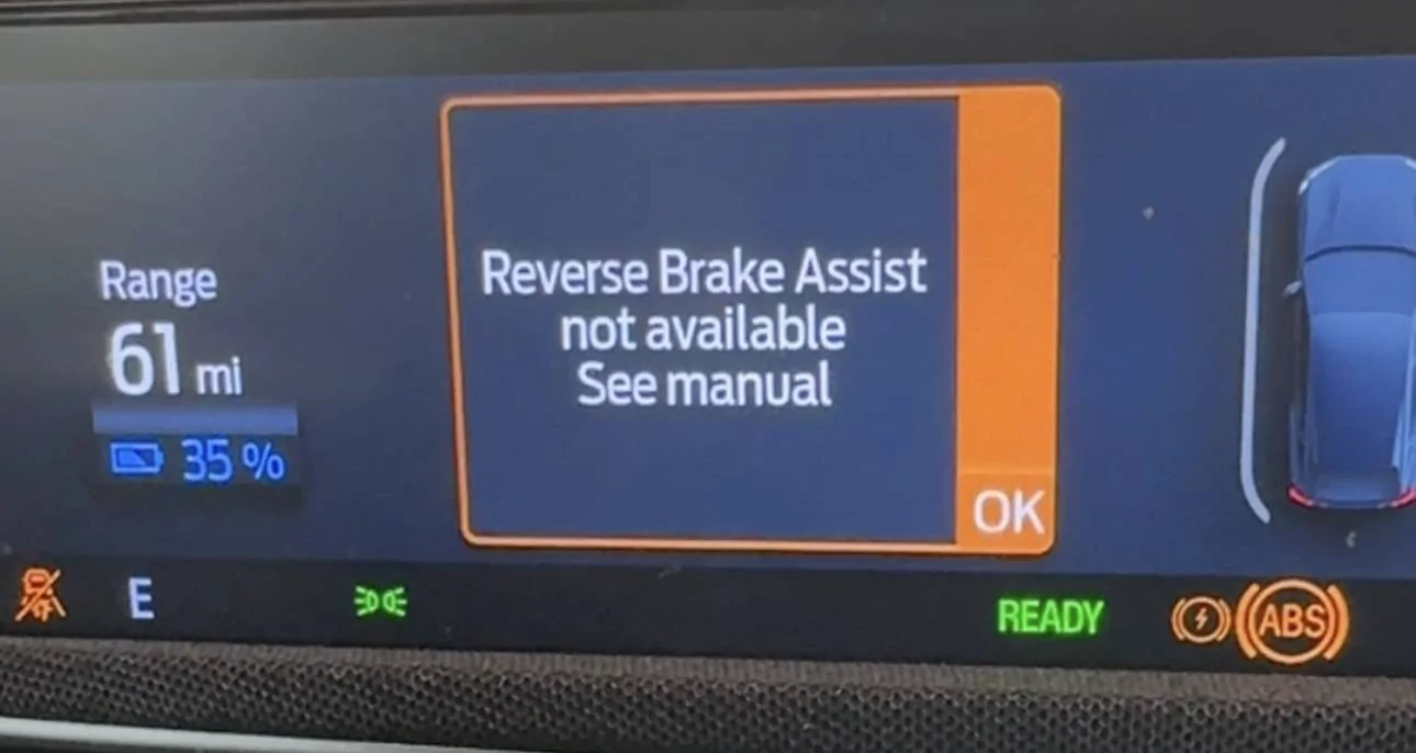

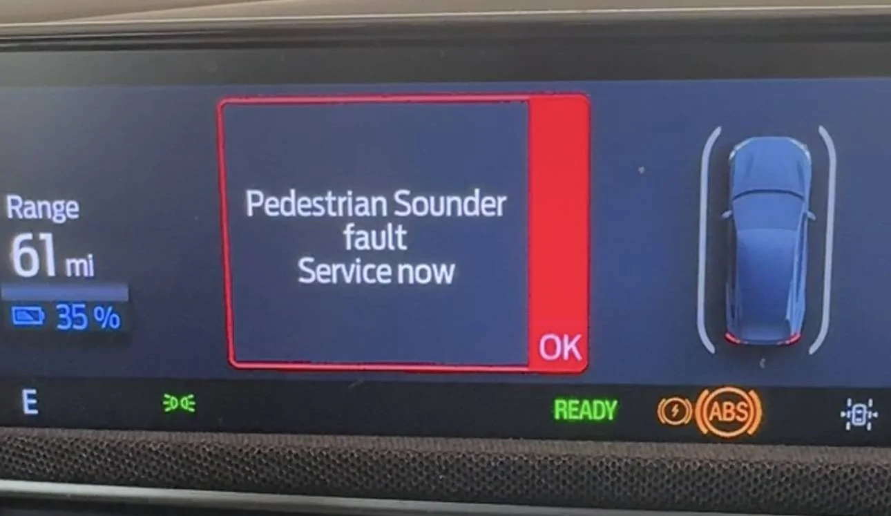

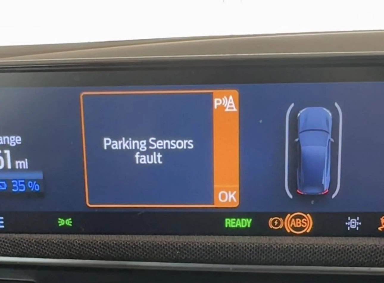

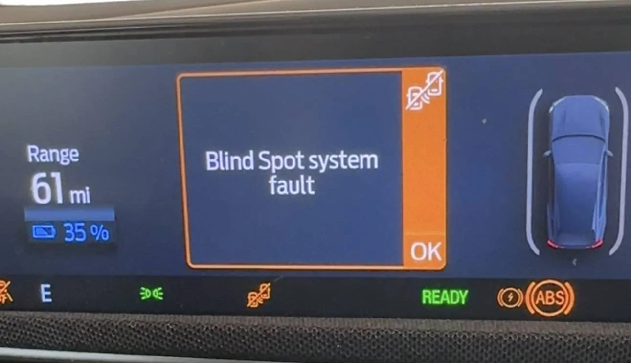

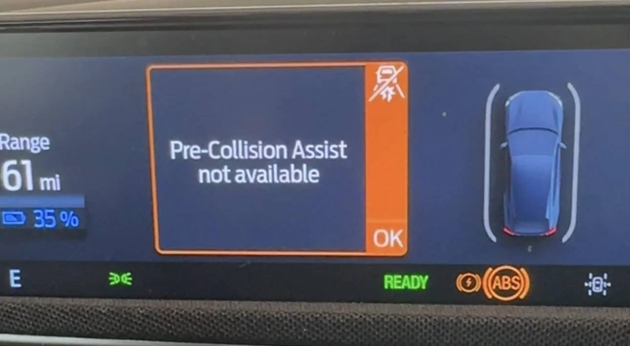

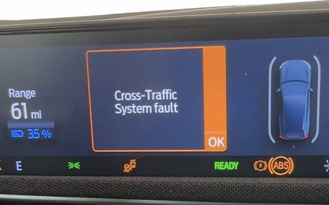

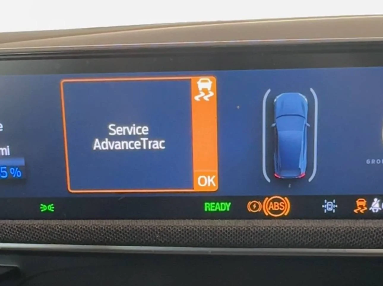

Hello Mach e Forum,
I have a 2021 Mach e Premium with 20,000 miles. I love my Mach e and have had a lot of fun driving it.
Today while driving, I started getting multiple error messages pop up on screen:
1. Pedestrian sounder fault - service now
2. Service AdvanceTrac
3. Parking sensors fault
4. Pre-Collision assist not available
5. Cross-Traffic system fault
6. Blind Spot system fault
7. Reverse Brake Assist not available - see manual
8. Advanced front lighting features temporarily unavailable
In addition, I have:
a. ABS - lit up on screen
b. Driving mode - can’t select any of Unbridled, Engage or Whisper
c. Steering seems tight
All these happened today, within a 2 minute stretch and now continue to pop up.
I tried a hard reset / Factory Reset, but it has not solved the issue.
I am looking for any suggestions to resolve the issue.
Please help. Thanks in advance. ??????

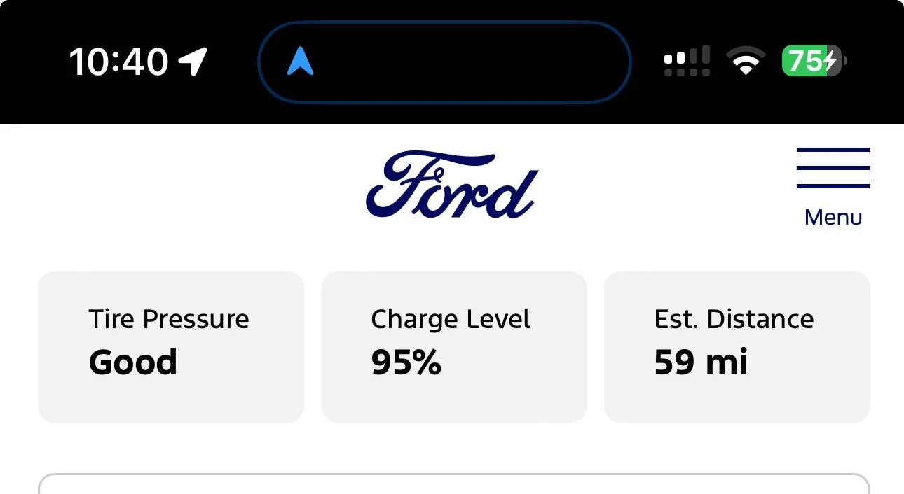

What is the status of your 12V battery?
267
17,902
27,858
Thats not your 12v battery level. That’s your HV battery
May be @Mike G can check your vehicle id to see the 12v battery level remote.
Share your vin
Since the car is at 35%, that is the 12v.

Go to Harbor Freight and buy the cheapo Viking battery tester $45.00 and you'll have one. Or. Go to one of your nearby auto stores and ask them to check it for you. Make sure you know how to expose your battery first so it's done correctly. (See Mach Lee's 12V battery write up here on the forum. Search for FAQ 32744 or follow this link. Make sure you start at the beginning. https://www.macheforum.com/site/threads/12v-battery-faq.32744/). Do not buy the replacement battery from the auto parts store, it will be wrong for your car. Get the Motorcraft BAGM-H3 from a dealer near you. Should be around $120.00 plus the core charge. If you are handy and want to change it yourself please read Mach Lee's write up or---- You may just need to desulfate your existing battery. I use a BatteryMINDER model 2012 and it does the trick. Again, read Mach-Lee's primer on the 12V battery.

Honda Clarity, MME on order
