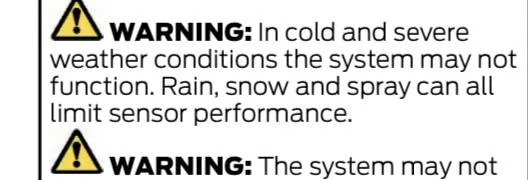

This warning appears in every section of the Advanced Driver Assist descriptions in the user manual. It’s still a car. If your visibility is limited, so is the cars.
