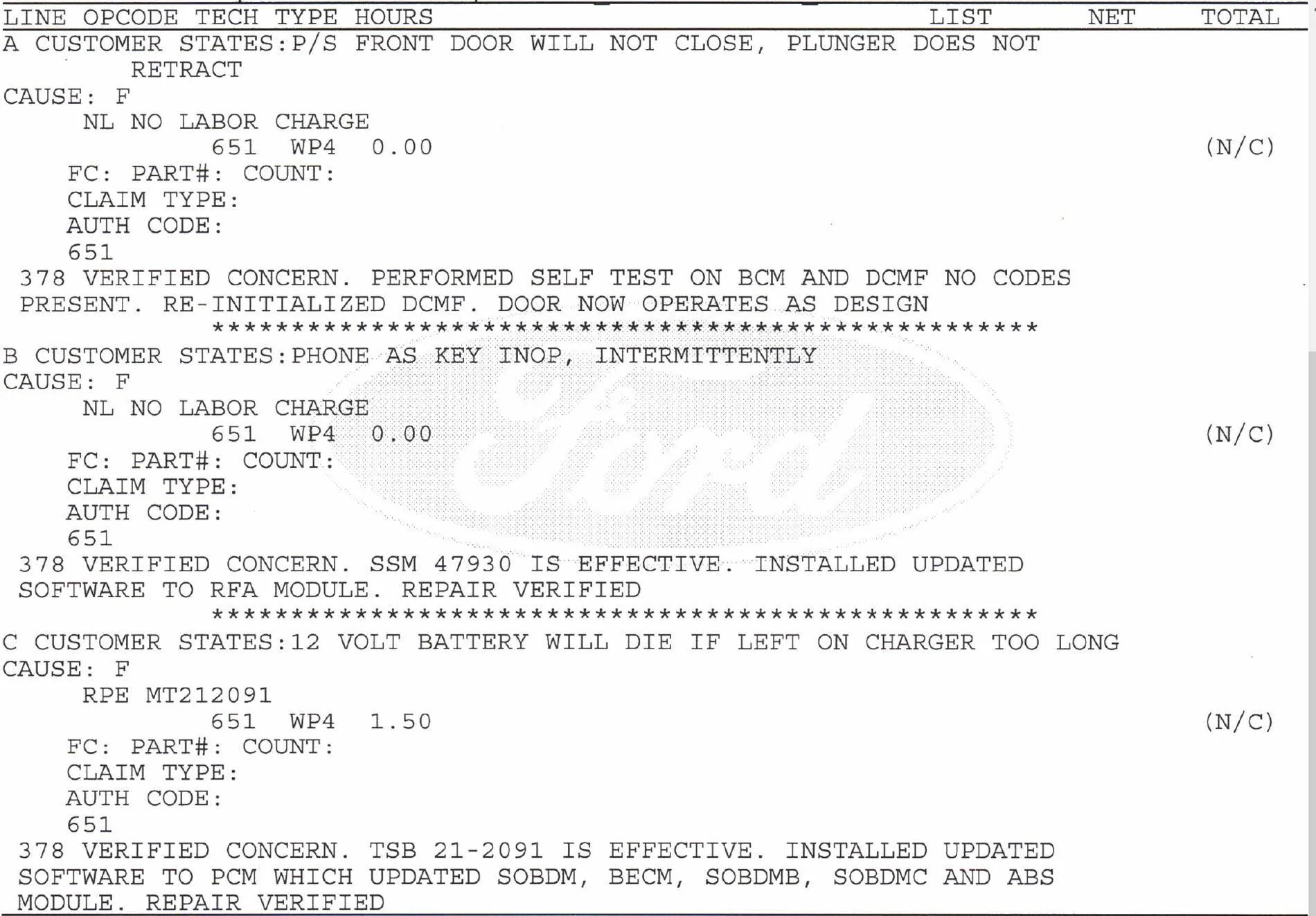

I got the car back today. They didn't replace any parts, but fixed the door issue by re-initializing the door control module. I'm not entirely sure what that means, but it's working now. I don't love that we still don't know what caused it, so can't guarantee that it's not going to happen again.
I also asked them to perform the SSM for PaaK and the TSB for the 12v battery concerns while they had it, which they did.
Reinitialized is auto tech speak for unplugged it and plugged it back in. ;)
Yeah, I was thinking it was really just a reboot. If I had gotten to the 12v battery to disconnect it, it quite possibly would have done the same thing.
