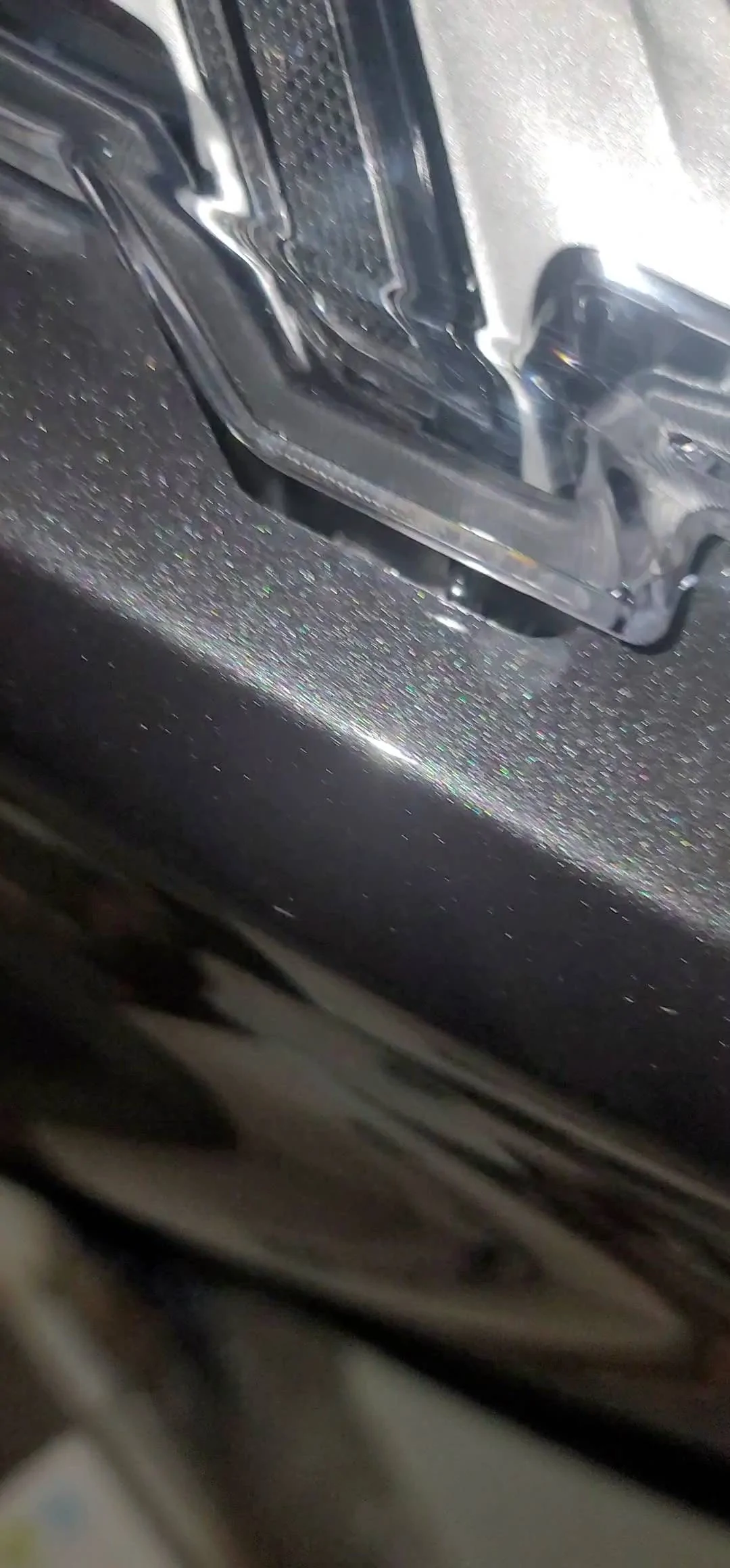

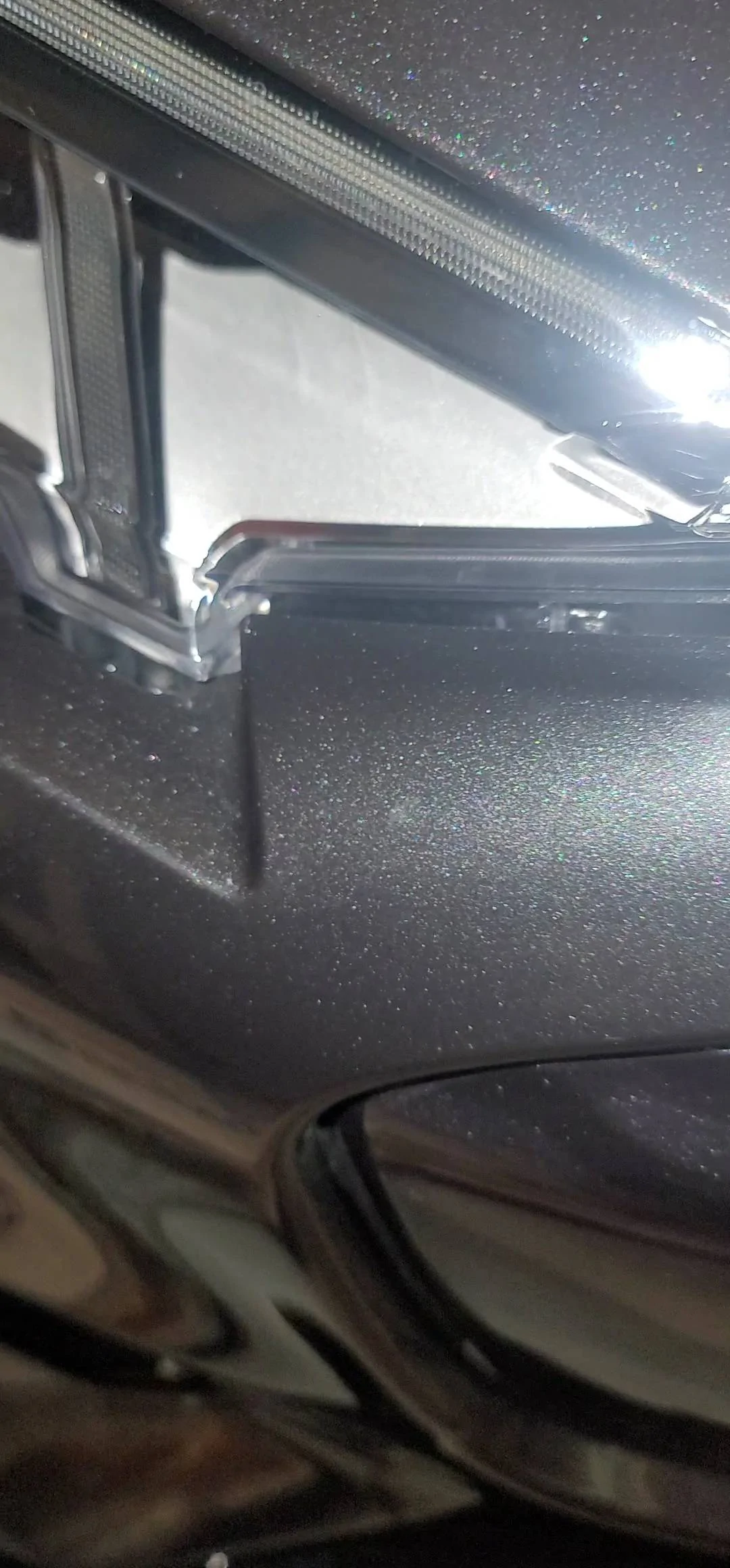

It can if you turn too much. Keep an eye on the lines.
Were the panel gaps affected at all? Thought about doing this, then thought it might 'break in'.

It shouldn't change the hood lines. You know why? Once the hood closed it should be at the same height before adjustment, unless you adjusted it one side more than another, and except there is no any pressure pushing the hood upwards when it closed.
