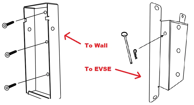

Rather than focusing on whether the EVSE is portable or fastened-on, which doesn't matter, focus on the GFCI breaker requirement, which does.
I agree with you that the requirements for fastened and portable are the same - I'm not focusing on that difference, I'm focusing on the difference between fastened and fixed, which are not the same. I'm not sure what you are objecting to here.
If you want to know whether the 2020 NEC allows a 32A EVSE to be plugged into a receptacle, or must be hardwired, then you need to know whether it requires a tool to be removed or not. If it needs a tool to be removed, then it must be hardwired, regardless of what the GFCI requirement is.
The reason I'm a little less worried about the GFCI requirement, though that is germane, is that you'd be more likely to get a part 90 exemption to the GFCI requirement by showing that the installation manual tells you not to install one. That is an area for AHJ interpretation (since other equipment could also use that receptacle), but guidance from the instruction manual of a UL listed product can and does allow for overriding some provisions of the NEC.
I'm willing to bet that the Grizzl-E's use of a cotter pin is a careful dance around the fastened/fixed distinction, allowing it to clearly fall into the "fastened" category and giving the homeowner more options, which is nice.

Okay that makes sense. I wrote to PGE and asked for more information. Let's see what Oregon PGE says. I sent them this link too.
PGE answered today. There are two reasons @DBC is correct as to reason 1, probably the most important one.
The second reason is interesting, PGE believes that according to 2020 NEC, a settable EVSE (EVSE with adjustable circuit amperage), must be hardwired. Presumably they are going for a fail safe approach, where if someone sets the amperage incorrectly, it will still be safe (although that notion of "fail safe" assumes the hardwire installation is for the maximum available EVSE setting).
PGE can set rules as they desire, but with respect, and for possible future rule making, both rules defeat important considerations. First those with a 240V outlet for the EVSE can have a spare EVSE to plug in, possibly including the Ford OEM EVSE with the correct receptacle, and also can unplug and travel with the same EVSE. Second the new flexibility of settable EVSE is defeated if they need to be hardwired, because the whole point as I understood it, was that you could buy one model (e.g. chargepoint flex) and set it for the circuit you have available, with some upgrade/future proofing kind of built in, especially for those initially running at one of the lower settings.
As far as I saw, PGE did not expressly say that the hardwire installation has to be rated for the highest possible settable EVSE amperage, so that could be a minor inconsistency in the policy, or maybe they just did not mention it in the email reply.

I think you could make an argument for some EVSE based on how they're mounted then. For example, the Grizzl-e has a mounting plate that is affixed to the wall with screws, but then the actual EVSE slides into place and is only retained with a cotter pin, so you could easily remove it without tools. Maybe this design choice was intentional for this reason?
Grizzl-E and Enel-X (Juicebox) have a similar mounting mechanism. It fits the definition of "fastened in place" and not "fixed in place." (ChargePoint & Tesla have "fixed in place mechanisms, with bolts/screws holding the unit directly to the wall.) Code seems pretty clearly to say that "fastened" requires outlets, while "fixed" requires (or can be?) hard-wired.
Grizzl-E has information in their system indicating that the unit can be hard-wired, by opening it up and removing the line cord. I've installed maybe a dozen units in this way, due to the GFCI problem. We're on the 2017 now, but it seems that in the 2020, this kind of mounting mechanism will *require* the outlet (1450 or 650) approach. I'm thinking, drop this brand until they come up with a "fixed" mounting mechanism.
