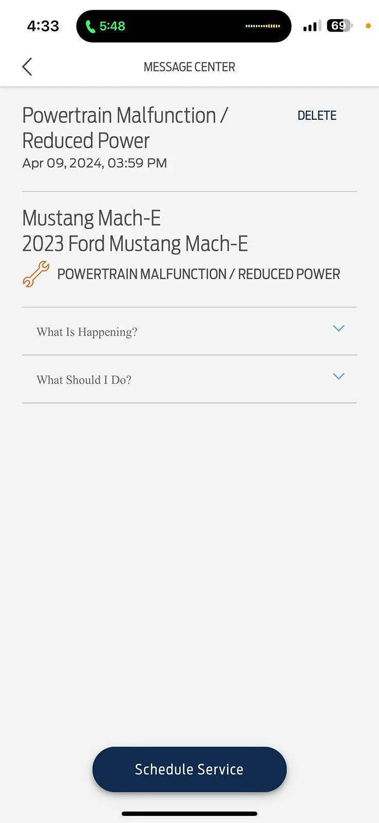

Hopefully not setting a new record for fastest failure but with only 4.5K kms it has to be close. Going in for service tomorrow, fingers crossed it is nothing crazy.
No fast charging / WOT since purchased in Feb.
To date I have experienced rear rotor failure (both replaced due to scoring and corrosion), ford pass infinite charge glitch and now this… whatever it is.
Love the vehicle and hope this isn’t a taste of things to come.

i had a similar(same?)message several months ago when leaving work. Drove home under reduced power. The next day it was fine, just a glitch. Hopefully same for you. Mine is 22 er awd premium.

that is brutal. It turns out that the error is coming from a faulty coolant diverter valve. Dealer advised of a lengthy repair with potentially faulty parts as Ford has not fixed the issue.
Looks like I will be in a rental for a while :( not the start to spring / summer I was hoping for.
