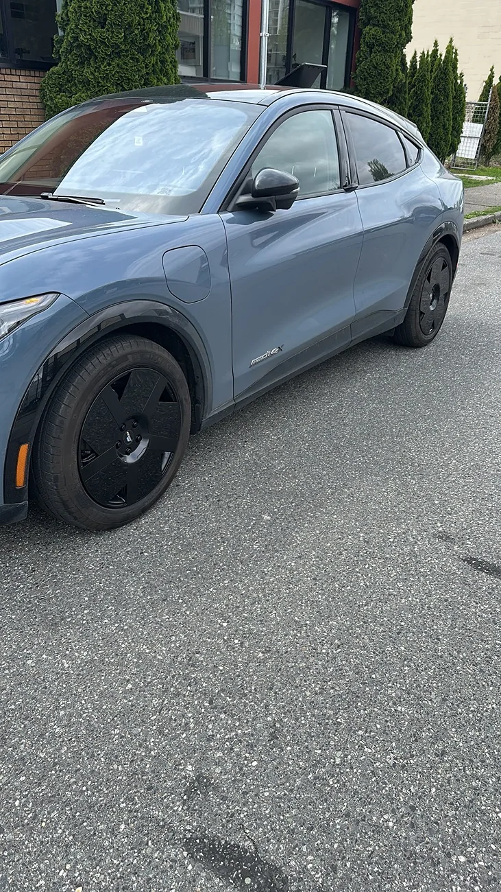

Hey everyone, just wanted to share a successful wheel swap! I decided to move my OEM tires over to some new rims and keep the factory rims for my winter set.
The Specs (For those wondering about fitment):
Fast Wheels EV06 (Satin Black)
• Size: 19x8
• Bolt Pattern: 5x108
• Offset: +48mm (Basically identical to the +47.5mm factory spec)
• Center Bore: 63.4mm
Bought new motorcraft TPMS-35 synced up no problem (315 hz)
I have some summer trips coming up will let you know about efficiency I’m not expecting much maybe 20kms? Not sure.

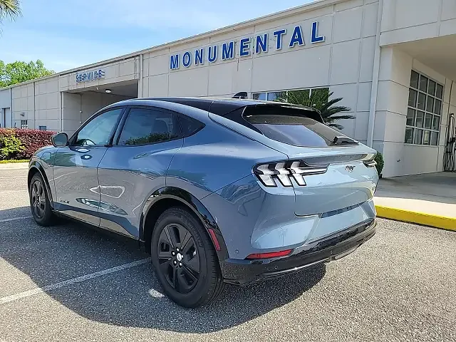

Looking good 👍 !
They remind me of the Black Rally wheels.

I like, they remind me of the California Route 1 Aeros (which I have never seen in person...)
