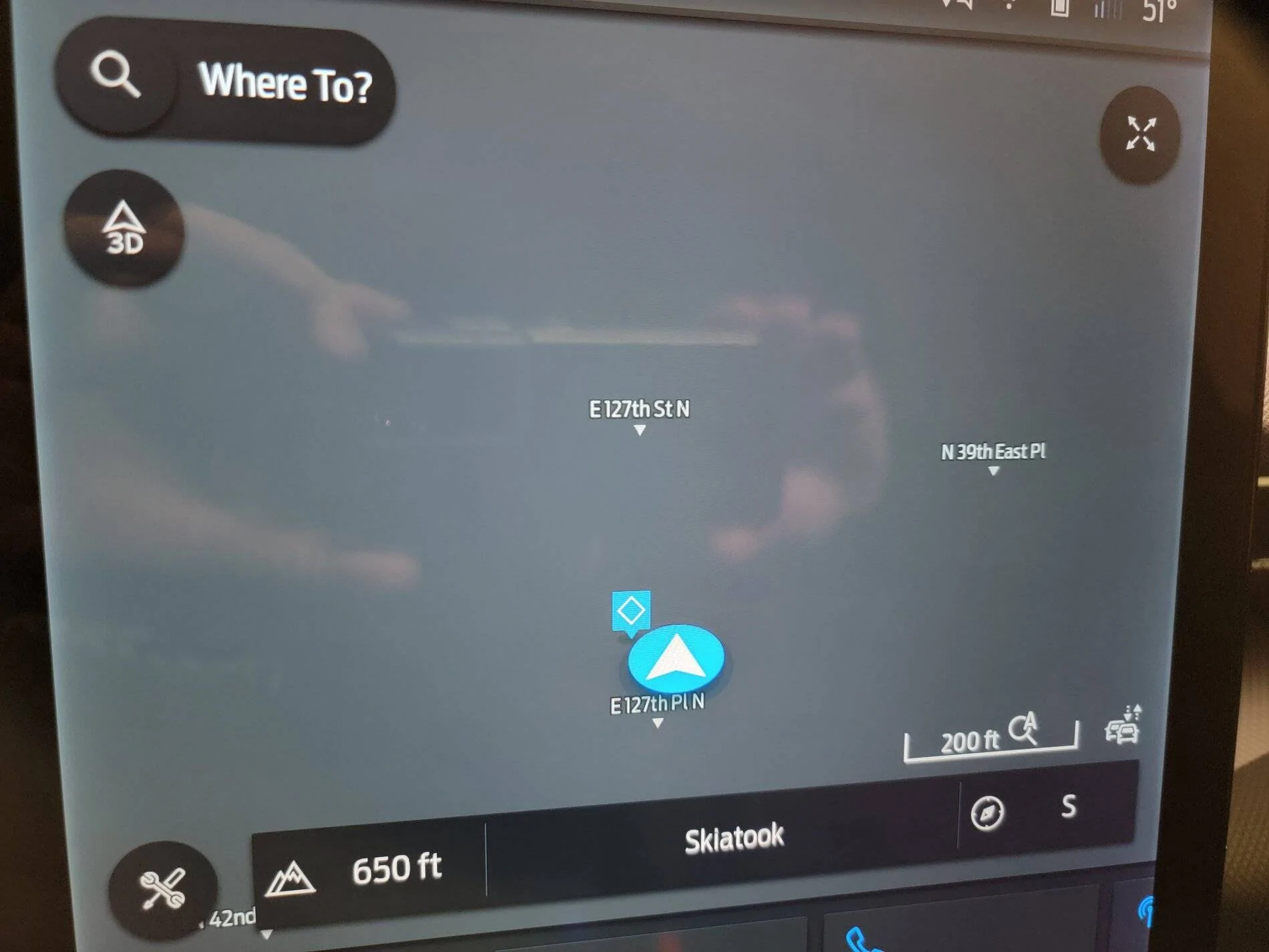

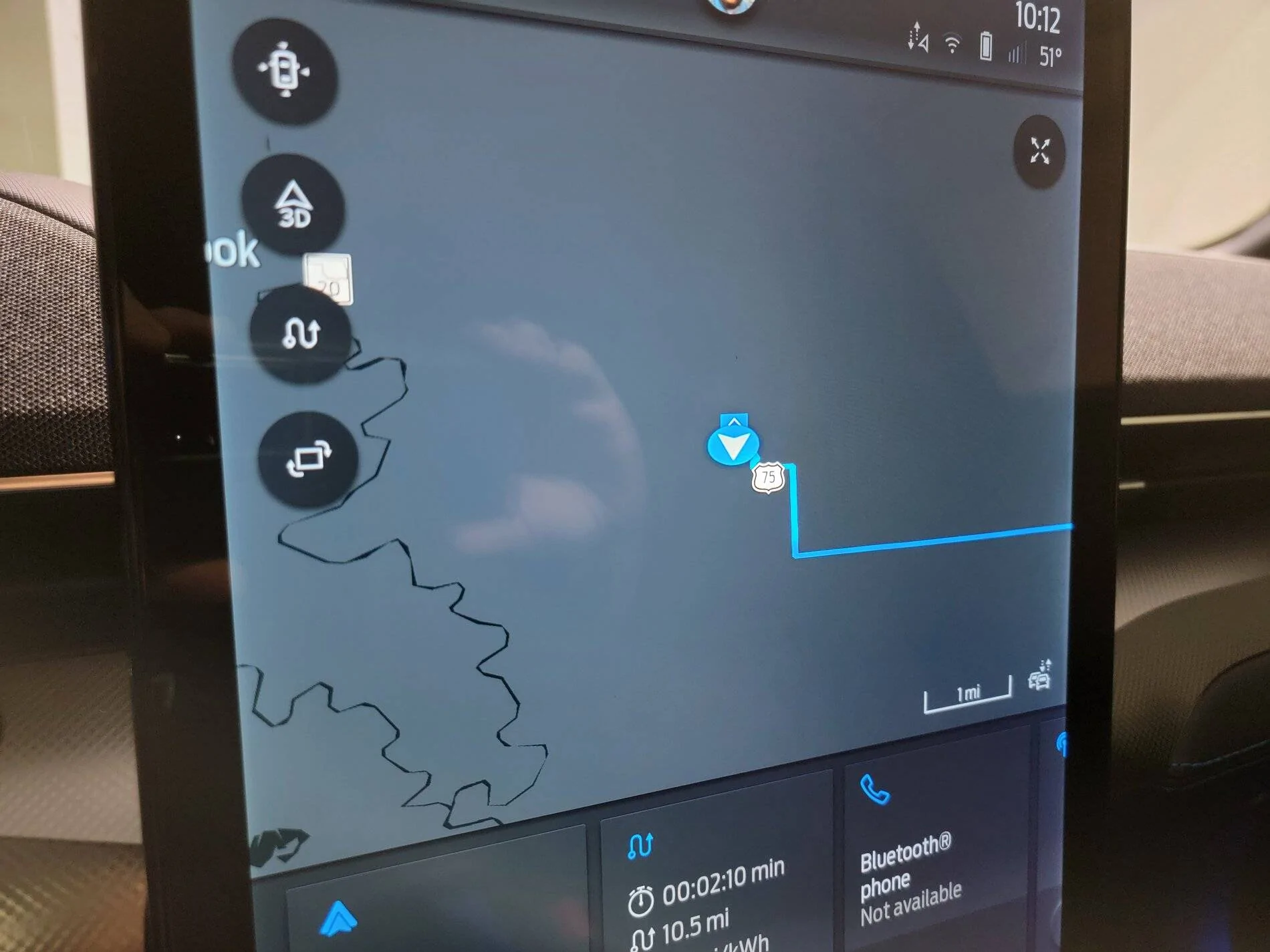

My car has the navigation, and it works, but the maps are blank. I have a service appointment finally next week for them to investigate. I suspect the APIM just needs reflashed, or the map files re-installed. Which is all something I could have done myself with Sync3 all the files are available to do that.
Once I get any progress on this, i'll update my thread here:
https://www.macheforum.com/site/threads/nav-not-showing-roads.4365/
Here is my view. The base map is there, but the street level is missing.
