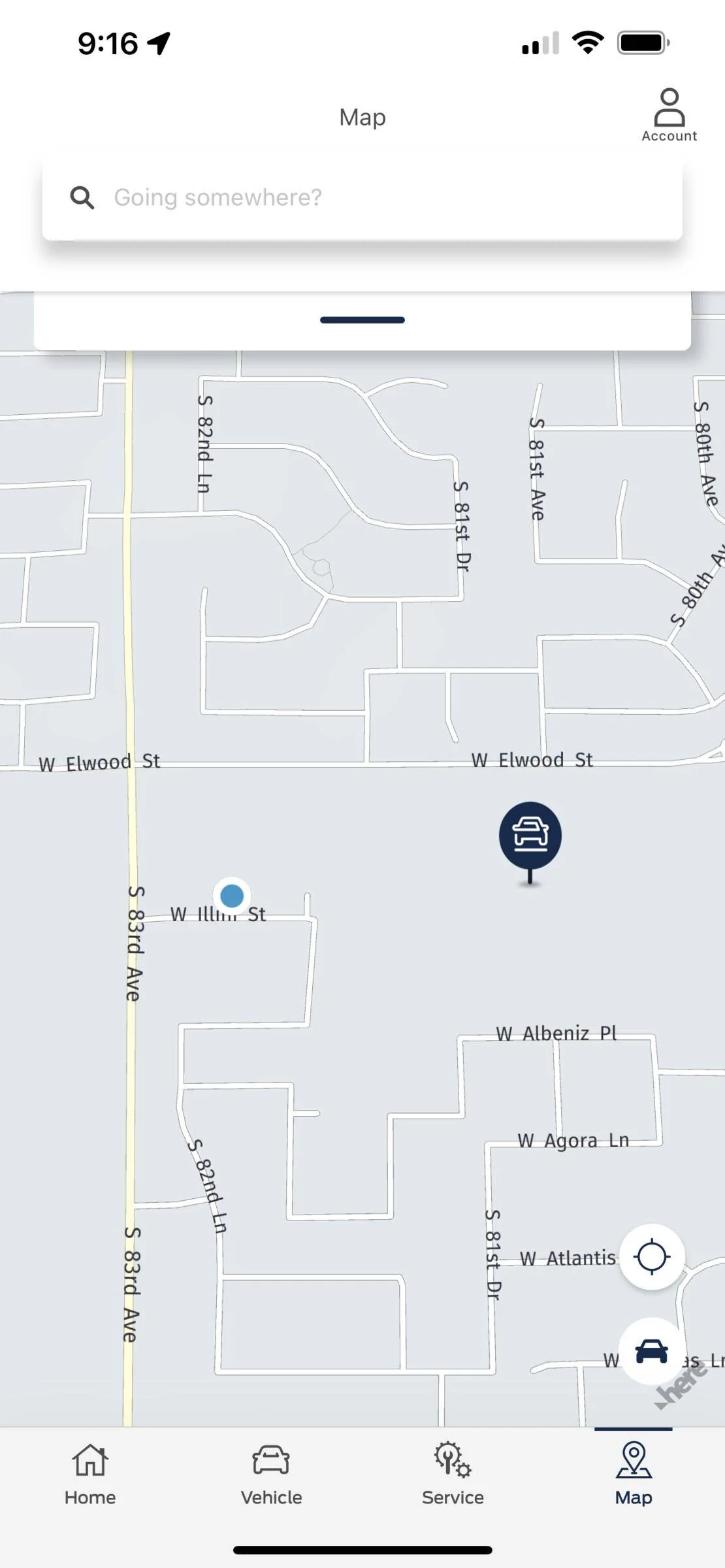

Here is an screenshot os the Ford Pass App. I’m inside the Mach-e and you can see how the app, also the Nav System, shows the car streets away from me.

You might have something up with your GPS antenna. I've had odd issues which have almost always involved "last mile routing," meaning I can drive 90 miles successfully with the navigation system, but in that last mile to my destination, it takes me to the wrong location (one of which was even a charging destination). I have not, however, seen gross deviations like you're showing. I'd see about getting your Sync reflashed first, and if that doesn't do it, have them check the actual GPS antenna for issues.
