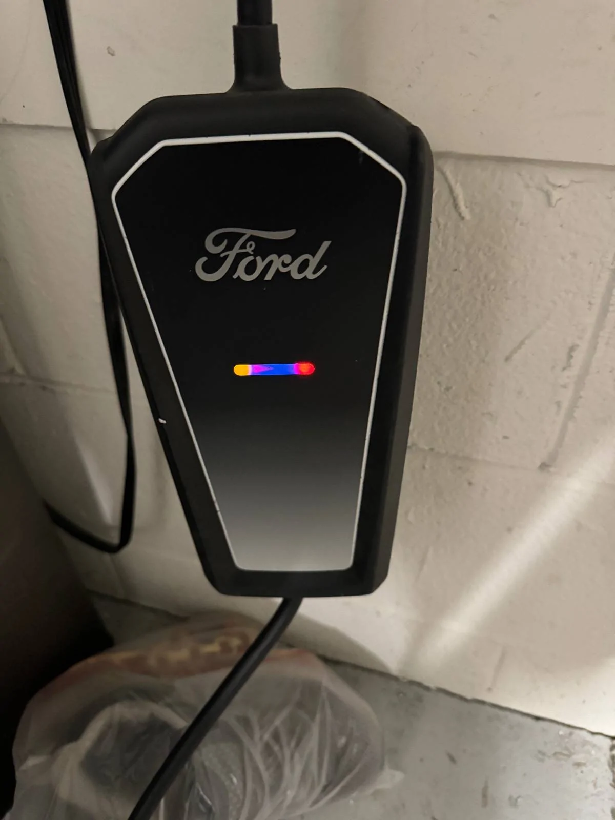

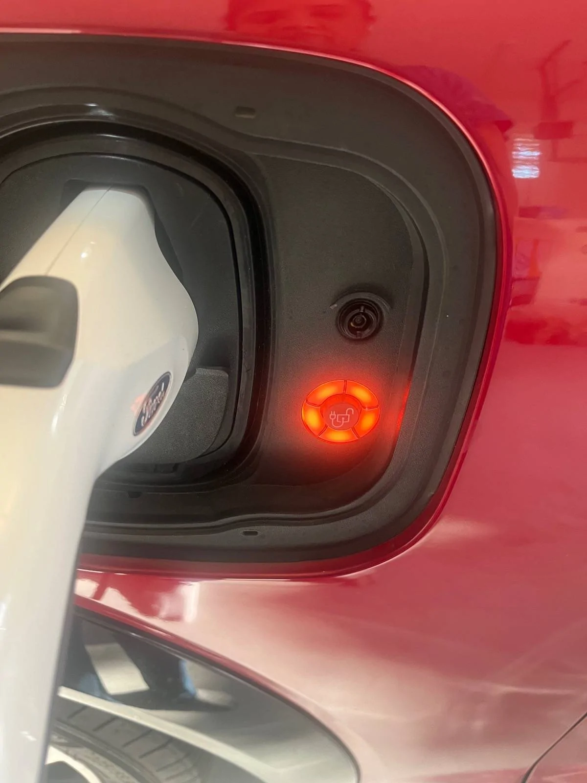

Need advice while charging i am hearing a sound on the charger and changing from blue color to yellow blue red and the car charging indicator to red please advise

Your charger is likely bad, many posts on this.
Unplug charger from car, then wall. Plug it back into wall. If light is blue, plug it in to car. If not, look up lights in manual.

Unplug from wall and car. For 1 min. Unplug and reset plug into top of charger and make sure it’s seated all the way during this time. Then plug back into wall charger should be blue if blue plug into car. If charger has red color. Don’t use and take to dealer or get a better charger , the ford charger is a POS.

when unplug and plugged back it is blue and when i plugged into car its making sound on charger and charger is turning into color as mentioned in the picture.I have ordered
Wallbox Pulsar Plus Lv 2 EV Smart Charger - 40 Amp NEMA, 25’ Cable. hope this will resolve the issue.

As mentioned previously your EVSE is most likely bad. I would also suggest inspecting your 240V outlet for damage. Also do you have the ability to test your L2 charging at a public charger to verify it still works elsewhere?
