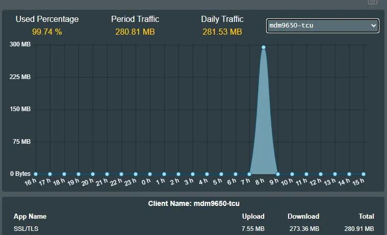

Interesting piece of info here when looking at my router. Seems like around the 7ish time frame my car connected to the wifi and pulled down 300MB.
One would assume, maybe even hope, that the car would pick times to do major updates based off usage history. Whelp, I can tell you it doesn't... I take my kids to school every day, I leave the house anywhere from 07:25 to 07:35. Yet it appears as though the car is like "Hey lets start a major update download during this 1hr 20min time frame that we know the owner will be using the car".
Granted, who knows when the car actually initiated the actual install of 1.7.1, this could just had been prep. But given the car is experiencing issues of 1.7.1 install AND I received a install error message at 08:35 this morning one could easily conclude the car started the update around the time the data was pulled down.
Ford, you are doing yourself NO favors what so ever, you are setting yourselves (and the consumer) up for failure.. Why start an install during the morning commute time!?!?! Then you wonder why so many people are having issues with the 1.7 install. I just can't...

Seems like best plan is to turn off automatic updates and just require a confirmation to start install or let us request the dang update!
