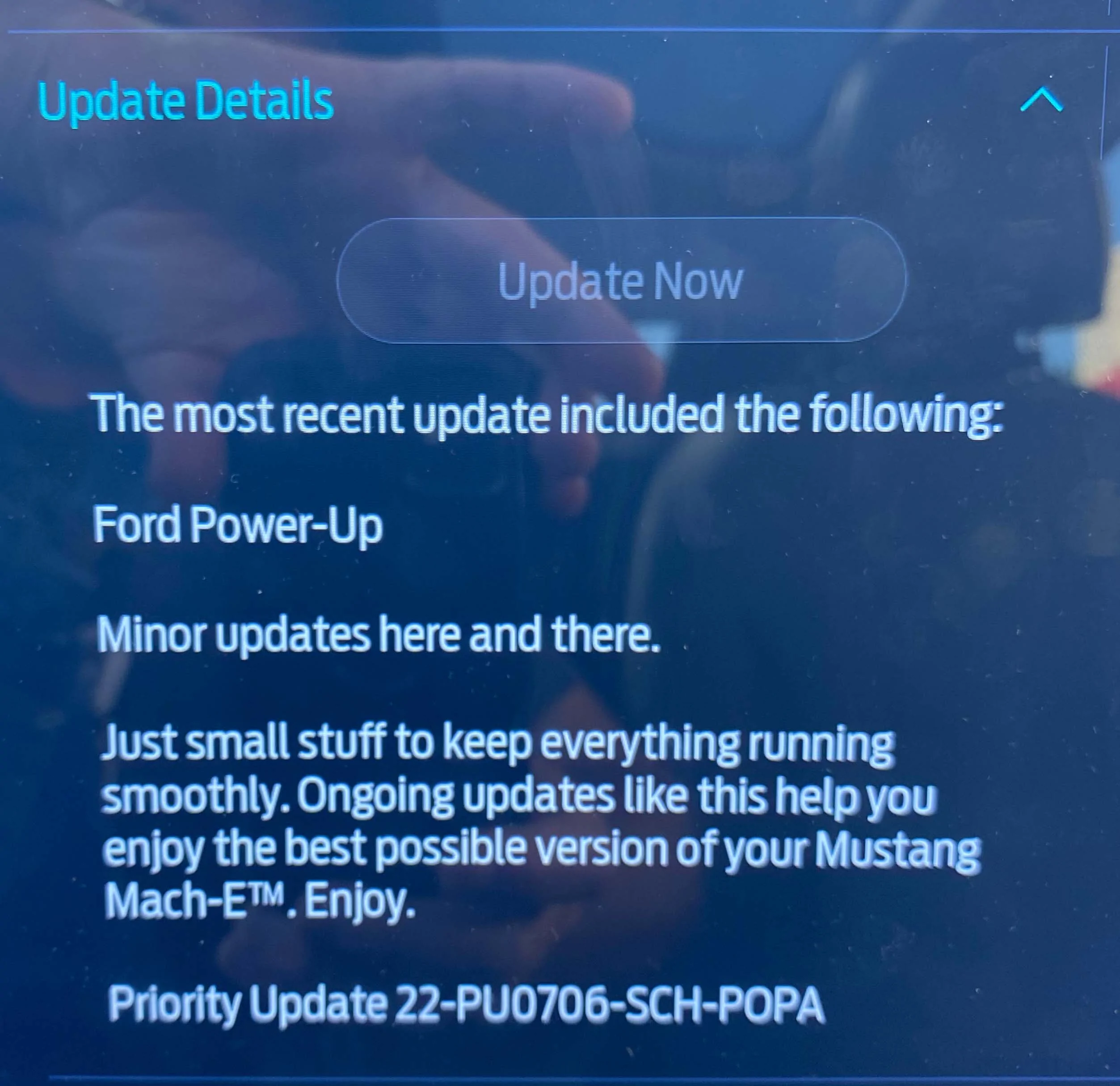

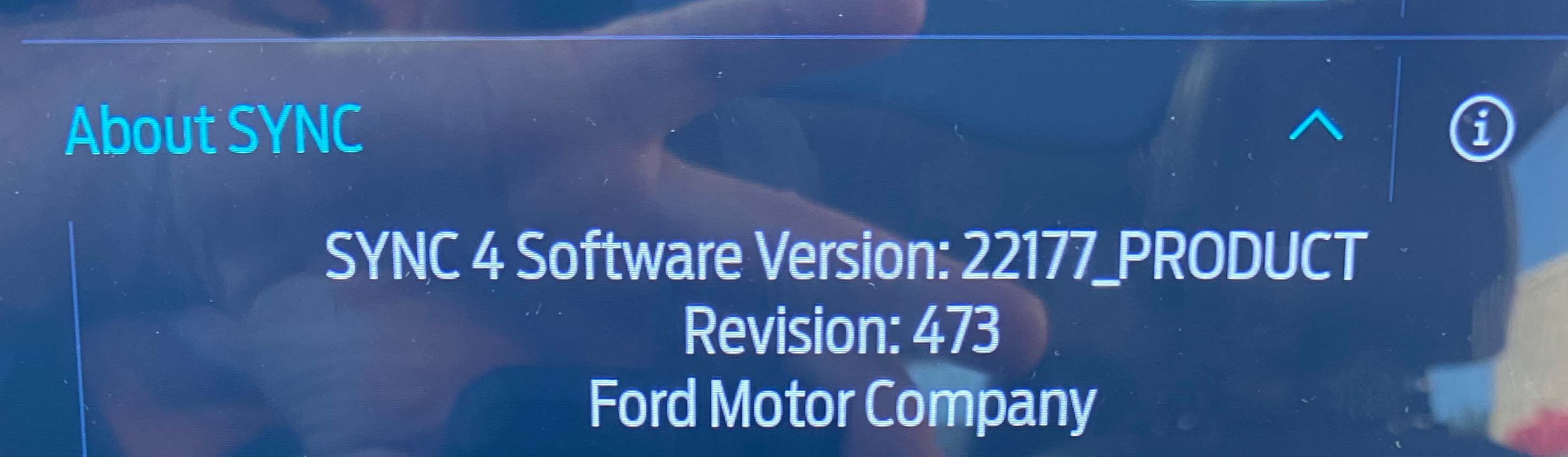

Try going for a drive and parking in a store parking lot that has good wi-fi can help. This was not a minor update for me. Was stuck on 2.7.1 since may with Sync4 22087.415 and it updated to Sync4 22177.473 which is above the sync version of the 2.8's and BCHF. Still do not have BCHF but at least the brain has updated which gives hope.
i'm in the same exact boat. i have wifi at home, i've done 2 different 4 hour drives, refuses to download

I got the same one. Sync version 498.

Sync is now 22192_PRODUCT - Revision: 498
My update 22-PU0706-SCH-POPA
Sync4 22177.473
Different update? Nice they stopped any resemblance of a logical numbering system. None of the 2.8's hit here and it has been stuck on 2.7.1 since May until this one. Got 22-PU0727-VI-FXA the day before but that did nothing. Have to say it seems to be more responsive here and ui is more snappy. Hoping it does not get confused again in 2 weeks. Nice that updates are still possible.

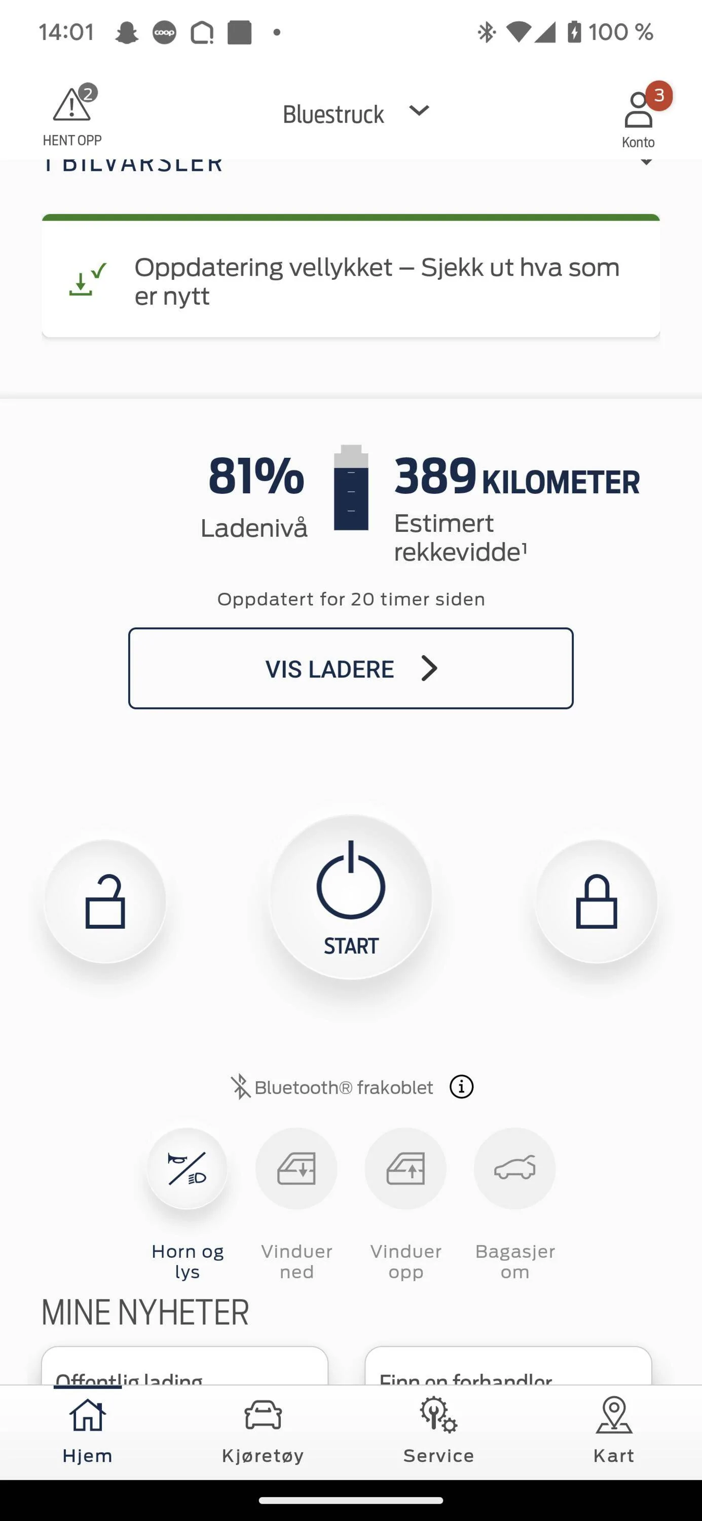

This update has been queued for me for almost a week but doesn't seem to want to install. ??
So the expiration date passed with no notification that the update installed.
Turned it on this morning to head out and was greeted with this:

This update updated Sync4 to 22177.473 which is confirmed by you. I presume you do not have BC yet also. Hoping it is not another 4 months until we see the next.
