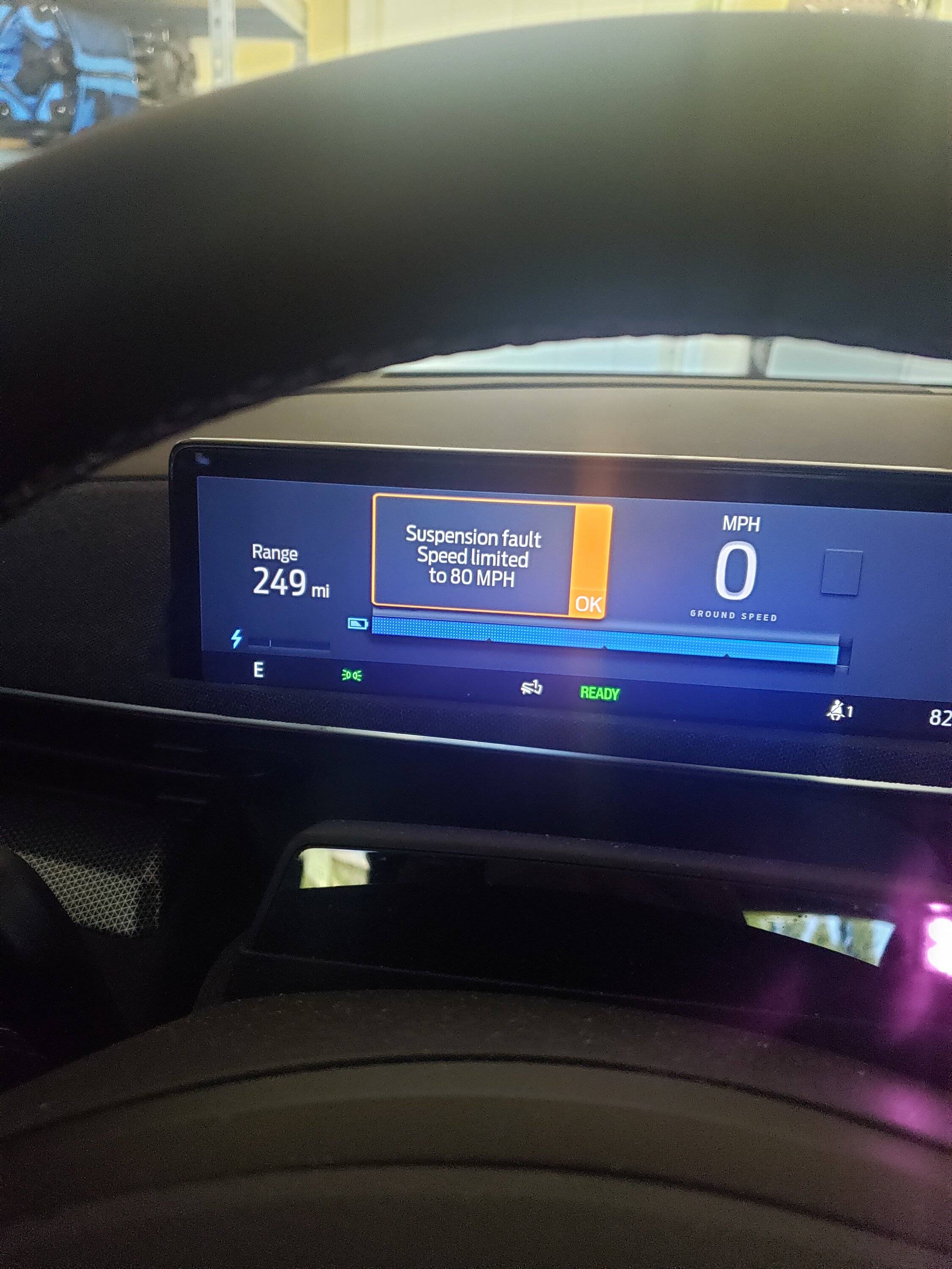

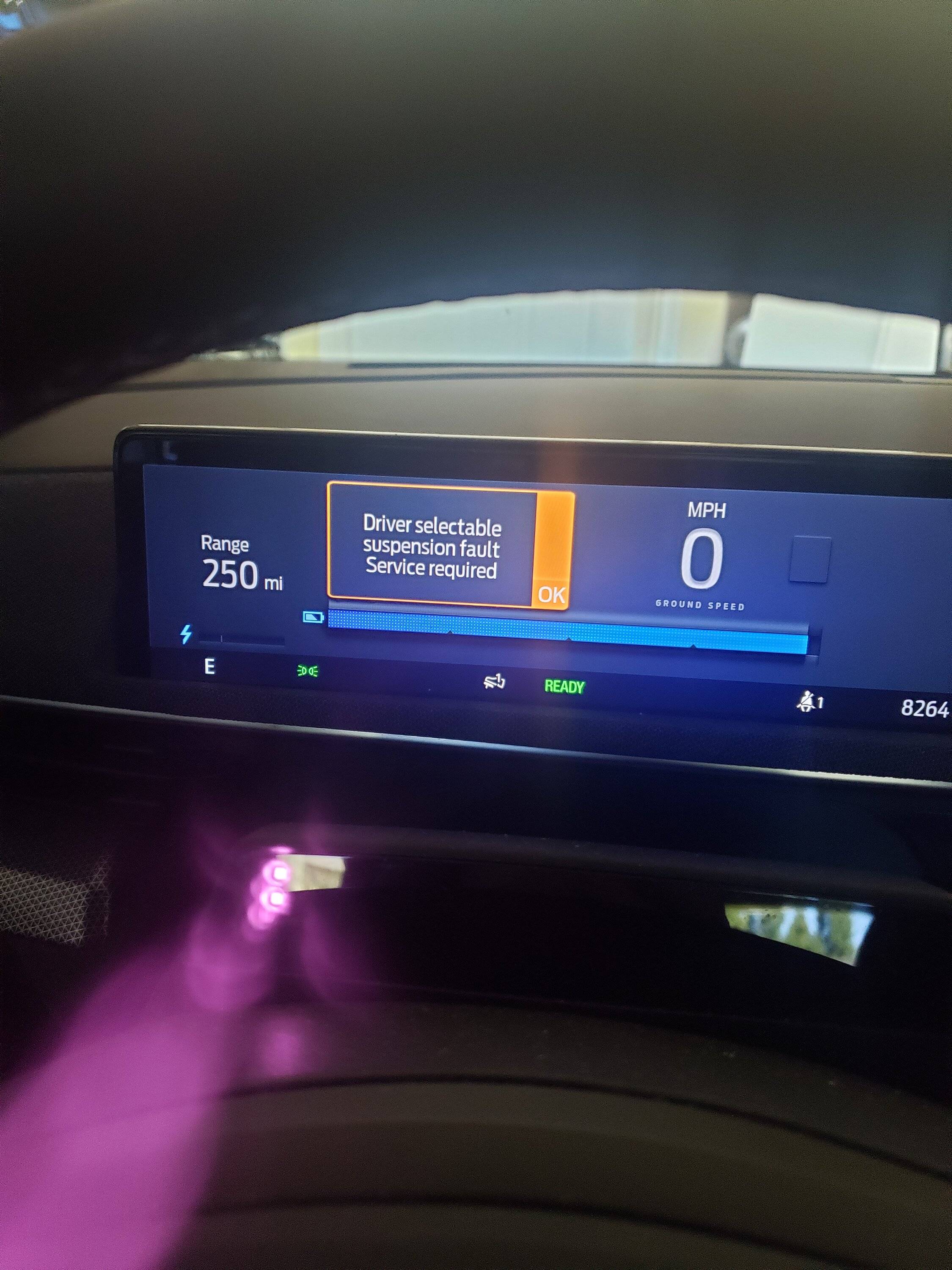

I just got this update today.
OTA Priority Update 22-PU0707-SCH-POPB
So, I've been so lucky until now. This update has done all kinds of strange things to my MME-GT/PE.
To start off i can no longer change driver modes. They all say they are not available.
I am also getting service soon and user selected suspension errors as seen in my pics. I've scheduled an appt with the dealer. Hope they can get this sorted out.
After updates the car can get a little funky. I'd restart sync (volume down, next track button) and then let it sit for a while, preferably on a charger though I doubt it matters, and then drive it around and usually you're good to go.

My GT-PE threw suspension errors after I installed my Steeda anti-sway bars. A Sync reset fixed that. Give Vol-Down + Next Track a try. ??
I got the same OTA Priority Update this morning with no change in my car’s behavior.??
Dammit Neil. You beat me to the reset. ??
