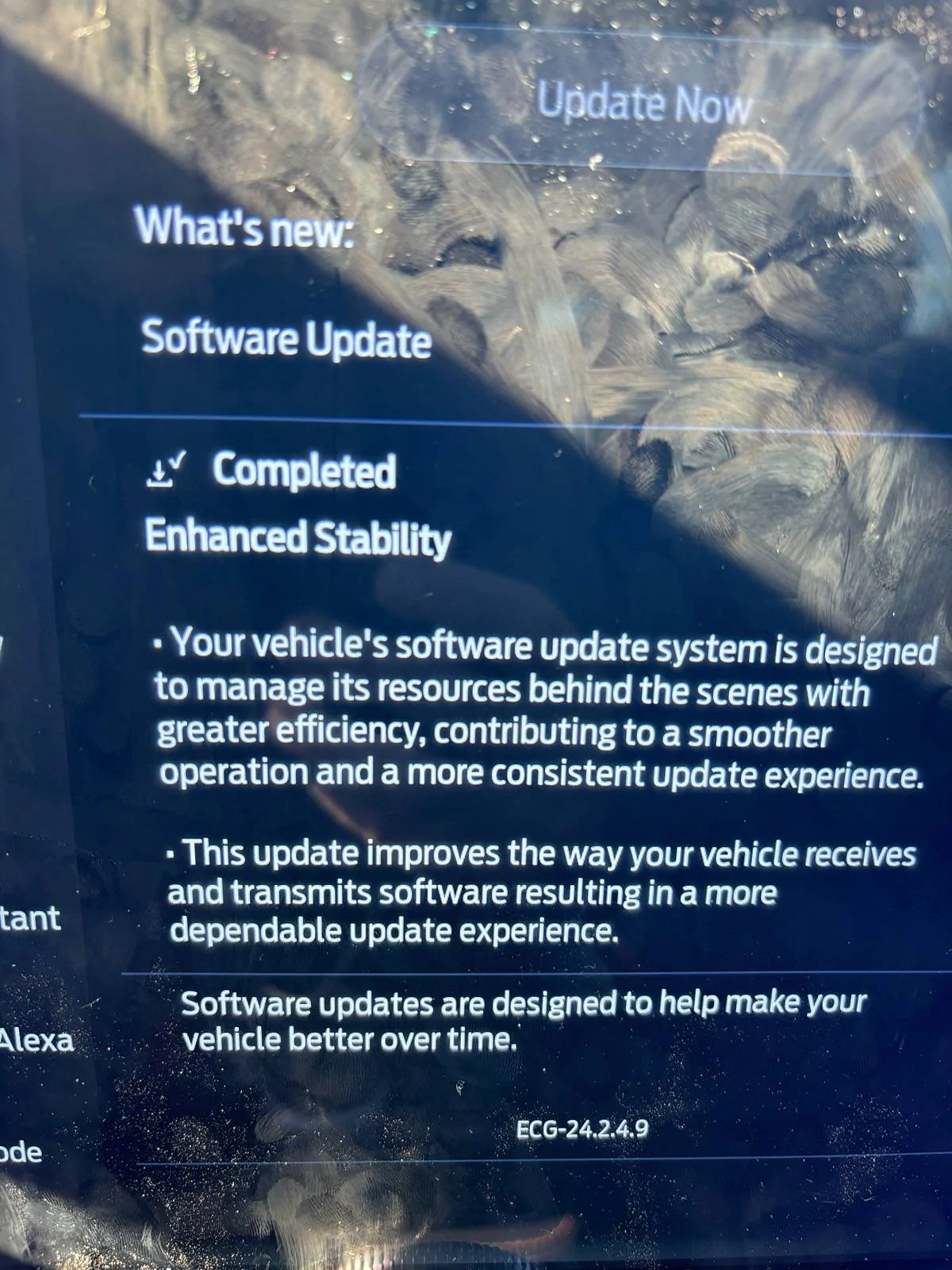

2023 model here... got the EG-24.2.4.9.1 Vehicle Health update yesterday

Apparently, this is newer than the ECG-24.2.4.9 update rolled out recently.
Anyone else get this one? Just got it today.

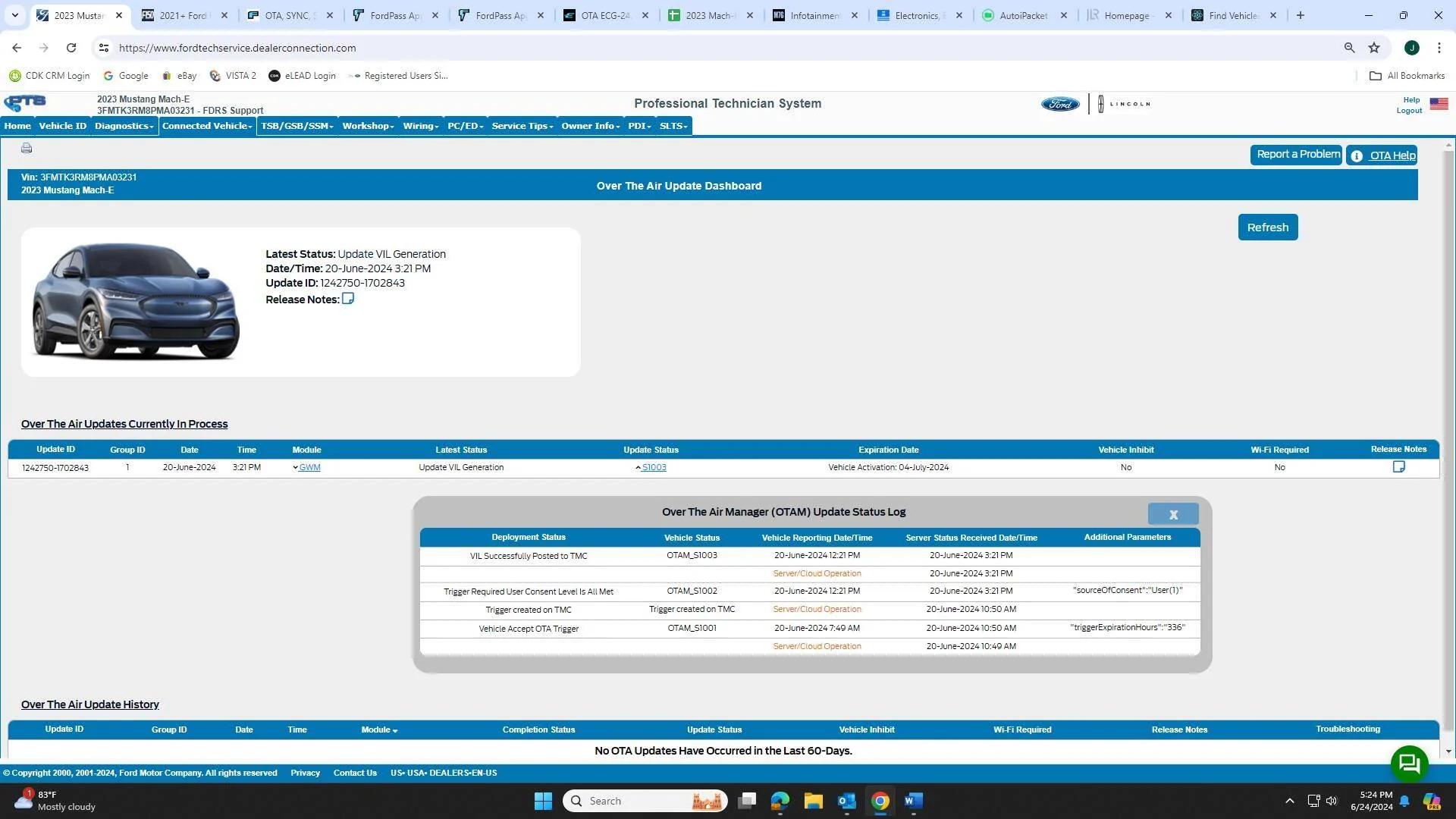

I got this update but it says "Not Completed" in the cars software updates section.
Took the car to dealer two weeks ago and they did a bunch of softwartes. However, car still has the old icons instead of new ones.
The update seems to be hanging on a part of the process and not moving. Not sure why. The interrogator is not posting the log for verification to start the file download process. It is not the first time I see this happen, but I don't know what causes it or how to get it to proceed.
