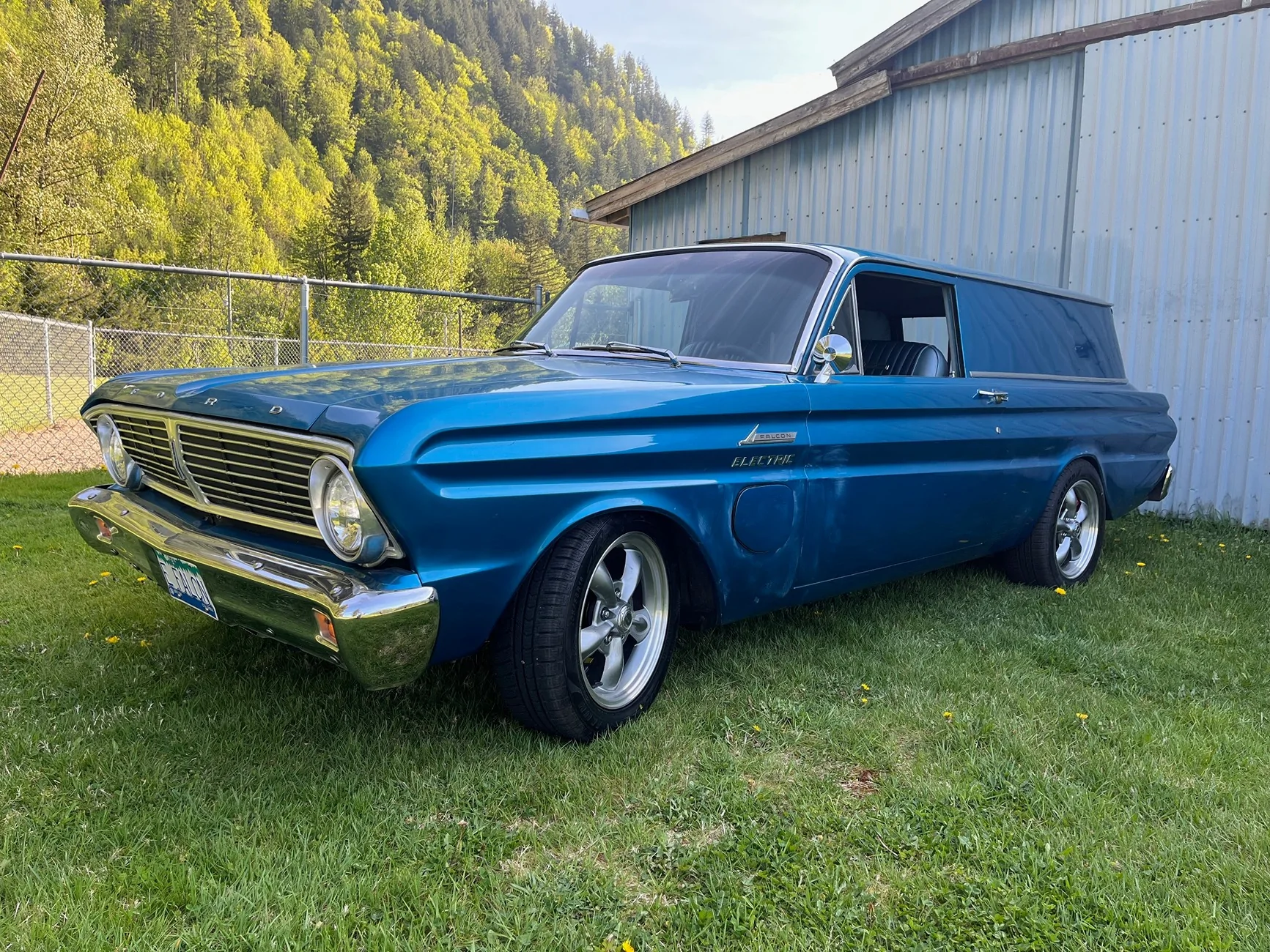

In addition to the drive train, what other systems/modules did you port into the Falcon? It is likely that some OTAs are trying to update modules you do not have installed.
Have any photos of your car?

The car is mostly completed. I have been driving it for over a year and a half. I suppose I should just "turf" the original battery. I have refitted the RCM and am in the process of finishing the complete IMPA system.
Ford Mustang Mach-E OTA just will not function Falcon Just finished
