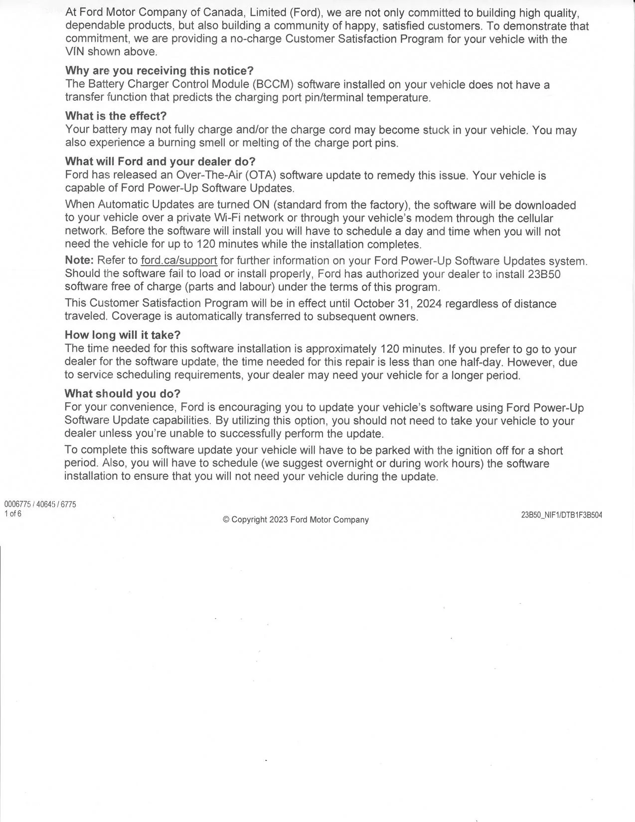

I received a recall notice from Ford about my Battery Charger Control Module not having a transfer function that predicts the charging port pin/terminal temperature.
The notice says that my charge cord may become stuck to my vehicle as a result of this issue or the car may not charge.
It then says that there is an OTA software update to remedy this issue. It goes on to tell you how to set up OTA update schedules so that you can receive this update (and that it will take 120 minutes to do) but it does not give any information on how you can tell if/when this update is complete. I did a quick search on here and no one has talked about it.
The recall notice does say that I can take it to my dealer but then I have to leave it there for at least 1/2 a day (and that is their estimate, not the dealer's). But why would I do that if I'm getting the OTA update soon or might have already received it????
Anyone familiar with this update?

I just got this melting charge port recall. I imagine the software fix is to throttle and/or stop charging sessions. The charging port on my car did melt once already and I had it replaced under warranty.

I also got this recall.
Dropped my car off and they are doing a door module recall too.
Update is supposed to take over 8 hours according to my service tech.
Just wondering Is this why my first mobile charger went, and having the select trim and what appears to be the slowest charge rate. Will this increase my time at a fast charger too.
Sucks when your pay by the minute vs Kw.
