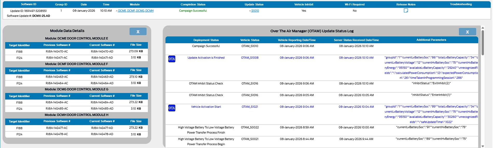

Got your message. Details are below. All 4 door modules were updated to the AD strategy. Install took 6 minutes with the vehicle in inhibit mode.
@elmedico27 So you can copy/paste to github:
Group ID 1 - Priority Update – Vehicle Doors
Side Door Operation
  • This software update contains the following key changes:
  • Prevents a potential future issue that may result in the side doors being unable to unlock when commanded from the exterior of the vehicle.
  • In some instances after this update, a "Service vehicle soon" wrench icon may appear in your instrument cluster and will remain visible until you dismiss it by pressing the "OK" button on your steering wheel, or it will clear automatically with the next ignition cycle. You may also receive a FordPass notification indicating service is needed on the vehicle, which you can disregard. Please be assured this is a visual notification only and does not indicate any functional impact on your vehicle.
To view your past software updates, or if you've had multiple updates completed recently, visit: http://ford.com/support/software-update-release-notes-history DCMX-25.AD
