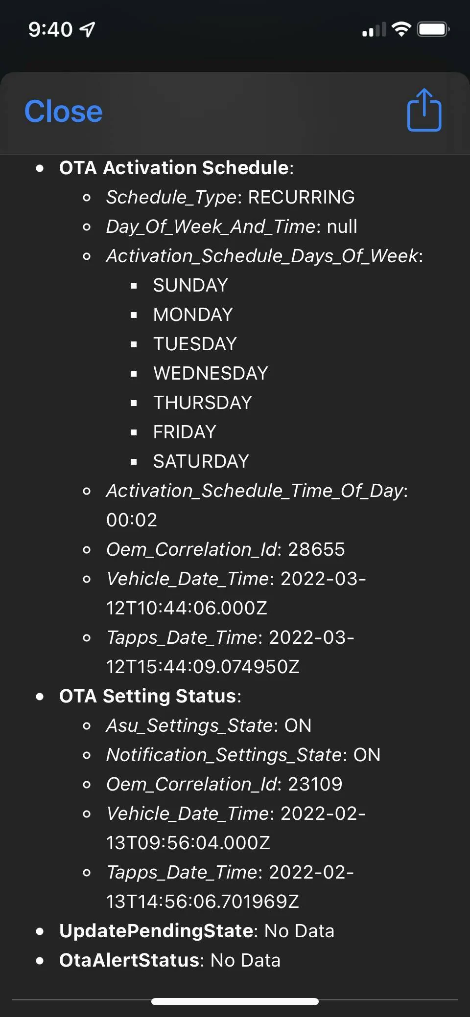

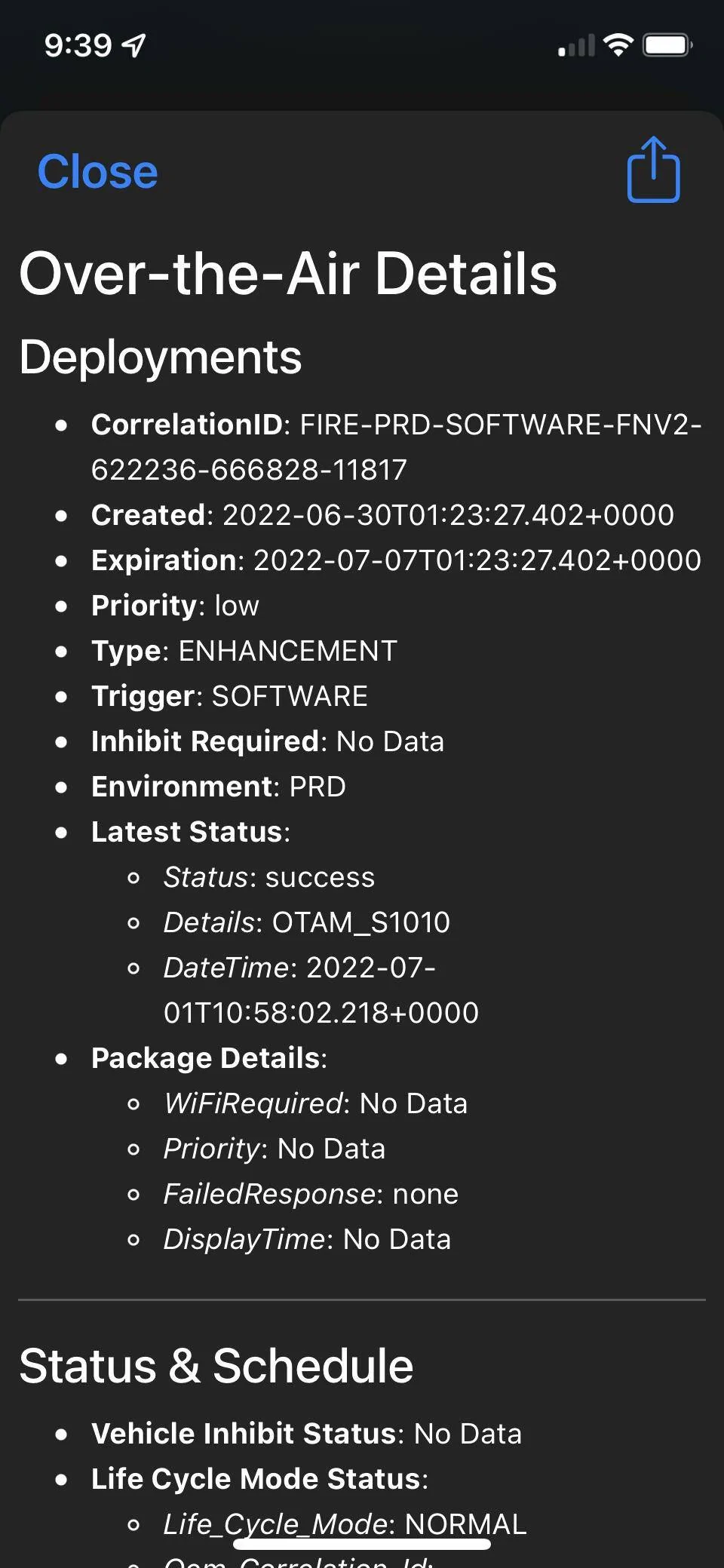

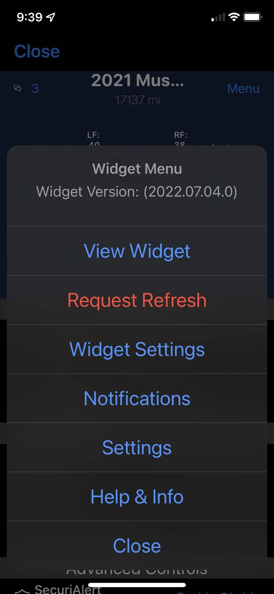

The Widget update this morning now runs correctly and shows the same phantom update:
Ford Mustang Mach-E Phantom OTA? DCC0893D-9165-49C2-ADE7-C5AC27C99D8A
Ford Mustang Mach-E Phantom OTA? 971A10C5-244B-44E5-9CDF-733E13218B1B
Ford Mustang Mach-E Phantom OTA? 705B966A-009E-4533-A3BB-E4722ED0CCA8
