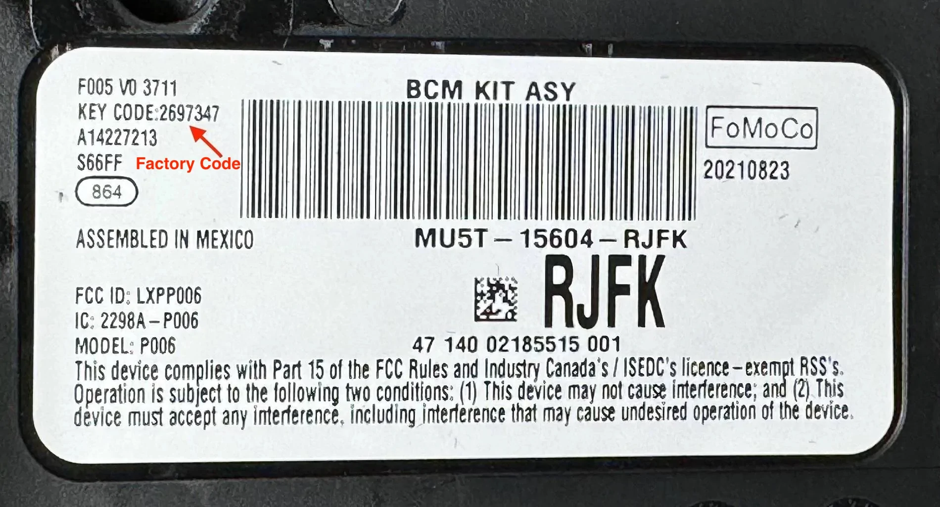

Yay, the key fob(s) wworked! I got a 5 digit number from the drivers display.
