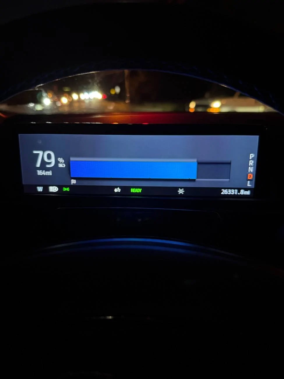

Hi all... just chiming in on this thread to say we have experienced this multiple times over the last couple months. If it happens again I think we'll start "reporting" it somehow...
Mrs Chivus
Jul 28, 2021
60
27
Richmond, VA
2021 Ford Mustang Mach-E
This same thing just happened to me! Last Friday I was taking my husband in for surgery. Granted, we were driving MUCH earlier than either my car or me is usually even awake. But I was awake enough to notice that I had no speedometer! I was thankful that I did not have to drive on the highway. And I've had no updates to my 2021 Mach-E since June 2024.

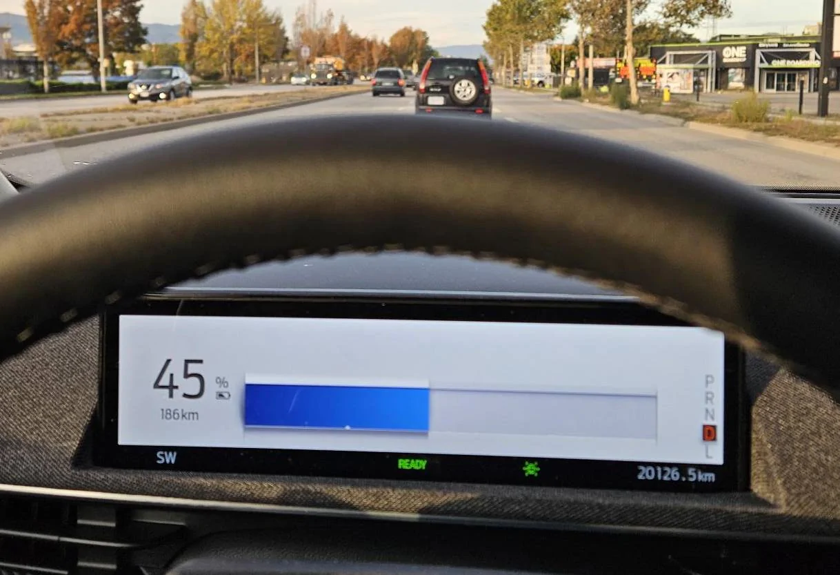

This had been going on from about the 3rd month I had my 2023 Premium AWD X. Several trips to two dealerships and no change. Finally they changed my entire charge port. They said that it was miscommunicating with the main computer or it had been assimilated by The Borg or something. Anyway, hasn't happened since.

That usually means you weren't stepping on the brake (or hard enough) when you turned it on and it is in accessory mode.
TheLongRanger
Mar 6, 2024
46
Victoria BC
2023 Mach-E Premium AWD
This happened about 20 times in about 8 months and then never again after charge port. Surprisingly my feet still hit the brake pedal. :crackup:
