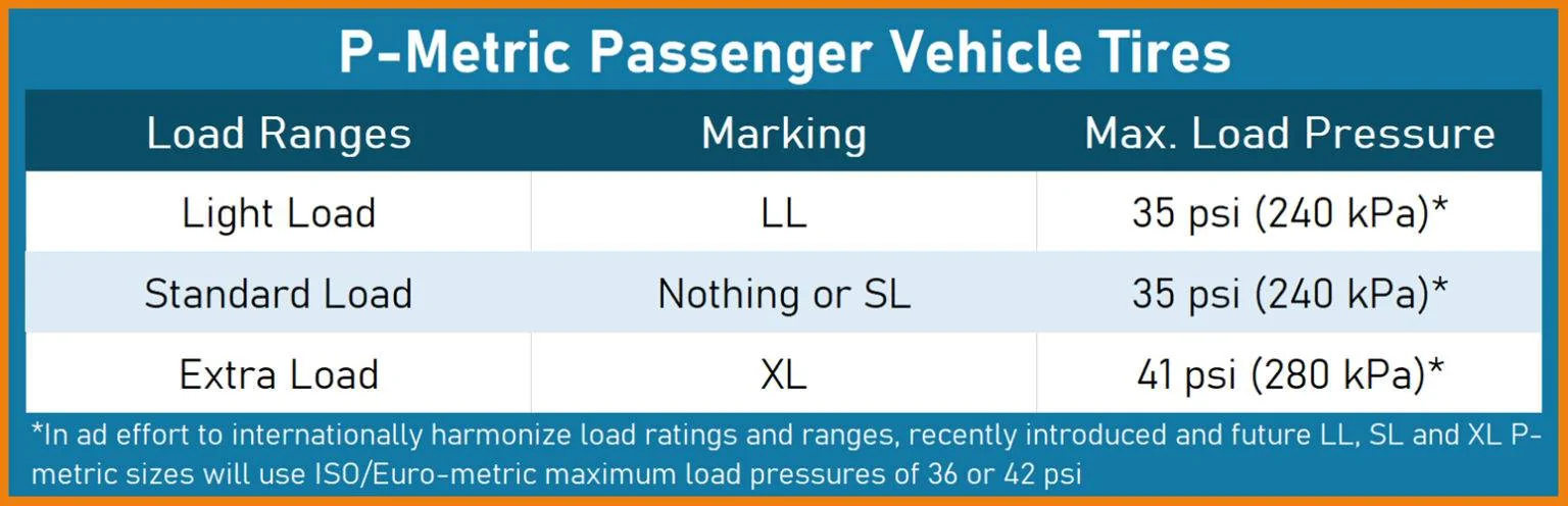

I would not use that size on a Mach E they won't support how much the Mach E weighs. It's possible they will overheat and blow out. This is even more likely in winter tires because the compound is softer.
The factory MME CR1 tire is a 225/60/18 104 XL It supports 1874lbs @39psi per tire so 7496lbs total
A 245/45/18 100XL supports 1664lbs @ 39psi per tire so a total of 6656lbs
If your tires are a 100 XL they can be safely run at 42psi and will support 1764lbs but still not enough for the MME
A 245/45/18 96 SL supports 1564lbs @ 39psi per tire so a total of 6256lbs
tm-blog-load-range-and-ply-rating-image-02-Load-Range-Chart-Passenger-1536x496-3223234069.jpg
Yes I understand what you are saying. Dealer put 100XL on, I'm not saying it's right. I appreciate the feedback.
